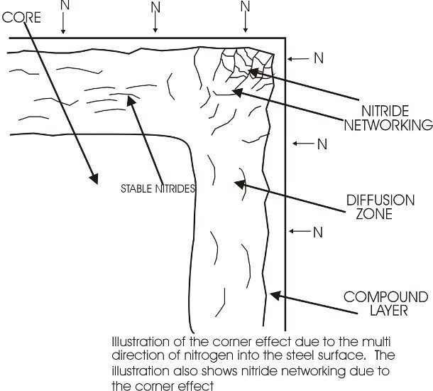

  • Nitride networks
Severe Nitride Networks

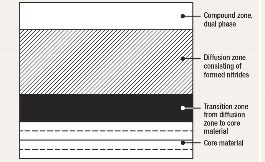

The final metallurgy (As seen in the Illustration below and by the gaseous process methods or salt bath methods) will be formed as seen in the lower illustration) comprise of the following results in the order of observation (microscopically)

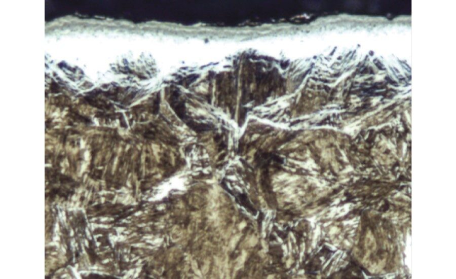

  • Compound layer ( also known as the white layer), because the immediate surface etches out white with a cross sectional examination of the formed case) The compound layer comprises of two phases known as Gamma Prime (ỳ) and Epsilon nitride (έ) The compound zone formation can be  controlled  by adjustment of the process gas flows(or salt bath chemistry)
  • Diffusion zone. This is where the nitrogen has reacted with the alloying elements to form stable nitrides with the appropriate alloying elements.
  • The transition zone. (this is the area from the diffusion zone to the core material)
  • This is the original core metallurgy of the steel being nitrided.

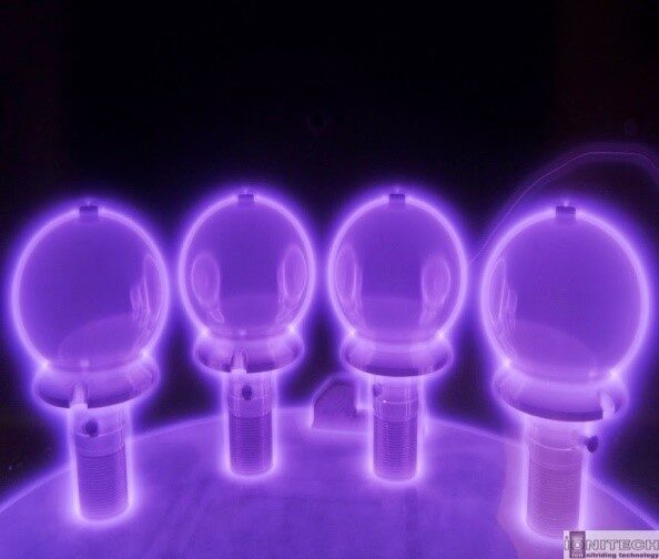

Ball Studs under Pulsed Plasma Assisted Nitriding Conditions
The thermal process requirement can be accomplished by Continuous DC generated Plasma, or be a combination of variable pulsed plasma, in conjunction with an electrical external heat source
Plasma nitriding has the distinct advantage of being able to control the ratio of nitrogen to hydrogen in order to control the resulting surface metallurgy of the nitriding process. The formed compound zone can be constructed of:

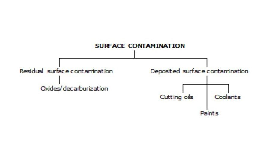

It is a mandatory requirement that the surface is free from surface contamination such as is seen below
  Illustration of possible surface contaminations
