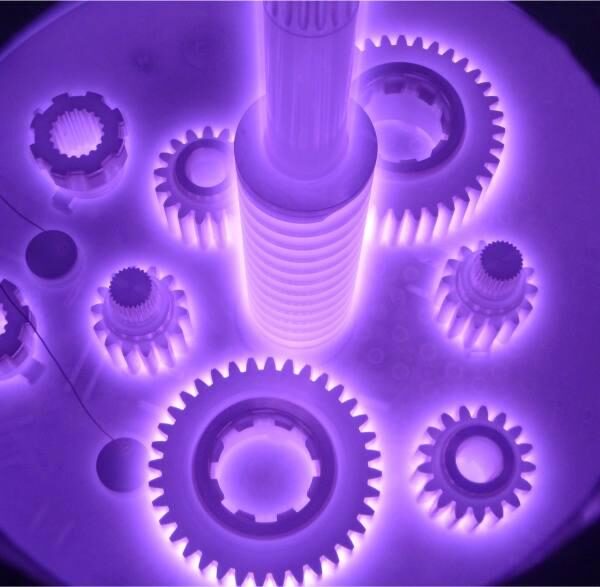

The process of nitriding on the other hand can be accomplished by any of the following nitride process methods;
  • Gas nitriding
  • Salt bath nitriding
  • Low Pressure nitriding
  • Plasma nitriding
These processes offer to the engineer, the ability to pre-treat the steel in order to develop the required core hardness and tensile strength. The appropriate core hardness is necessary to support the formed metallurgical case when the gear is nitrided. During the nitride process (and provided that the nitride process temperature is approximately 50° F below the steels core tempering temperature) the core hardness is not affected. There is absolutely no opportunity for grain boundary oxidation during the nitride procedure, nor is there any opportunity for retained austenite conditions, simply because the nitride process temperature is well below any transformation temperatures
