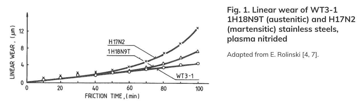

Comparison of the tribological performance of nitrided austenitic and martensitic SS with nitrided titanium alloy is very important, when alternatively, both materials could be used. Linear wear of plasma-nitrided WT3-1 titanium alloy and two plasma-nitrided stainless steels is shown in Fig. 1.
The linear wear becomes accelerated after approximately 50 min for the H17N2 martensitic stainless steel and after approximately 70 min for the 1H18N9T austenitic stainless steel. The wear of the titanium alloy shows a linear evolution during the whole duration of the test, its value being lower than those of both steels.

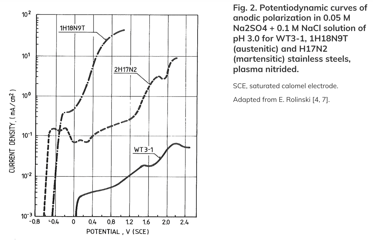

Anodic polarization curves of both steels and titanium alloy are shown in Fig. 2. These curves indicate a markedly higher corrosion resistance of the nitrided titanium alloy relative to that of nitrided steels. It should be noted that the corrosion resistance of stainless steels nitrided at higher temperatures to produce a thick layer diminishes after nitriding [1,2] while titanium alloys do not lose their anticorrosion properties after this treatment.

It could be noticed that despite preferential treatment of stainless steel at low temperatures, its corrosion resistance is still much lower than that of nitrided titanium alloy. The structure of the nitrided layer in titanium and its alloys always contains TiN nitride at the surface in the first subzone of the layer [4]. Therefore, nitrided titanium products have a very attractive gold color.
