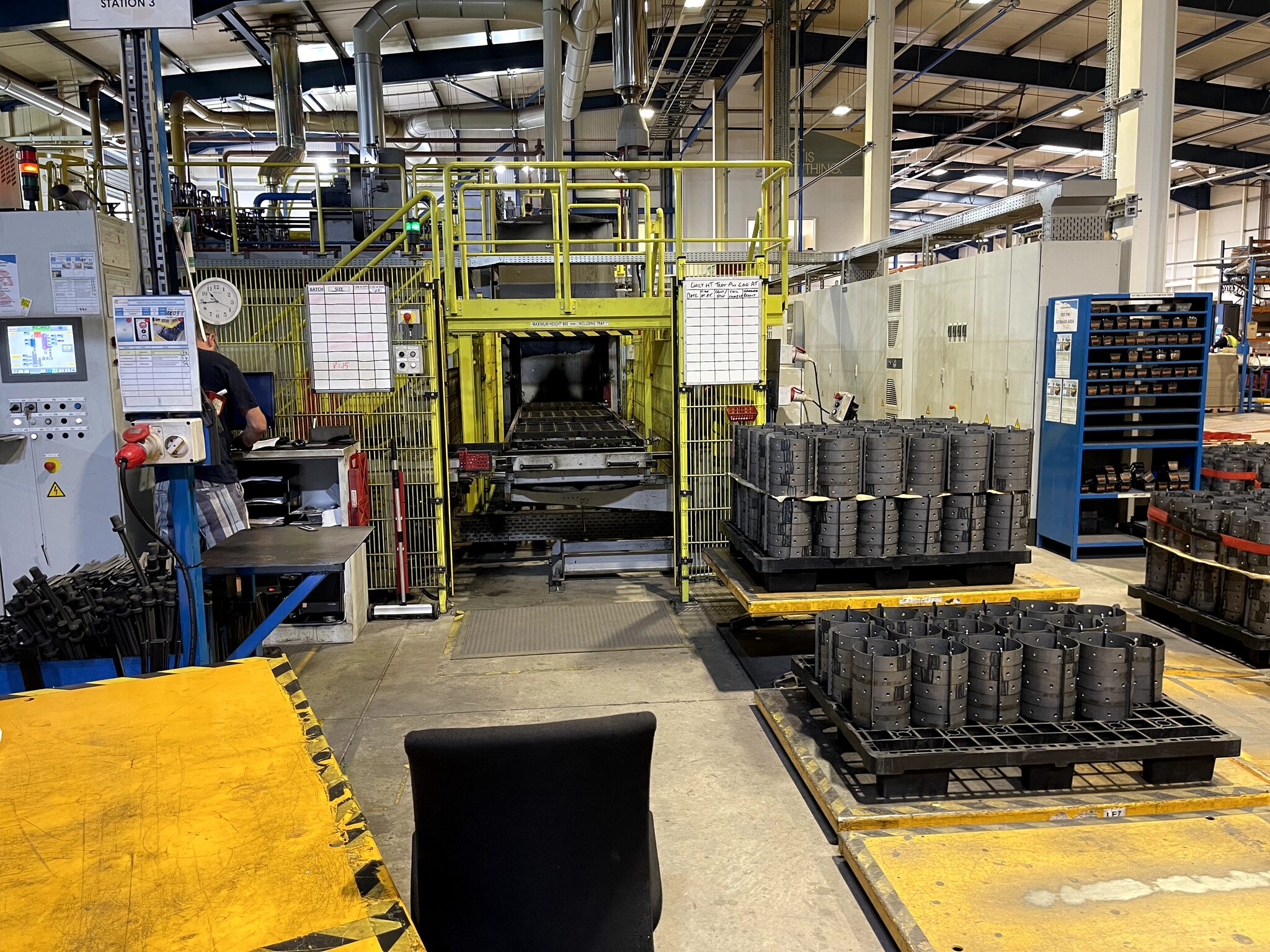

This location has always been a firm believer in keeping the entire manufacturing process in house and this includes heat treatment. In approximately 2014 the decision was made to update the entire heat treatment department and the end result was an Ipsen 2 row gas fired “pusher” style furnace, using endothermic atmosphere provided by a single retort Ipsen generator.
In overall concept this would be considered a fairly typical “U” shaped pusher design with loading and unloading in the same area, high heat, oil quench, wash, temper and a feature we always like to see-an automated “tray flipper” to provide longer life to the cast base trays. The entire system is controlled by an up to date PLC system with datalogging, with atmosphere controlled by oxygen probes.
What is rather unusual though is the cleanliness of the entire operation, not a breath of smoke or a hint of quench oil to be found in the entire department. Originally this was a family run, employee owned company and while this is no longer the case the family “feeling” and pride lives on.

While we have not personally seen the location in Oklahoma City, USA our understanding is that it is largely a mirror image of the UK facility although the furnace was provided by AFC-Holcroft, a US manufacturer. These photos will give you a very clear view of the entire facility. Our thanks go out to the entire Centek Group who were so incredibly hospitable during our visit.”
