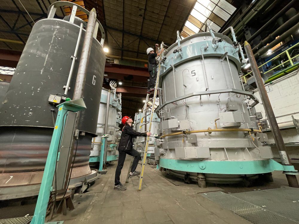

thyssenkrupp Rasselstein GmbH is a subsidiary of thyssenkrupp Steel Europe AG and as the only German supplier, they provide the largest production site worldwide for packaging steels. There are several continuous-type and batch-annealing plants in use for production in Andernach/Rhineland-Palatinate, and two of each were modified during this project. They are heated with more than 1,600 burner systems of different type and by different manufacturers, over 500 being NOXMAT burners.
The changing market in terms of natural gas supply required thyssenkrupp Rasselstein to make comprehensive changes to all gas burner systems in production. thyssenkrupp Rasselstein commissioned AICHELIN Service GmbH and their affiliate company NOXMAT GmbH with this complex and time-sensitive task, thanks to their extensive expertise in this area. The two companies had already proven their high service availability as well as their cooperative partnership during a previous project regarding a security update for the batch annealing plants.
The schedule was challenging: The conversion of the burner systems had to be completed within only two weeks, and during active operation of the plants. After that, another week was scheduled for production support and optimization. A constant working temperature had to be guaranteed during the conversion and adjustment of the burners during running operation, in order to provide constant and high product quality. Up to five mixed teams with a total of 10 employees from AICHELIN Service and NOXMAT were on site for this project, supported by several thyssenkrupp Rasselstein employees to constantly monitor the temperature of the control station. To coordinate amongst each other across several levels of plants, and to guarantee smooth communication across the teams, the AICHELIN Service and NOXMAT service managers provided for a radio connection to the thyssenkrupp Rasselstein control station.
