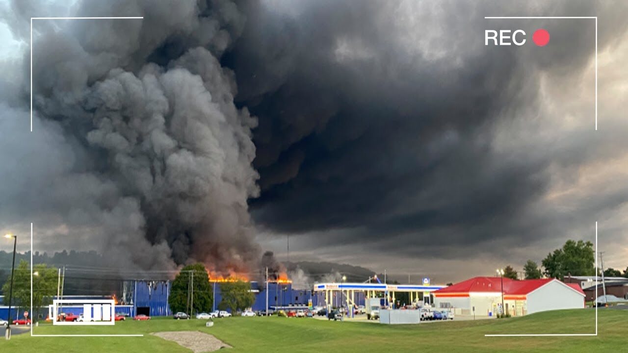

Remember the large fire at Colfor Manufacturing which we mentioned last week? Well it had nothing to do with the in house heat treating department as you can see in the press release; “The fire that ripped through the Colfor Manufacturing plant earlier this week did “multi-millions” of dollars worth of damage, Great Trails Fire District Chief Ralph Castellucci said Thursday. “This was the biggest fire in Carroll County,” he said. “I’m quite sure it’s the biggest dollar-value loss in the county and likely in surrounding counties.” No one was hurt and, he said, “We are blessed by that.”The fire began about 5 a.m. Tuesday. The chief cited a malfunctioning press as the cause. “They had been operating as normal. A press malfunctioned, spraying hydraulic oil down onto the hot parts which immediately caught fire and flashed,” Castellucci said.”

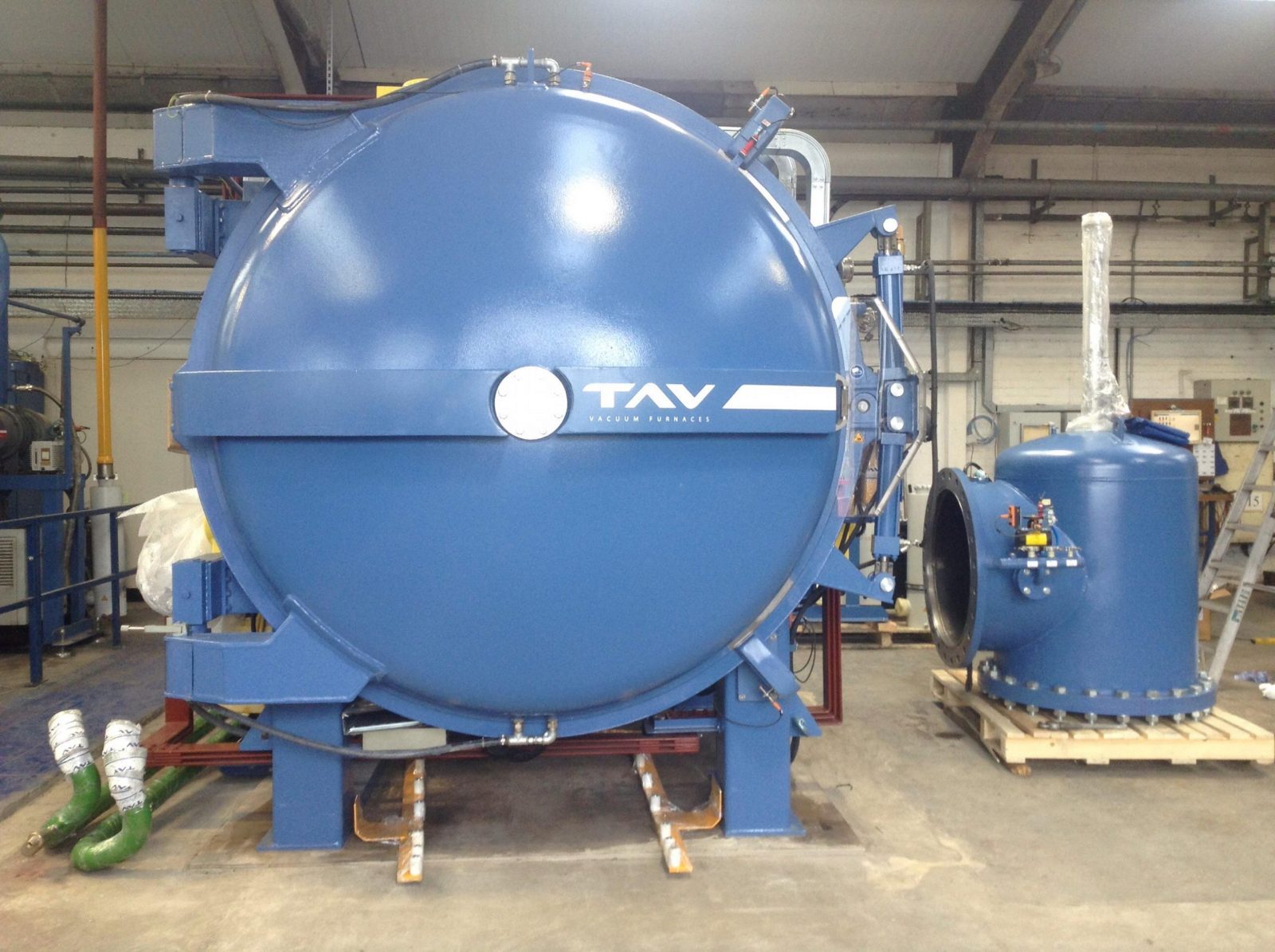

Braddock Metallurgical has a new Territory Manager in the US Northeast region as you can see in this press release. Braddock is one of the largest commercials in North America and is extremely strong in the Southeast. “We are proud to announce the addition of a new Territory Manager for the Northeast region. Mike Sorrentino has many years of experience in sales and marketing of industrial products. He has worked with engineers, contractors, distributors, and end users to solve problems and build relationships. We are excited to have Mike join our growing team. He will be an integral part in our ongoing pursuit to provide the best quality and service for our customers. In the UK Jamie Payton recently became the Works Manager at the Hauck Heat Treatment facility in Telford, England, previously he was Technical and Quality Manager with the company. Hauck is on both our list of the largest commercial heat treaters in Europe and also in the USA. Both lists can be found at https://themonty.com/articles-interviews/ Below you will find a picture of Jamie and a picture of a new TAV vacuum furnace being installed at Hauck in Letchworth, UK in 2018.
