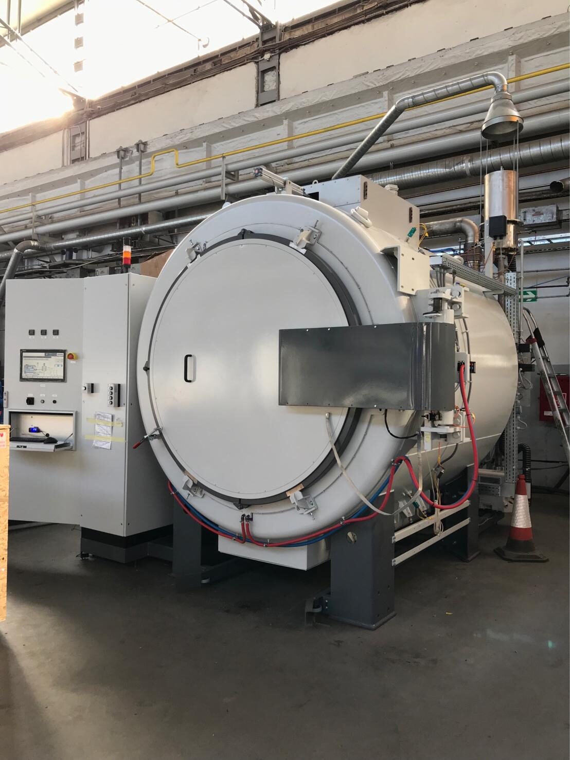

We mentioned previously that Poclain Hydraulics a manufacturer of hydrostatic transmissions and in house heat treater in Wisconsin, USA is planning on discontinuing carburizing at this location in favor of other technologies. This means their 3 cell ECM vacuum carburizing system will be available sometime in the future, however it will be a little way down the road as the company like many these days will be closed for the next number of weeks.

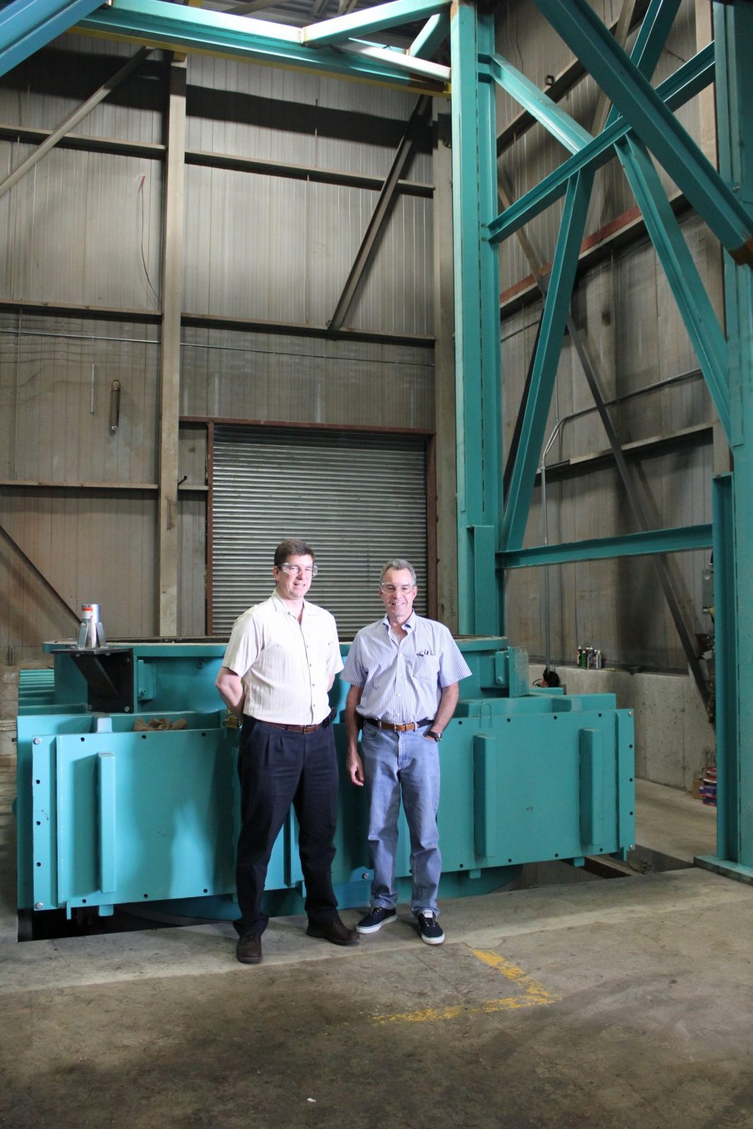

While we are on the topic of the largest vertical vacuum oil quenching furnace in North America we had always thought of Vac Aero owning this title. A few years back the company built a giant with working dimensions of roughly 30’ high (the photo below shows the furnace under construction, to give you an idea about perspective the President of the company Mr. Scott Rush is well over 6’ tall). So if anybody ever asks you where the largest vertical, oil quenching vacuum furnace is you now have the answer.

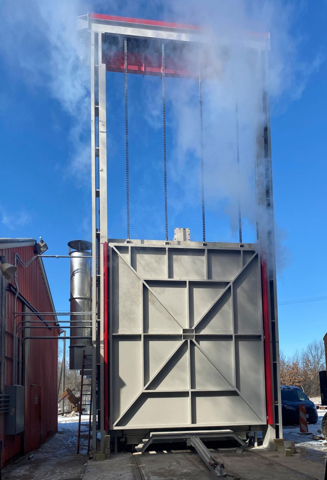

It’s a changed world and currently not as much fun as it used to be but companies are still buying and installing new furnaces so all is not lost. For instance Rubig in Austria is saying that their rep in the USA, Mr. John Young just landed an order for a new Rubig Plasma Nitrder and that this was the quickest order the company has landed in North America. We will be interested in hearing more details. Unitherm Furnace recently commissioned a large 40ft car bottom furnace for a MidWest forging company. Unitherm, based in Missouri, USA is part of a very small, select group by the way in that they build furnaces and also do commercial heat treating through another division, Missouri, Heat Treat. We can only think of approximately 6 companies in North America which do both.

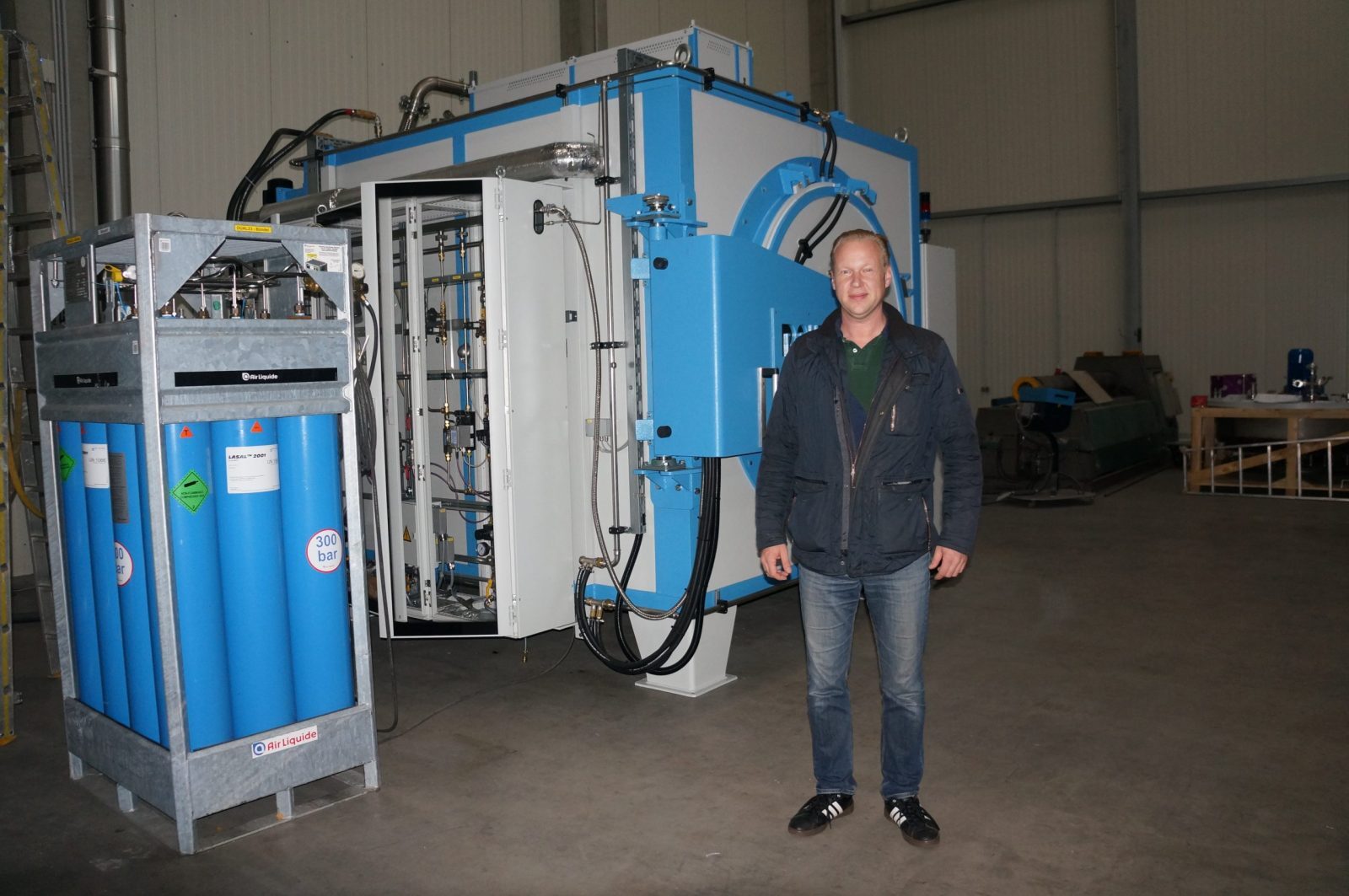

SECO/WARWICK is another company which has also been busy installing equipment. Recently the company installed 2 systems in the US including this large unit designed for FNC using Endothermic gas as the carbon source.
