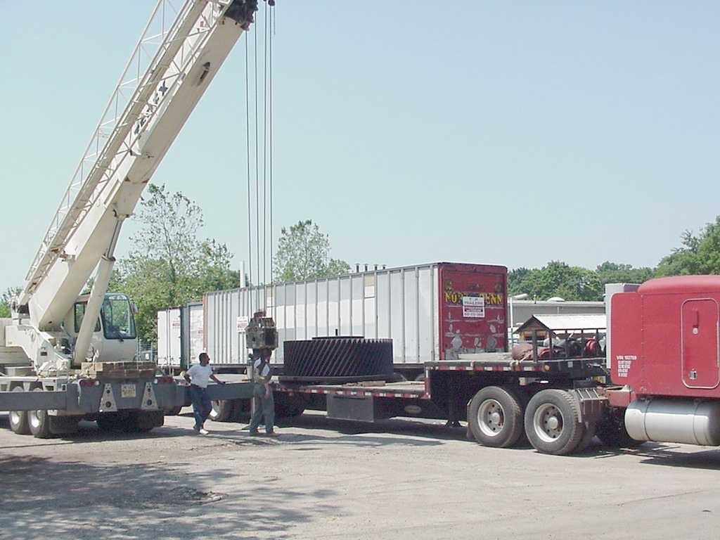

As an example Mark sent us these photos of what is a relatively typical job for the company, but a very “untypical” job for most heat treaters.

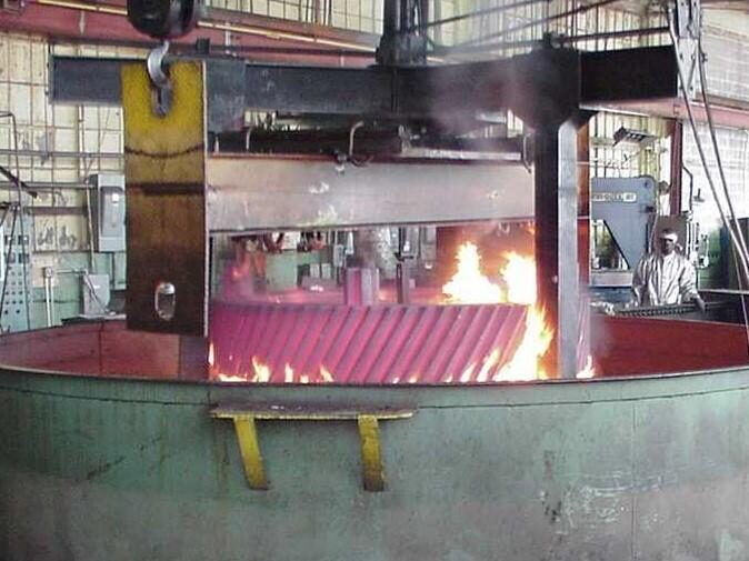

What we see in the first photo is a 35,000 pound gear with a 10’ OD and a 4’ face width arriving at Metlab for processing. This gear is being quenched from 1550F, has a 0.250” effective case depth and surface hardness will be HRC 60 after tempering. The second photo shows the gear with masking and in a fixture being quenched. While this is a very substantial part by any standard it is by no means the largest gear or shaft which the company has processed.
