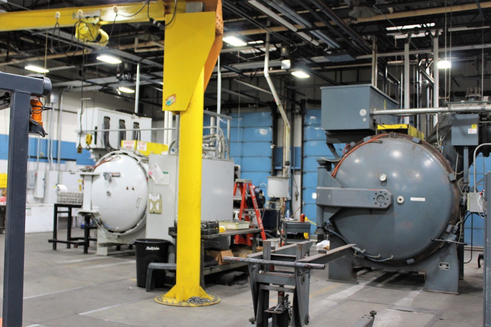

Out in Wichita, Kansas, USA we see that Metal Finishing Company is proud to announce that we have been approved by Northrup Grumman for Heat Treatment to AMS 2759/3. In addition to this photo we have this summary of the company from 2016;

Our Steel Heat Treat facility is currently capable of carburizing, normalizing, annealing (full anneal and sub critical), stress relieving, tempering, aging, precipitation hardening, and carbon restoration in atmosphere or vacuum.  In addition we can perform specialized cryogenic treatments in the temperature ranges of -100F to -240F.Â
We currently have the capability to process materials such as: mild steels in cold or hot rolled condition; medium to low carbon steels with medium to high alloy content; austenitic, martensitic, and PH stainless steels; Inconnels, titaniums, and tool steels. Equipment currently in service includes (2) 2 bar vacuum furnaces, (2 ) integral batch furnaces, a compact furnace for small lots, and (7) tempers of various sizes. Future growth is already underway with the recent acquisition of an additional vacuum furnace and ongoing retrofit of another integral batch furnace. In addition we provide full laboratory testing services including hardness testing, micro-hardness and case depth analysis, decarburization, and tensile pull capabilities. We anticipate future expansion into the areas of low temperature nitriding, brazing, and induction capabilities. "
