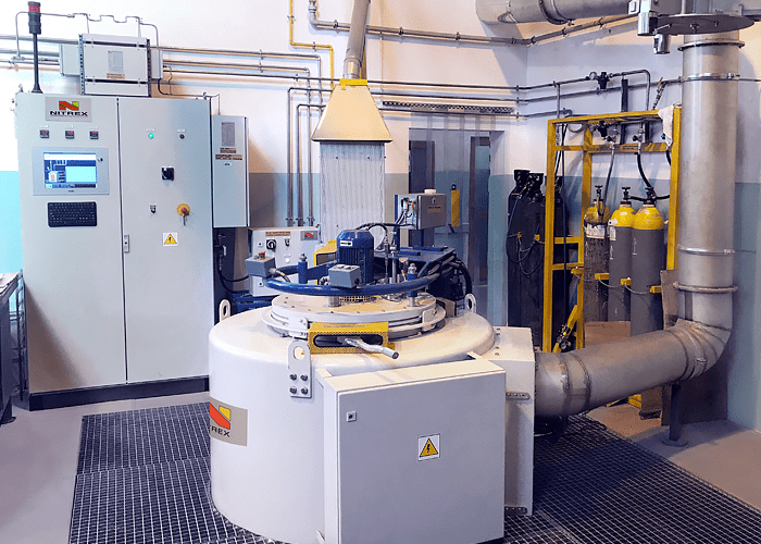

“Metal Expert Sp. z o.o. started production last year with the new Nitrex system for nitriding stainless steel turbine components. The addition of the Nitrex system to the company’s heat treating operations allows Metal Expert to improve process reliability and meet exacting standards for complex turbine applications that require dimensional control and tight tolerances.
Located in Elblag, a city in northern Poland, Metal Expert has over the past 15 years steadily increased its range of gas and steam turbine components developed for mechanical and electrical power generation. To keep up with their production expectations, Metal Expert chose the NX pit-type 615 furnace with a capacity to nitride a 2200 lb. (1000 kg) load. The turnkey system also features the Nitreg®-S technology with proven, tested recipes for nitriding acid-resistant stainless steels and other types of stainless steels with incredibly precise, repeatable results. Complex components such as blades, shafts, steering discs, stems, and other machined components are nitrided to exact customer specifications for strength, wear and corrosion, as well as dimensional stability within acceptable limits. Since these critical components operate under high temperature and high stress conditions in gas and steam turbines, Nitreg®-S technology improves their structural durability and reliability, prolonging the service life of these components. Moreover, given the relatively high cost of materials used in the manufacturing of turbine parts and the long processing times, the Nitreg®-S process is fully optimized, allowing for more predictable properties and avoiding unnecessary scrap and rework.
