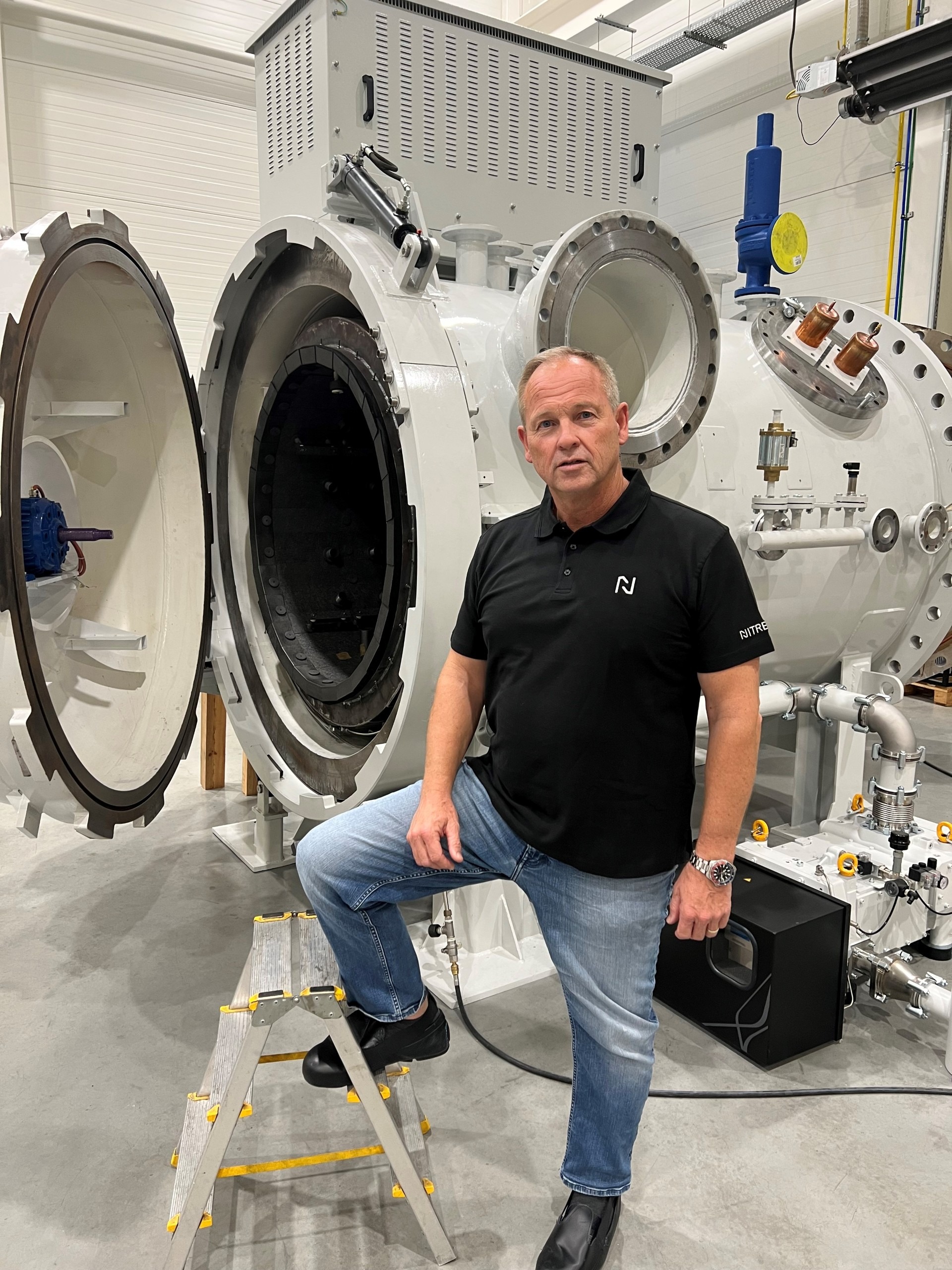

Gord, you’ve got a good eye. I noticed the same and asked our engineers about it. Turns out, our furnaces are built with slightly different dimensions—for good reasons. We use thicker materials and wider channel spacing for the water-cooling shell, slightly larger plenums, and we build in extra tolerance space in the loading. All that adds up to nearly 12 inches in additional diameter. The benefit is longer life, better cooling, easier TUS surveys, and fewer maintenance issues like water blockage.
Of course, that also means higher manufacturing costs. So this year, we introduced a new line called “Fusion.” It leverages many features from our Aerospace-proven designs but at a more competitive price point.
