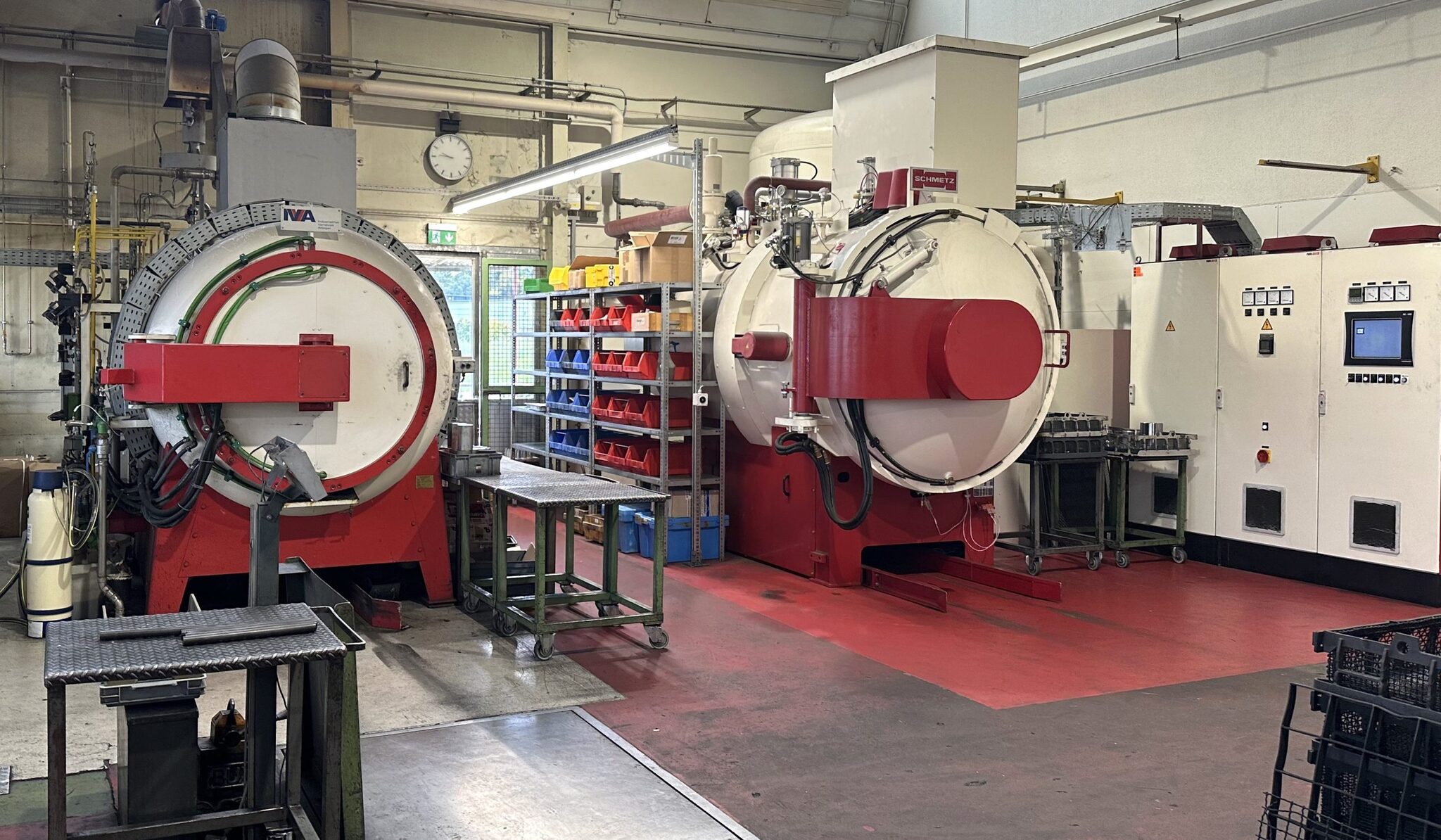

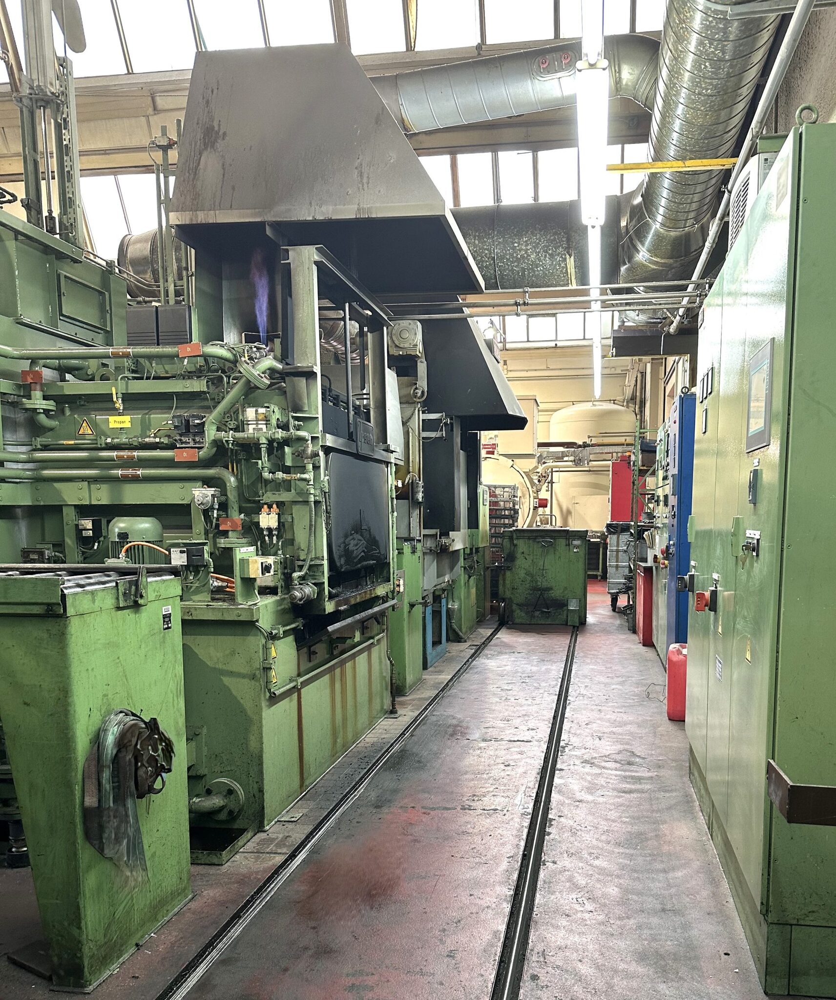

What was most interesting to us was that DUAP is part of a very small group of manufacturers who have successfully combined captive and commercial heat treating. The heat treat department which consists of a number of Ipsen Batch IQ furnaces, 2 vacuum furnaces and the new Rohde pit nitriding system is 70% commercial heat treating with 30% capacity for their own products. As we say it is unusual to see a manufacturer who is able to profitably serve the commercial heat treatment market but it would appear that DUAP has been able to.

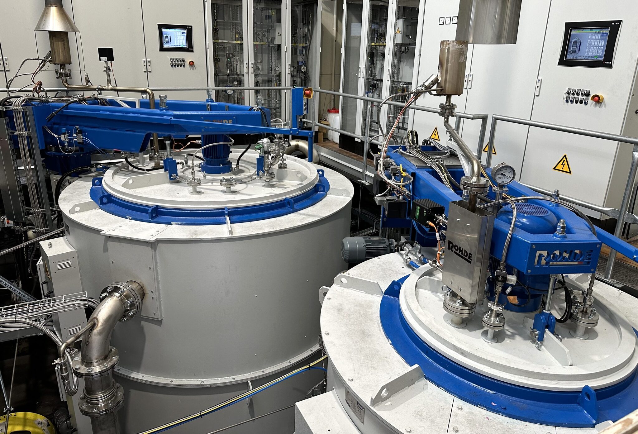

Incidentally the new pit nitriding furnace replaces a 40 year old system and the result is a 70% reduction in ammonia usage and a 40% reduction in energy costs.
"SEPTEMBER 3/2024; Injection Nozzle Manufacturer adds Nitriding Furnaces; DUAP AG a supplier of fuel injection nozzles in Switzerland has just added pit nitriding capacity. The company operates both as a manufacturer and as a commercial heat treater. The 2 Rohde supplied furnaces have working dimensions of 1500mm x 2000mm with a weight capacity of 3000 kg and a second unit 700mm x 1000mm with an 800 kg capacity. Operating temperature is 750C and both will capable of Nitriding, nitrocarburizing, post-oxidation, stress-relieving and annealing using nitrogen, ammonia and propane.  In addition to the new furnaces DUAP also updated their crane and washing systems. Both furnaces entered production very recently."
