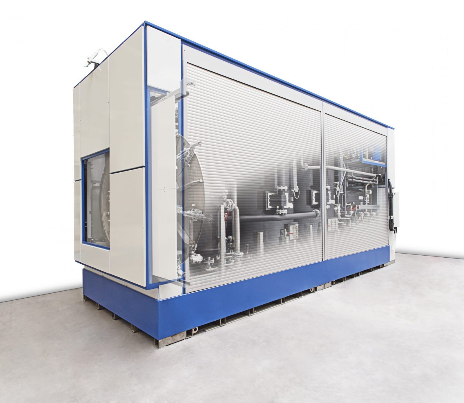

"A hybrid cleaning machine for pre-cleaning of various parts before vacuum hardening processes was delivered to MAN Energy Solutions in Augsburg, Germany. It is fully integrated into the IPSEN master control center and the batch size fits to the IPSEN TQ size. This enables fully-automatic hardening processes for maximum economic efficiency. The cleaning machine can run modified alcohol and water-based-alkaline media in the same cleaning chamber. The result is spot-free cleanliness for highest demands by removing organic like oil and grease residues with organic solvents and anorganic leftovers like salts with water. The flood-washing step is followed by vapour degreasing and drying - the whole process takes place under vacuum of course. The hybrid cleaning machine combines flexibility and sustainability with highest quality and therefore is the perfect solution especially for commercial heat treating companies."
