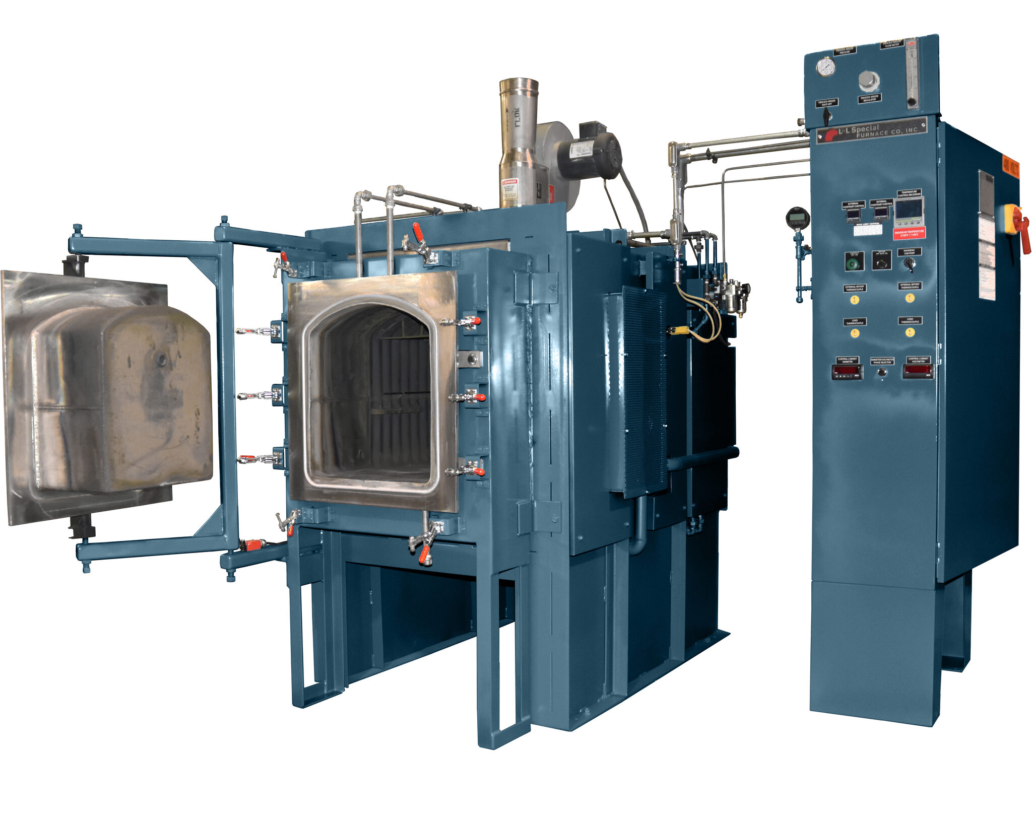

The main function of the furnace is to remove all organics and other materials used in the product prior to placing in a high fire vacuum chamber. This de-bindering process is extremely important and allows for a finished product which is a very strong light weight part.
The model XLC3648 furnace has a work zone of 23” wide by 23” high by 36” deep. The furnace has a single zone of control with a temperature gradient of ±20(F at 1100°F using four zones of temperature control with biasing to balance any temperature gradients.
The furnace is constructed of low mass insulating firebrick which allows for quicker cool down times. The furnace has a venturi cooling blower which will also aid in cooling. The furnace is controlled by a Eurotherm program control with overtemperature protection. There is also a programmable flow panel to control the nitrogen flow throughout the process.
The parts are heated to 1220(F in a retort chamber that is pressurized with nitrogen. The by-products of the outgassing part are directed by pressure and flow out the rear of the furnace. The parts are then heated in a vacuum furnace to temperatures in excess of 2300(F. The result is a super strong component which is stronger and lighter than titanium.”
