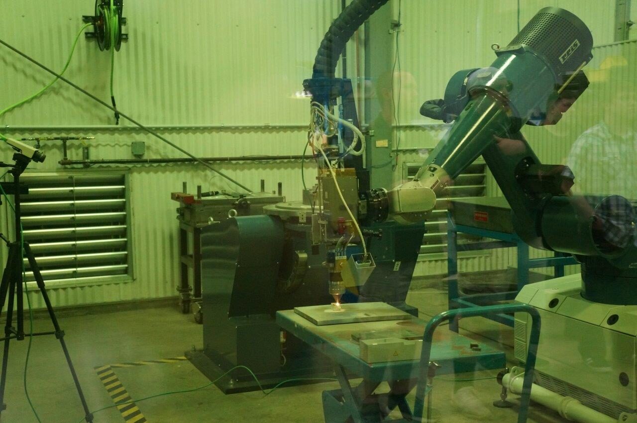

From Aravind Jonnalagadda, CTO, Co-Founder at Synergy Additive Manufacturing, LLC., we have this interesting article about laser heat treating of dies. Over the years "The Monty Heat Treat News" has run across laser heat treating just a handful of times, one of the few concrete examples we can think of is "Laser Hard" in Pennsylvania, USA a joint venture founded in 2018 by Doug Peters of Peters Heat Treating and partners (these two photos show the facility as we saw it at the grand opening, Doug is on the right). According to this article laser heat treating of dies makes a great deal of sense. However having said that two points in this article puzzle us.
