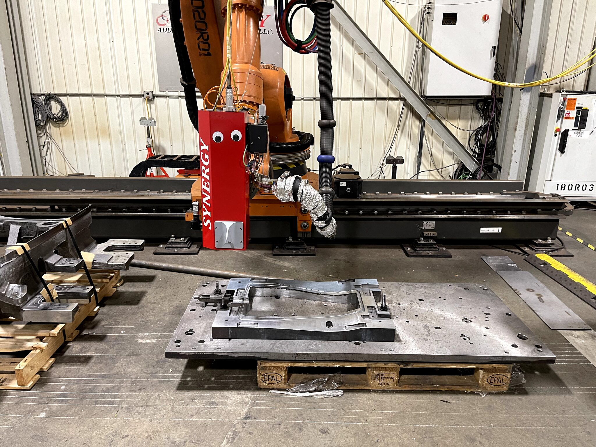

It would appear that the main advantage of laser heat treating is that it is extremely localized which translates into very little distortion. A perfect example which we witnessed are stamping dies. As most of the die does not require heat treating the laser process is able to very accurately target the areas which do require hardening leaving the rest of the die seeing little heat and consequently no distortion. While the cost is higher than typical heat treating the additional costs are more than compensated for by the fact that there is reduced machining.
We don’t anticipate laser heat treating taking over the industry any time soon but we can see that in some applications it has definite advantages and we would expect that we will run across the technology on a more regular basis going forward.  These photos show a typical system heat treating an automotive stamping die.
