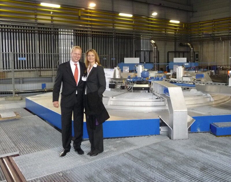

I was lucky enough a few years ago to see a very impressive example of a pit carburizing furnace which you designed and installed at a company in Bochum by the name of REESE. It is without a doubt the largest pit carburizing furnace I have ever seen. Could you tell us a bit about the project including the size of the furnace?
“This furnace was especially designed for Gerhard Reese. The retort diameter is 5,5 m (16.5’)and the depth is 5 m (15’). Due to the design of the loading table, it can handle loads of over 200,000 pounds at temperatures above 1000° C. The furnace is equipped with 24 recuperated gas burners with a heating capacity of over 1900 kW with additional electrical heating for the loading table. Nobody in the industry wanted to design that furnace. Some people even told me, I was crazy when they heard that I was building it. The furnace was delivered in 2011 and is still working successfully.”
