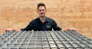

In short, we offer a large inventory of molybdenum and its alloys, in the form of mill products, custom parts and fixtures. The business has grown organically as we have served one customer after another over the years, and with my dad’s previous knowledge of the moly business specifically, we have been able to provide knowledgeable service from the start.
Chances are that all or virtually all of our readers with any involvement at all with vacuum heat treating will know what “Moly” is and why it is used. However the atmosphere guys might not be as familiar with this exotic material. Could you tell us why “moly” is used in the industry?
Gord, when I say, “I sell moly” many don’t know how to respond, for sure! It has a melting point of 4753°F, so it retains its strength at temperatures where stainless steels cannot go…as long as it is under vacuum or a clean protective atmosphere. It doesn’t mix with air when heated above a few hundred degrees. Or rather, it mixes too well.

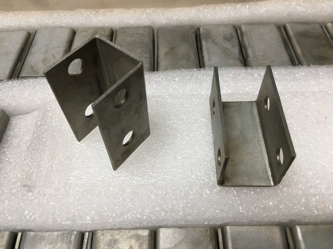

So why is it used? The strength at high temperatures leads to use in load-bearing applications. An advantage moly has over graphite is that moly is not porous—does not absorb moisture and other vacuum contaminants like graphite does. So it is used when a cleaner vacuum atmosphere is needed. And where is it used? Fixtures? Heating elements? Hot Zones?
Hearth posts and hearth bars are often moly. Heating elements too, even in furnaces where the remainder of the hot zone is graphite. All-metal hot zones are rare in comparison to graphite hot zones, but still numerous nonetheless. The heat shields, element retainers, and other hot zone parts are often moly in these furnaces.
Moly fixtures, such as single or multi-level grids, can be used to attain a higher temperature than stainless alloy grids—stainless is not often used above 2000°F, where moly grids excel. Moly like cast materials does see reduced strength at higher temperatures. As an example TZM at 3000F has 25% of the strength that it has at 2000F.
Life. All heat treaters are well aware of the fact that alloy components and fixturing have a definite life span which is usually measured in terms of 5 years or less depending upon temperature, atmosphere and a few other factors. What is an expected life span for “moly” components?
Temperature and handling affect the life of moly components. Pure moly recrystallizes with extended use at or above ~2000°F and so becomes brittle, susceptible to cracking from rough handling. TZM moly alloy resists this embrittlement and recrystallizes at or above ~2500°F, but even after recrystallizing it retains more strength (~3x) and toughness, since the small amounts of Ti and Zr reduce grain growth. Because of this, TZM is often used in load-bearing applications, such as hearths and grids. As an example, our TZM grids often last ten years when treated with care. Another alloy, lanthanated moly, is great for use in thin sheet applications, such as elements and shields. When used side by side with pure moly elements in a vacuum furnace, lanthanated elements showed no distortion after a few months whereas pure moly elements began distorting. By the way TZM and lanthanated alloys are both quite common. Typically they are 5-10% more expensive than pure moly but we usually encourage using them whenever possible to extend the life of the components.
The advantages are obvious but there is one drawback and that of course would be cost. How are users able to justify using this material?
Yes, moly can be expensive—but many find that we have very competitive pricing. With good pricing and extended component life by using the right material for the right process, moly and its alloys are often justified.
Is the use of this material increasing?
Hard to know. In our experience the demand for moly furnace components is growing.
Over the years I have seen several examples of grids and fixtures provided by “GVT”-do you design and build yourselves? Is this a large portion of your business?
We do. Moly grids and fixtures are a large and steady portion of our business. We design and build custom fixtures, often with multiple tiers to increase furnace throughput. We also provide mesh baskets to hold smaller parts, as well as moly boats for processing small parts and powders in continuous applications. Other examples are clamping fixtures for brazing, and TUS survey fixtures.
