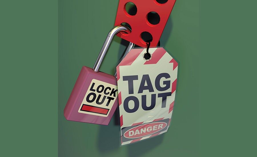

Last Thursday, October 28th we had a news item about heat treatment safety in general, with a specific example in which case ignoring safety guidelines lead directly to the death of two individuals. The article prompted a number of responses, two of which we are including today below the original note. These two deaths occurred because Lock Out Tag Out (LOTO) and Confined Space Entry Policies were not followed.

“John Hubbard, Chairman at Thermal Process Holdings; Thanks for sharing Gord. Stories like this NEED to be shared so as to potentially prevent other fatalities. Use Lock Out Tag Out (LOTO) and Confined Space Entry policies - 100% of the time. BTW: this was in Tarzana, California.”
