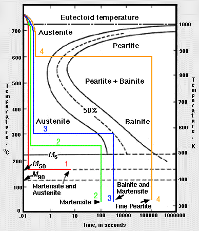

It was established that the Isothermal Transformation Diagram for M2 had been considered, it was clear that the interpretation of the diagram was misunderstood.
It was also discovered by the writer that the understanding of the time necessary for transformation to the Ms line transformation was not considered (or recognized).
The next observation was, that the company did not understand the necessity for accurate austenitizing temperature. (Believing that the higher the temperature, the more uniform the metallurgy of the hole saw would be).

Conclusion
The original program of heat treatment austenitizing temperature was too high to achieve the desired results
The second part of the program of pressure quenching was also too high. One has only to consult the TTT curve for M2, and it will be observed that the ‘nose of the cooling curve’ is far to the right of the transformation and time line at approximately 20 minutes to the Ms line.
Then the crop to length and manufacturing method tolerances were tightened up.
