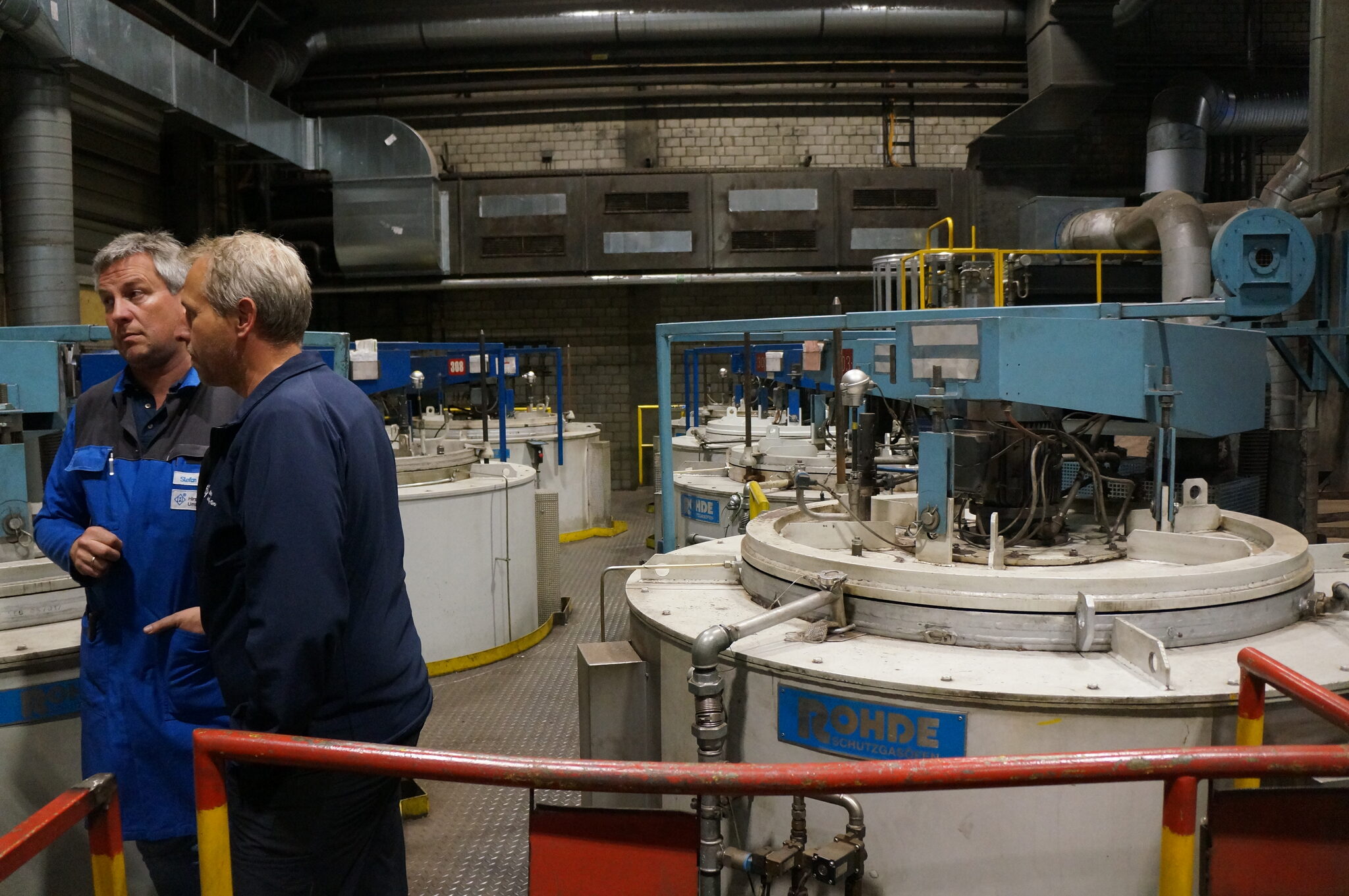

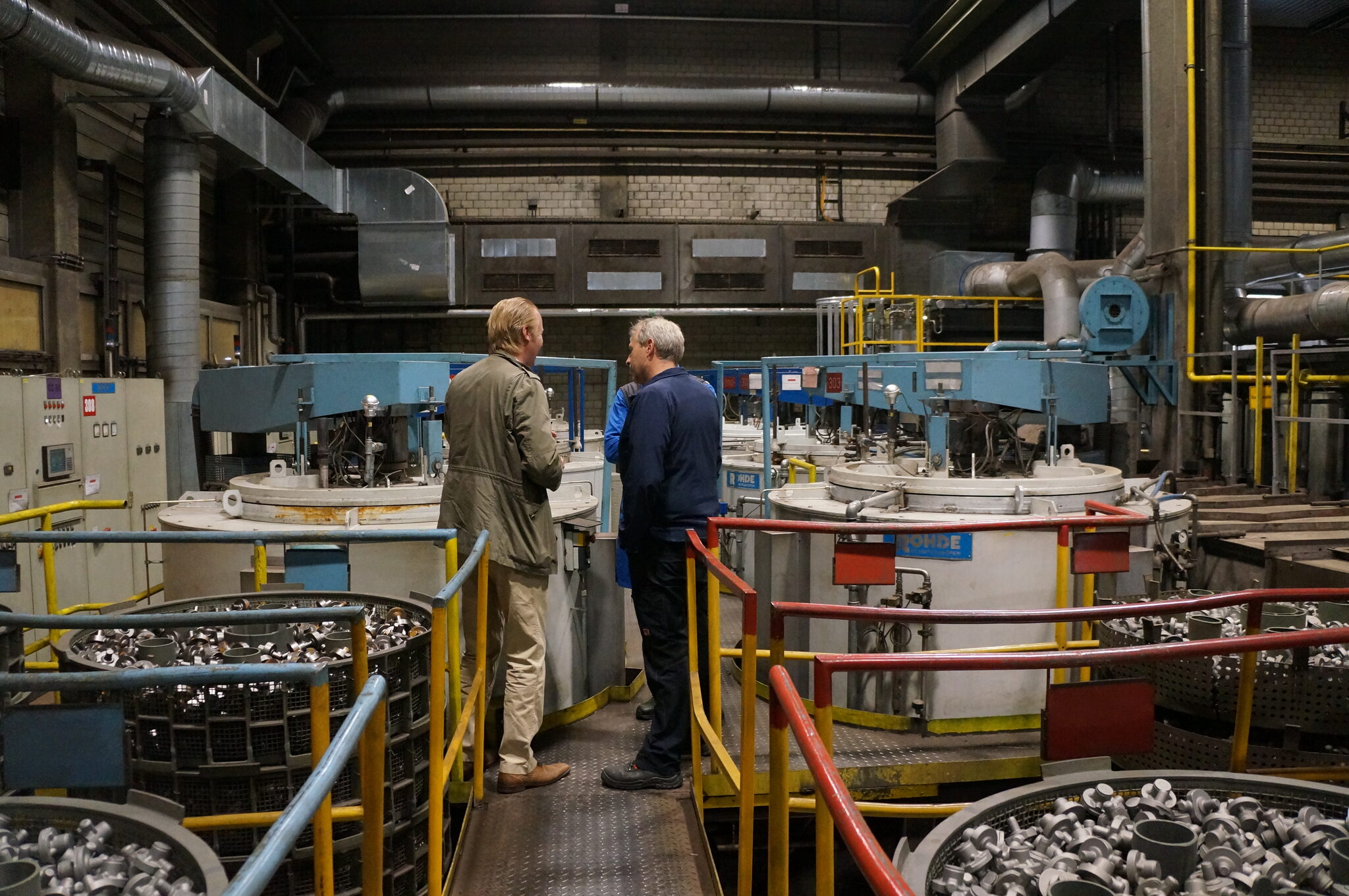

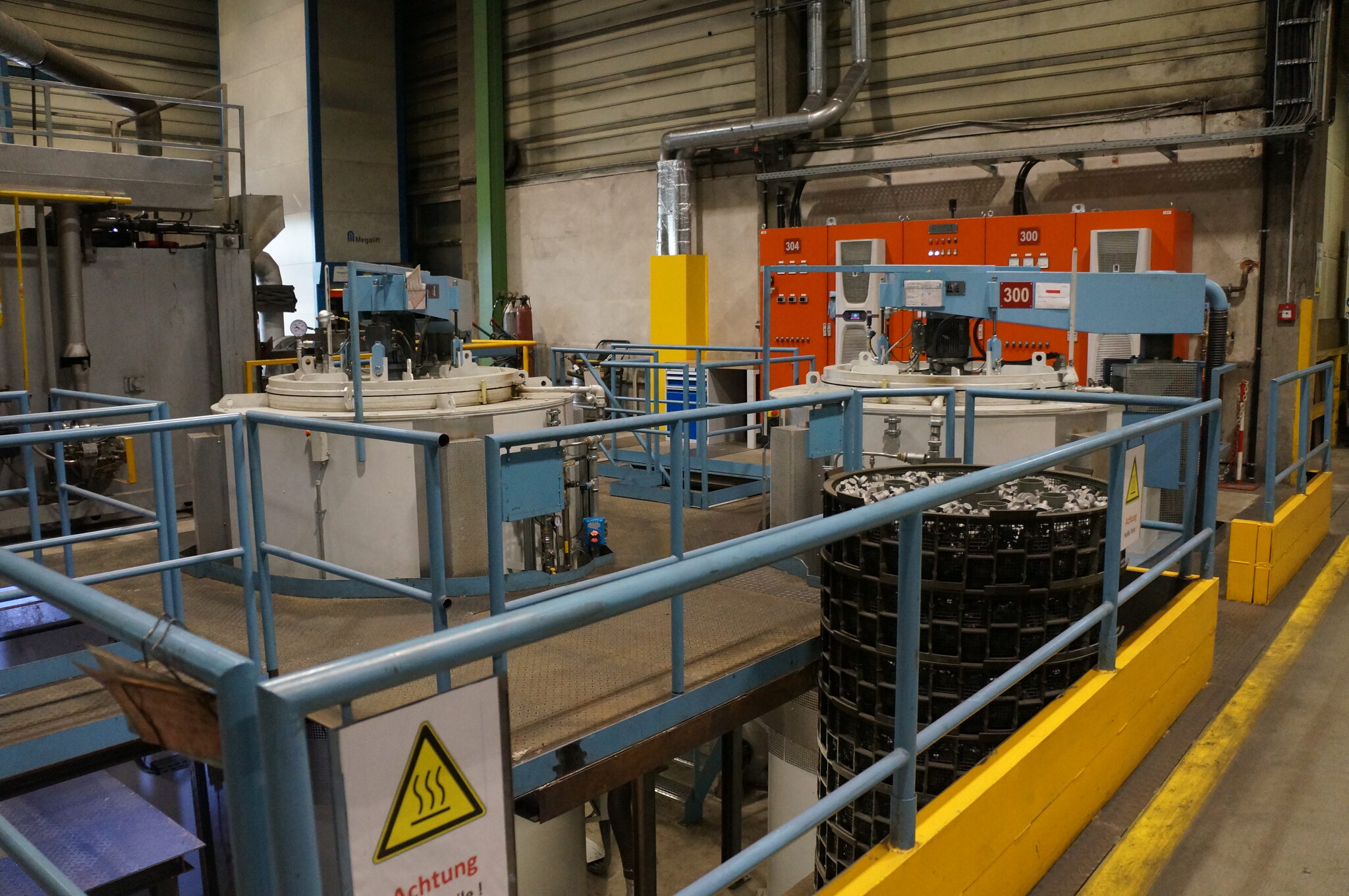

To add to this impressive list of equipment the company is two weeks away from starting up a 2,000 kg/hour gas fired pusher line which will be completely automated. The photos below show a small portion of the heat treat department which features 8 pit annealing furnaces.  Incidentally all the fixturing for the pit furnaces which you see in these photos is investment cast. It turns out the company has been using fabricated fixtures for many years however they recently switched over to investment cast on the basis that while it is more expensive up front in the long run it is cheaper because of the life.”
