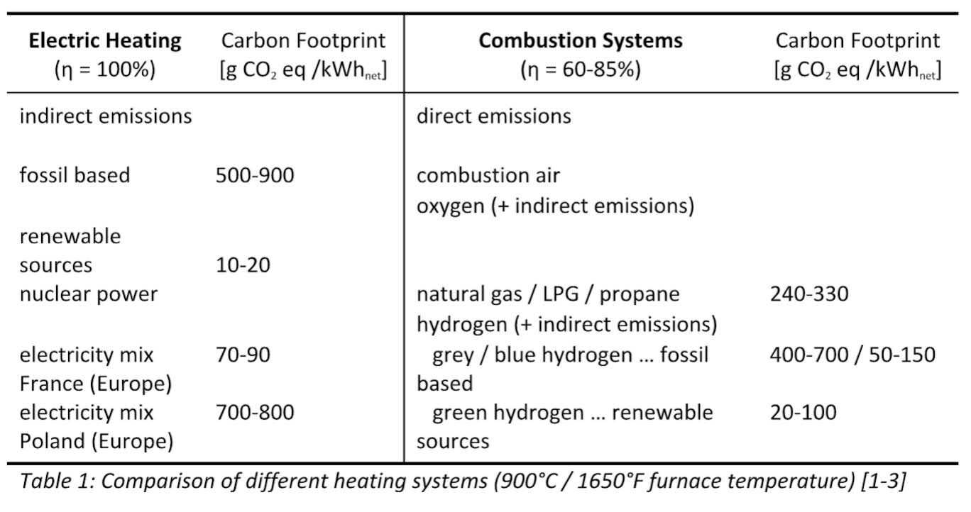

So, at the end of the day, it might be a compromise to decide upon electric heating or different gas heating systems depending on the local situation. Although the background of the carbon footprint respectively total greenhouse gas emissions will not be discussed in detail, it is nevertheless important to outline the relation between the energy source for heating and CO 2 emissions. Table 1 shows a rough overview of different heating systems. The following data should be understood as orders of magnitude only. This shows that, due to local differences in electricity generation, no general statement can be made regarding gas heating vs. electric heating with regard to CO 2 emission.
Based on this data, it is necessary to further exploit the optimization potential of gas burners. Especially when talking about heat treatment plants with heating capacities in the range of 300- 800kW (1,000,000-2,700,000BTU/h), recuperative single burners with 30-60kW (100,000- 200,000BTU/h) are state of the art in Europe. Meanwhile, efficiencies up to 85% in combination with single ended or U-tubes are feasible – 30% savings in gas consumption (in comparison to burner without preheating of combustion air). With increasing air preheating NO x emissions might also increase. Up to now, this has only been taken into account to a limited extent; in contrast to large combustion plants, central exhaust gas cleaning systems are not considered. In the following two approaches for NO x reduction will be given:

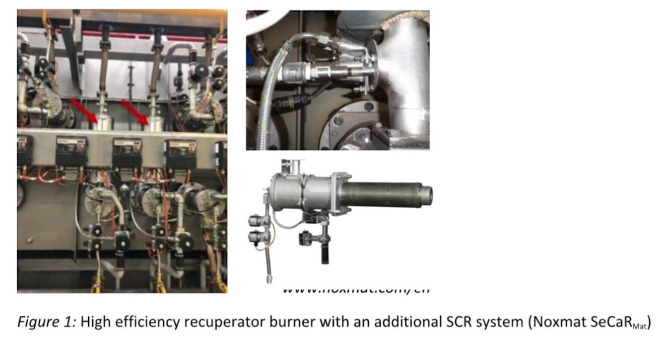

Selective catalytic reduction (SCR) [5]
The concept of SCR using ammonia respectively urea to reduce the NO x content was already adapted for the automotive industry years ago. This principle can also be used for single burner units using urea injection and a single catalyst unit (vanadium/titanium dioxide-based). The temperature limits of use (due to chemical reaction kinetics) must also be pointed out for this technology. Figure 1 shows a high efficiency recuperator burner with an additional SCR system.

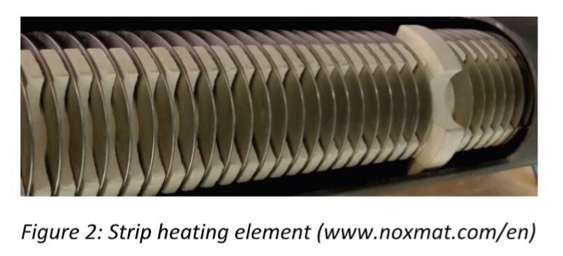

Beside ecological and economical aspects the technical issues must be considered as well. Electric heating systems might be limited by the power because of limited space. Strip heating elements (Figure 2) gives to possibility to use higher power density in combination with lower surface load, this gives a positive effect on service life. Nevertheless, it is important to keep in mind that electric heating elements must be connected sensibly to ensure a symmetrical load on the power grid.
