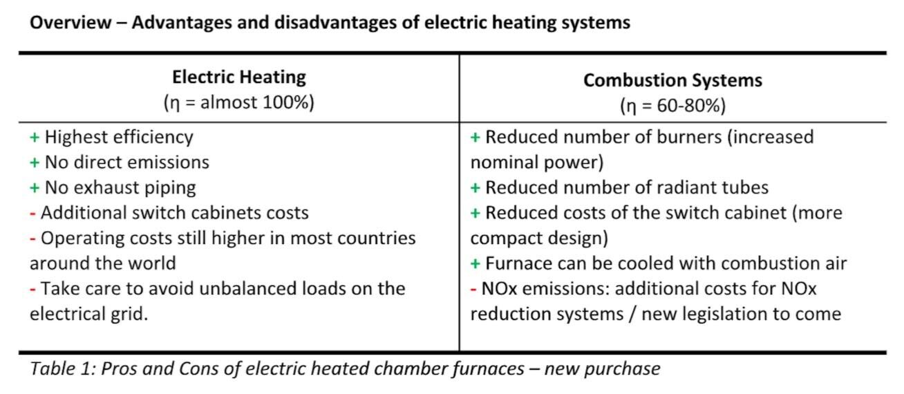

Retrofits and new purchases in existing production lines – While various technical concepts are possible or can be easily adapted for new plants, the situation is more complicated for existing heat- treatment systems. Assuming that the necessary power supply is available at the factory, that the wire size is sufficient and that there is enough space to expand the switch cabinets, the number of existing gas burners and their heating capacity is a challenge in most projects.
  • For standard electric heating elements, the sum of all heaters must be divisible by 3 to avoid creating unbalanced loads in the power grid.
  • The use of 2- or 3-phase heaters is just being implemented for the first customers – long-term experience is not yet available.
  • The heating power to be installed must be adapted to the diameters and materials (steel, ceramic, powder metallurgical based) of the radiant tubes installed. Despite the higher efficiency, a reduced power input is possible.
Active Radiant Tube Cooling – In gas-fired systems with indirect radiant tube heating, the combustion air can also be used to cool the system. This cooling is used for faster temperature reduction from carburizing temperature (920-950°C / 1690-1740°F) to hardening temperature (850- 880°C / 1570-1610°F). Without this active cooling, the process time will be extended on a case-by- case basis. Currently, there is no easy way to solve this cooling function for electrically heated heat- treatment equipment without additional technical and thus financial effort.
