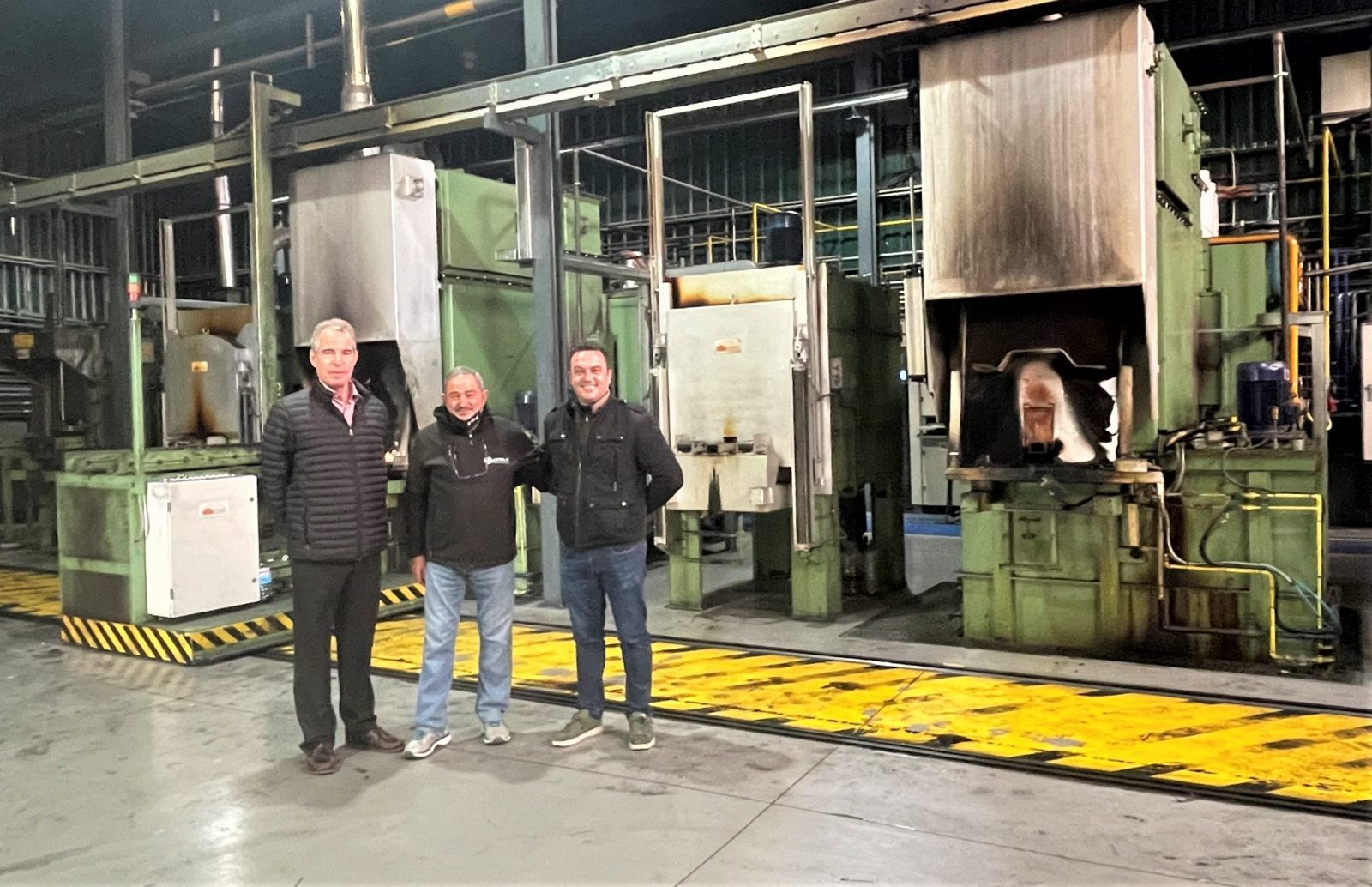

Our first visit was to a captive/commercial heat treater by the name of TTO (Tratmentos Termicos do Oeste) in Maceira, Portugal http://tratamentostermicos.com/pt/. This family owned and run company consists of 3 divisions, a machining division dedicated to the mold making industry, a second division which supplies graphite products and a third division which is the focus of our attention-a captive and commercial heat treating facility.

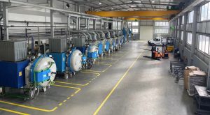

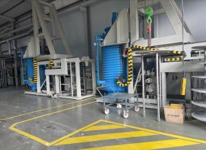

In turn the heat treating facility can be divided into three parts; a sealed quench (batch IQ) department, a plasma nitriding facility (Ion nitriding as some would call it) and a vacuum department which includes vacuum hardening furnaces, vacuum nitriding units and vacuum tempering systems.
The plasma nitriding operation consists of two Klockner units in imppecable condition which originally came from Bodycote, the atmosphere facility has two sealed quench furnaces with oil quenching and the vacuum line has an impressive 12 furnaces which makes this a very substantial operation-either captive or commercial although it is more a captive operation than a commercial one.
