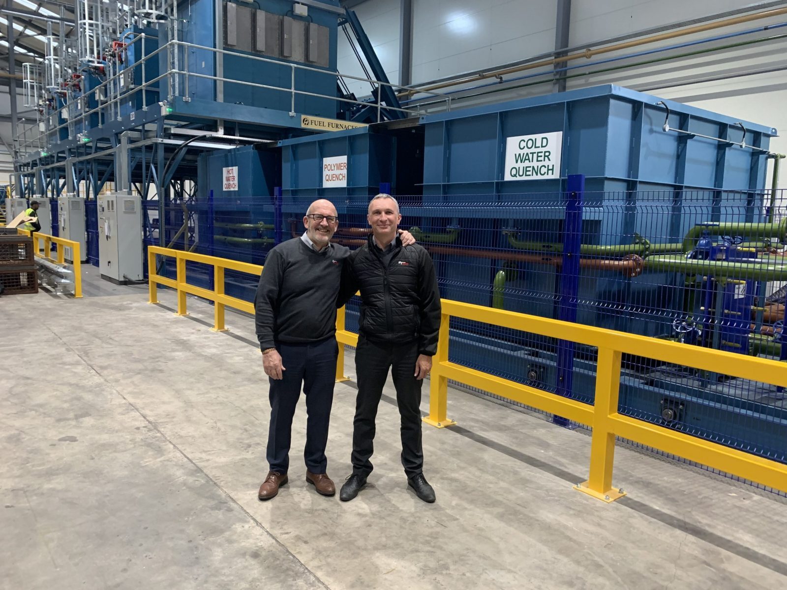

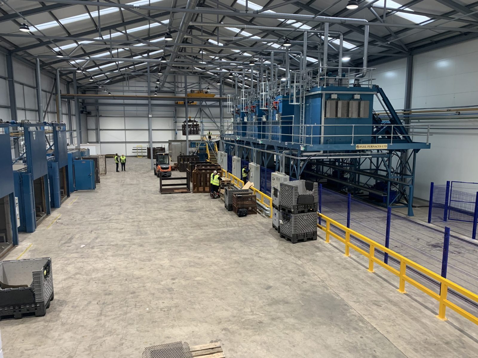

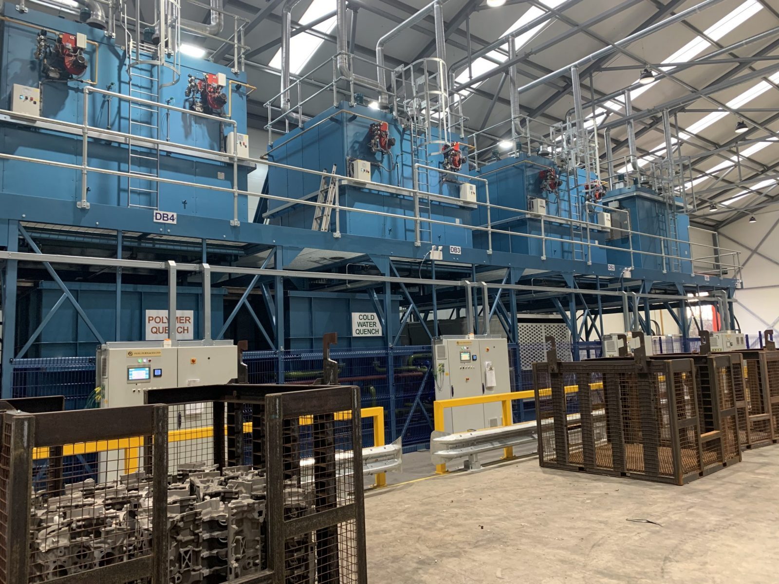

Lets go to the UK for an announcement about a major investment in an aluminum processing facility. We actually visited this company back in 2013 shortly after they had installed a new 6,000 pound an hour mesh belt furnace line (you can find the 2013 announcement further down). The company provided this short U Tube video for us.
“We are about to announce the opening of a new  £3 million heat treatment facility for aluminium processing. It is sited adjacent to our existing facility and complements our current aluminium capability and the 300 tons per week of fasteners and presswork we currently  heat treat. The investment consists of a suite of automatic computer controlled rapid quench furnaces capable of taking up to a 3 ton charge which can be quenched in temperature controlled cold water, hot water or polymer. The latter is followed by and agitated rinse and hot power wash to ensure product cleanliness. This is supported by new precipitation ovens with automatic door opening. Furnaces are a combination of gas and electrically heated opening up new opportunities as well as meeting increased demand for our services. Our investment doubles capacity giving us one of the largest processing capabilities in the UK. Bar code tracking and scanning have also been introduced providing live data which can be accessed remotely.”
