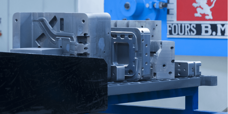

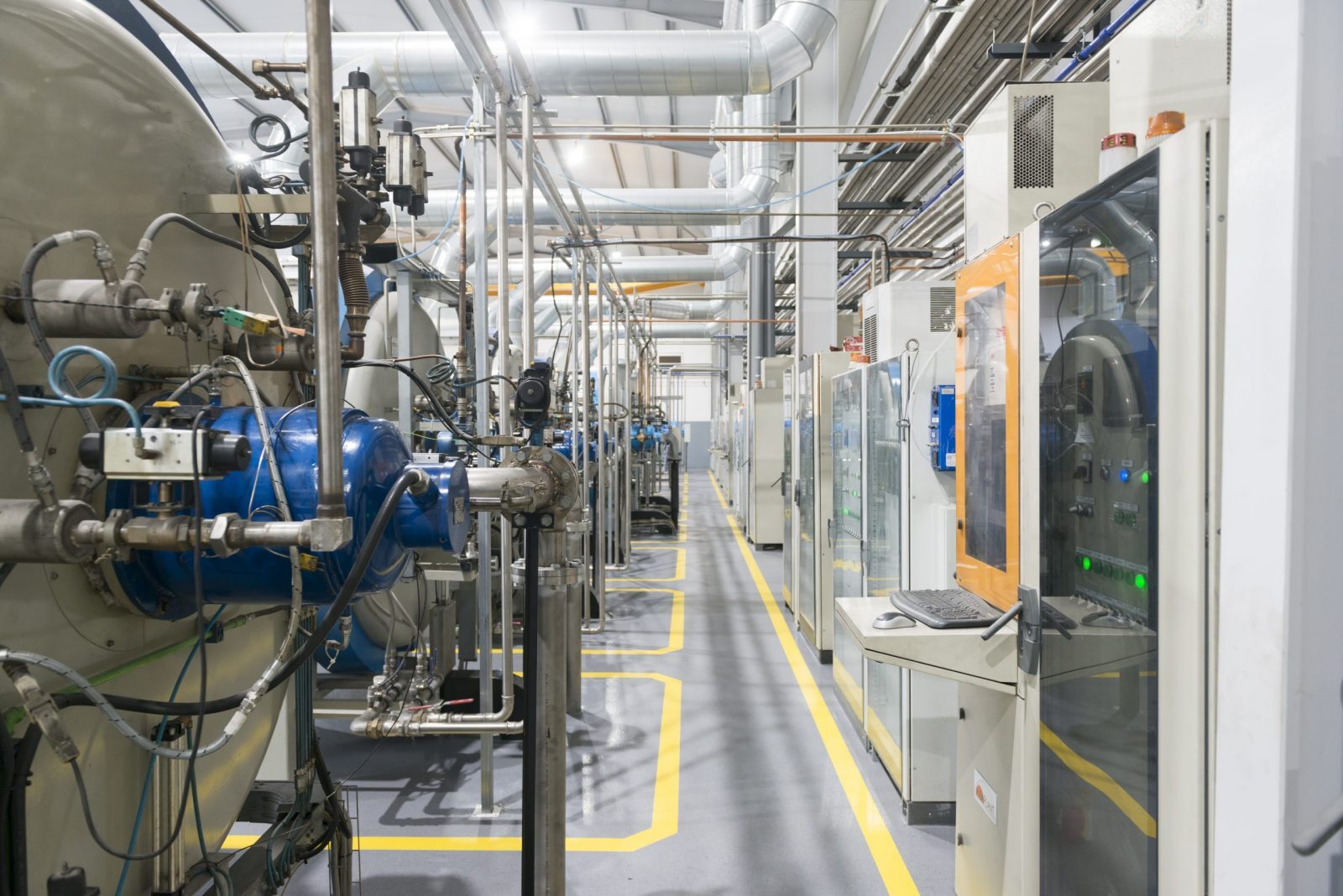

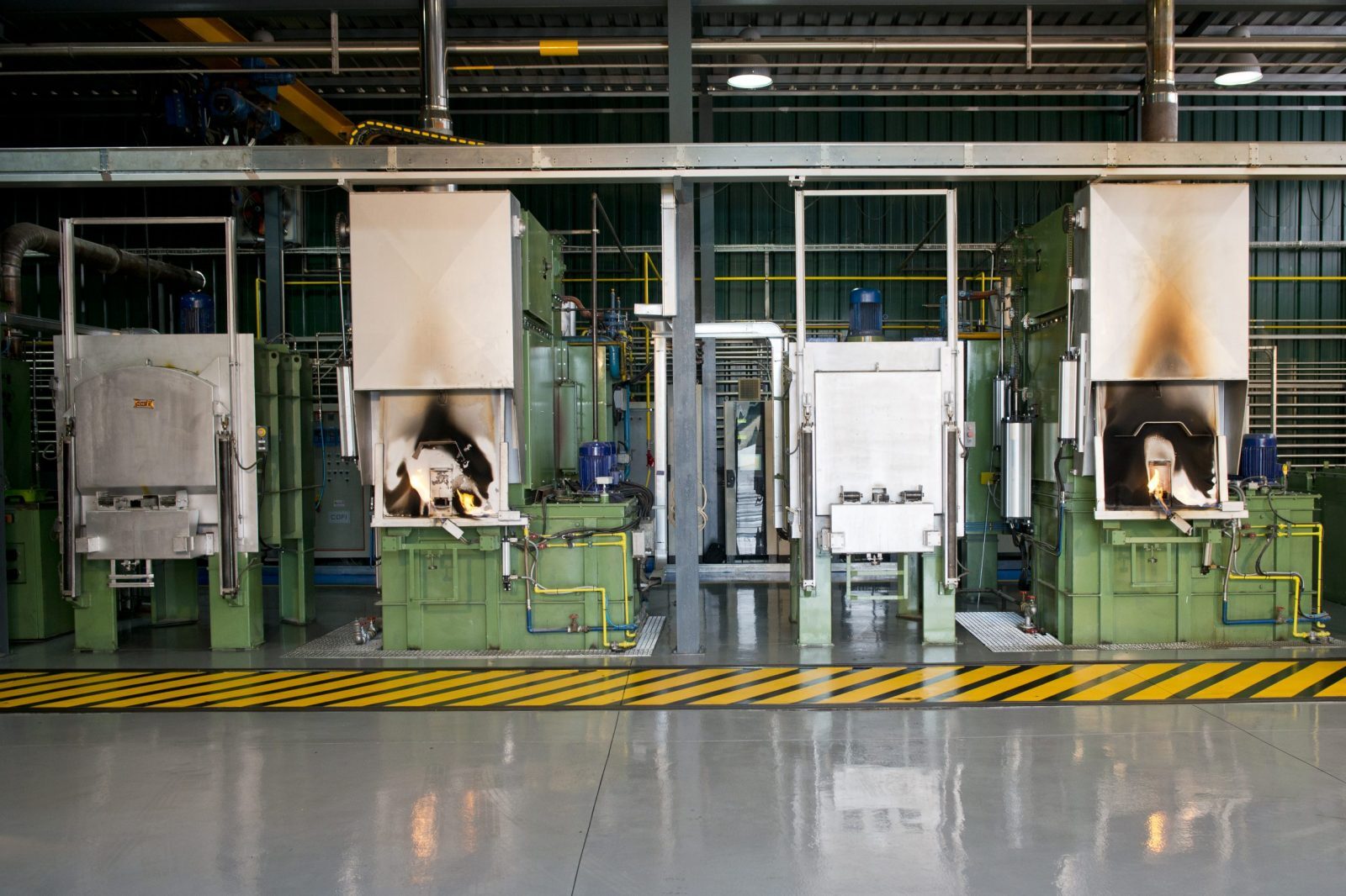

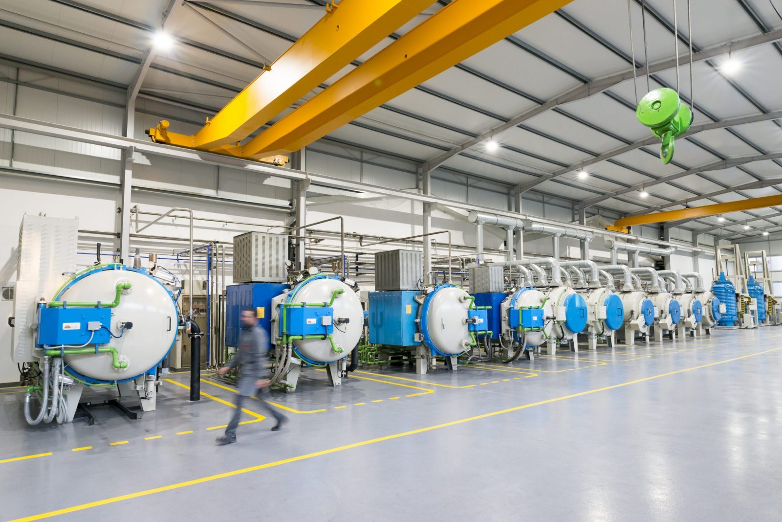

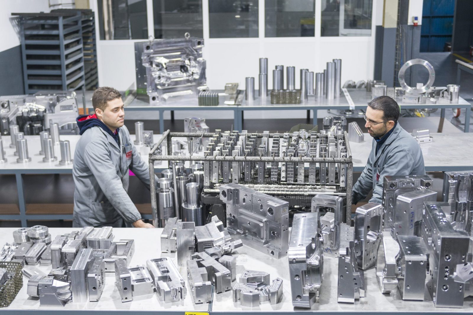

The newest and most aggressive heat treater in the country is a company by the name of TTO http://tratamentostermicos.com/pt/ The company is a manufacturer of components for molds and they entered the heat treating market in 2005. Over the years they have continued to add new furnaces with the end result that they now have 12 vacuum hardening and vacuum nitriding furnaces all from an Italian company by the name of Coffi. This is in addition for several carburizing lines which service the components side of the business. Unfortunately at this date we can’t give you any first hand insight, this will have to wait for another day. What we did learn though in our preparations for Portugal is that while it is a small market, it appears to be a very sophisticated one and from the photos we have seen the heat treating will rival most areas of the world.
