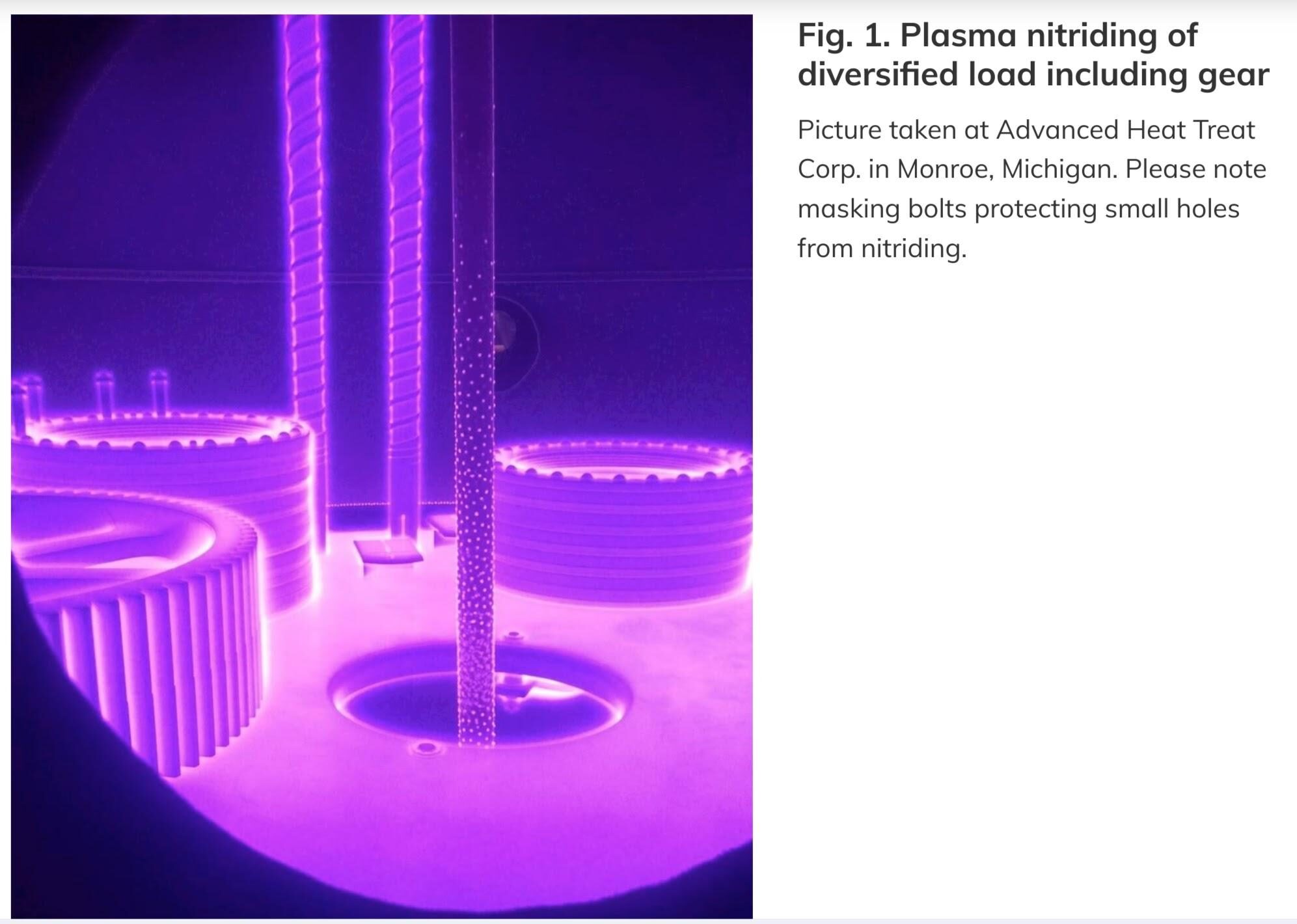

The Plasma/Ion Nitriding Process
This process is carried out in a vacuum chamber/furnace connected to the DC power supply in an atmosphere of nitrogen mixed with hydrogen. The load/gear has a negative-cathodic polarization and the chamber wall has the anodic polarization. Ions and neutrals-energetic particles generated near the cathode bombard its surface and produce active nitrogen atoms as well as the ammonia radicals. As a result, nitrogen atoms are subjected to chemisorption at the surface and diffuse into the steels. The entire treated surface is covered with the glow discharge, Fig. 1. Masking/protection of the selected surfaces from hardening is very simple; it is done with the steel bolts, plates, etc. which cover them and protect from a contact with the glow discharge.
The nitrided layer is very hard and its thickness reaches 0.040” (1 mm), if required. Such a layer increases bending fatigue resistance of the teeth, as well as the RCF and wear resistance.

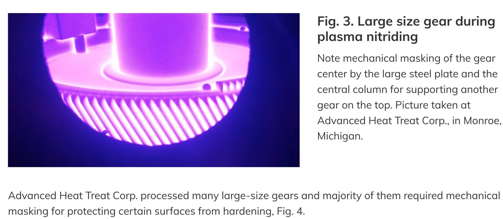

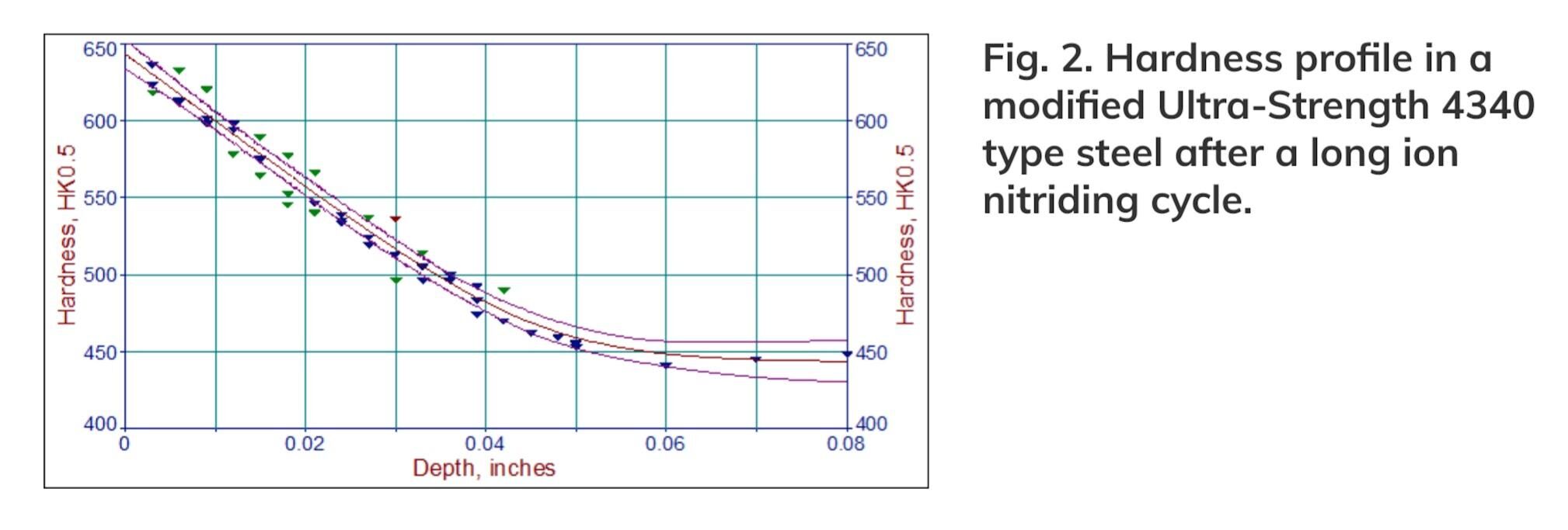

It should be noted that the core hardness of the modified Ultra-Strength 4340 type steel after nitriding stayed very high, which is a result of the low temperature of the treatment. This is important in maintaining its high yield strength. Benefits of plasma nitriding of large gears include ability of the method for forming the nitrided layer with a very minimum compound zone thickness as well as the easiness of simple, mechanical masking of the not geared sections such as its center and other surfaces, see Fig. 3.

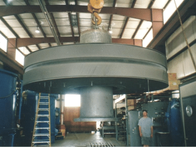

Fig. 4. The large-sized, low-noise second reduction marine gear after plasma/ion nitriding
Picture taken at Advanced Heat Treat Corp., in Monroe, Michigan.

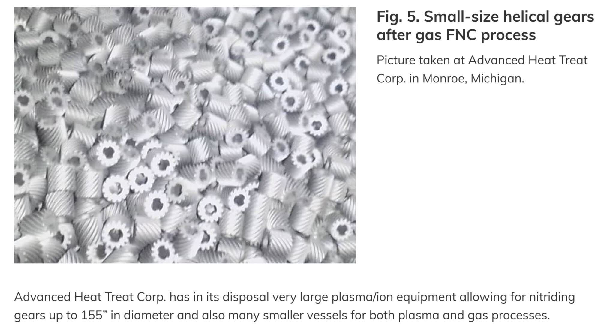

The gas nitriding method has also been successfully used for treating various gears. Although the produced nitrided layer has the required thickness and hardness, its compound zone has a tendency to be too thick and must be mechanically removed after processing after gas method. Also, masking/protecting from nitriding in gas nitriding is more complicated than in ion nitriding. It requires a galvanic plating with a copper, which has to be removed after the processing. Benefits of gas nitriding or nitrocarburizing (FNC) can be seen when gears that do not require masking need the treatment and especially those which are very small, Fig. 5.
