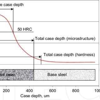

Care must now be given to the load selection, particularly if the formed case is a thin case. A heavy load will penetrate the formed case and will result in a false/incorrect reading. A simple rule of thumb might be, 'the shallower the case, the lighter the hardness testing load should be.' If the objective of the hardness test is to measure the depth of case, it will be necessary for the test operator to understand the definition of case depth. Case depth is that formed case that has occurred to whatever depth was specified. This follows that there are two further definitions that will identify:
  • Effective case
  • Total case
Effective case
The effective case is that case that has been formed to a hardness depth from the surface to 513 Hardness Vickers Numeral (or approximately 50HRC scale)
Total Case
Total case is the case that has been formed to a depth of 'core hardness plus 50 Hardness Vickers Numeral. (Or approximately 5HRC scale) on the real core hardness value.

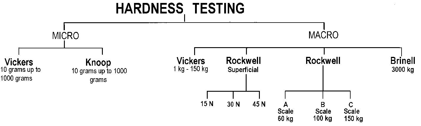

The hardness test loading is usually a micro hardness loading which can be varied from 10 grams up to 1000gram load mass. Depending on the thickness of the diffused case, will determine the load that is selected. Generally, it is usually a 200 - gram to 300 - gram load that is used to determine a total case depth.
The application of the test is performed on the test coupon across the formed case through to the core hardness. Another hardness testing method for micro hardness test (and some macro) is to use the Knoop hardness test unit. This will give the operator the tested values in Knoop Hardness units.
Unlike the Vickers test (which makes a 'pyramidical' square diamond impression and the measurement is made across the two axis), the Knoop method   impression is a long-elongated diamond impression, the hardness value is ascertained by measuring the longitudinal axis.
