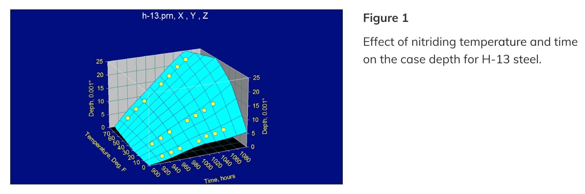

Nitriding is a time-consuming process but properties of the nitrided layer overcome problems which can be encountered when only general heat treating, such as carburizing, carbonitriding and quench and temper, is used. The rate of nitriding is proportional to the square root of processing time but it is also exponentially increased by the temperature, see Fig. 1.
Nitriding Temperatures for H-13 Steel
Processing temperatures for H-13 steel can typically be set comparatively high, > 1000° F since the hardness of this steel is at its maximum if tempering temperature is close to 1100° F. This allows for an expedited nitriding process. Nevertheless, nitrided layers generally don’t exceed 0.008” thickness in an effort to control costs.

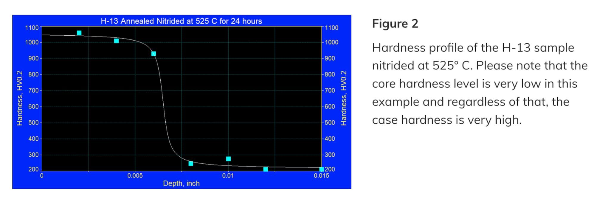

Hardness of the nitrided layer formed in H-13 steel stays very high, above 70 HRc equivalent even for soft-core components, see Fig. 2.
Nitrided H-13 Surface Hardness
Surface hardness HR15N is high and typically, depending on the case depth, is above 92.5. It should be mentioned that aluminum extrusion dies may benefit from a deep nitrided case since a majority of them fail because the stream of liquid aluminum at about 780°C washes out the surface. and This causes chemical dissolution of the steel and soldering Al to it [2-5]. The same requirement for deep case applies to some plastic tools especially those used for forming composites.
