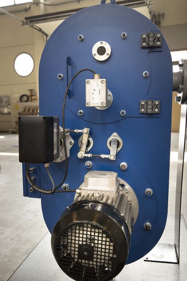

As one of the main protagonists of the energy transition, burners that use hydrogen represent an evolution of traditional combustion systems and allow us to achieve superior energy efficiency with a combustion that eliminates all C02 emissions into the atmosphere. When used together with other fuels, such as natural gas (mixed or multi-fuel burners), it considerably reduces the emission of these greenhouse gases.
District heating and industry decarbonization
Thus, the recently presented prototype hydrogen burner is designed to work only with hydrogen or to operate with a mixture of hydrogen and natural gas for use in district heating installations, for heating buildings and large areas. This last alternative of a mixture of hydrogen and gas is tested by E&M Combustion and is very viable. It consists of a mixture of hydrogen, with 15% -20% natural gas, with which the enriched mixture increases the calorific value and achieves a more stable and efficient combustion. This mixture also makes it possible to improve flame detection, a great challenge with the exclusive use of hydrogen as fuel, due to its characteristics of invisibility to the human eye.
In the hydrogen sector, Spanish engineering company E&M Combustión contributes its technology and experience in the field of industrial combustion and in hydrogen combustion systems, specifically, to which it provides advice, design, manufacture and commissioning of Hydrogen Burners and Hydrogen Combustion Systems in power generation plants and industrial processes, especially in the chemical and petrochemical areas.
The use of hydrogen in industry provides new tools to eliminate CO2, which is largely responsible for climate change. For Iñigo Béjar, CEO of the company “this milestone is a great opportunity for the planet as a whole, and for the improvement of production processes, although it requires the accompaniment of a technological partner and specialized attention to combustion challenges that this new fuel brings with it “.
