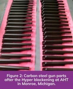

Advanced Heat Treat Corp. (AHT) offers Caustic Black Oxidizing carried out at 290°F, which forms a black iron magnetite. The finish does satisfy the military specifications MIL-DTL13924 and AMS2485 [2]. The most common applications of this treatment are in the mechanical engineering and firearms industry for enhancing chemical, mechanical and optical properties of the components, see Fig. 2.

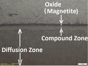

UltraOx Hyper technology invented by Advanced Heat Treat Corp. allows for optimizing nitrogen and carbon content in the compound zone to maintain it above 8.5% by weight before the magnetite layer is formed at the surface. All those well-controlled post-nitriding oxidation properties can even be more enhanced when additional corrosion inhibiting organic sealing of the microporous surface is used as it is done by the Hyper treatment.
Structure of the near-surface layer of the components treated with one of the above technologies is quite complex and every detail of the layer is very precisely controlled by proper processing. Examples of those layers are shown in Fig. 4. Application of UltraOx and Hyper technologies are growing in demand since they can be used in the most challenging applications where the others anti-chafing and anti-friction technologies are not sufficiently good.
