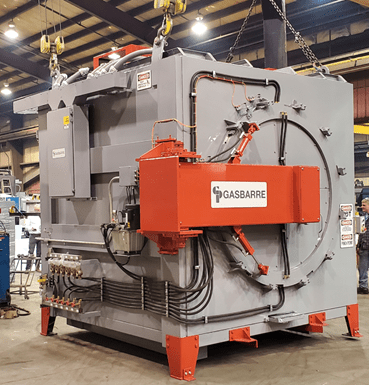

“Gasbarre Thermal Processing Systems is proud to announce that Thermal-Vac Technology recently partnered with Gasbarre to add precision nitriding and FNC capabilities to their facility in Orange, California. The electrically heated furnace utilizes Super Systems, Inc. controls for automatic KN and KC control to AMS 2759/10 & 2759/12 specifications. The furnace is designed to meet AMS 2750/F as a Class 2 furnace, which allows it to be used to perform nitrogen tempering and stress relieving processes. For cycle time improvements and consistent process control the furnace is equipped with a vacuum pump for purging processes, pre- and post-oxidation capabilities, and accelerated air and atmosphere cooling systems.  The furnace also comes with an ammonia dissociator to achieve zero white layer processes. It is capable of processing workloads that are 48” wide by 72” long by 40” high and weigh up to 7,000 pounds.  Gasbarre Thermal Processing Systems is proud to say that this complete system is engineered, manufactured, and serviced out of our United States locations solidifying our position as a leader in equipment for the nitriding and FNC process.  Thermal-Vac is set to receive the equipment in March of 2021 and is excited to announce the new capability to their growing customer base.
