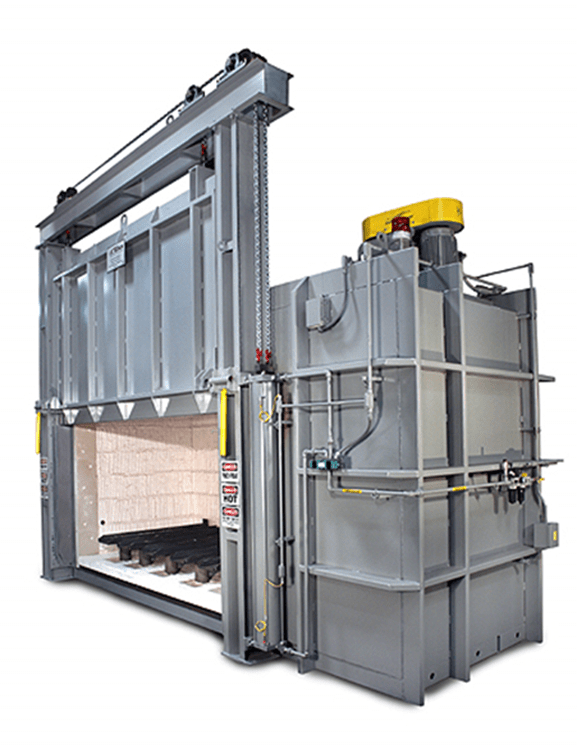

“Gasbarre Thermal Processing Systems recently delivered a custom built batch tempering furnace to a commercial heat treating company located in the heart of the Aerospace industry on the West Coast of the United States. With a working load size of 168” wide, 48” deep, and 48” tall, coupled with a max load weight of 10,000 pounds, the furnace can accommodate a number of differently sized parts within its market.  The gas fired air furnace passes survey at +/- 10℉ over a temperature range of 850℉ to 1350℉ per AMS2750E. At our customer’s request, the electrical controls are UL approved and include the latest in Eurotherm brand temperature controlling instrumentation. Gasbarre was chosen as the provider of this equipment because of our ability to provide key custom sizing at the desired temperature uniformity and proven performance from prior equipment purchases.
