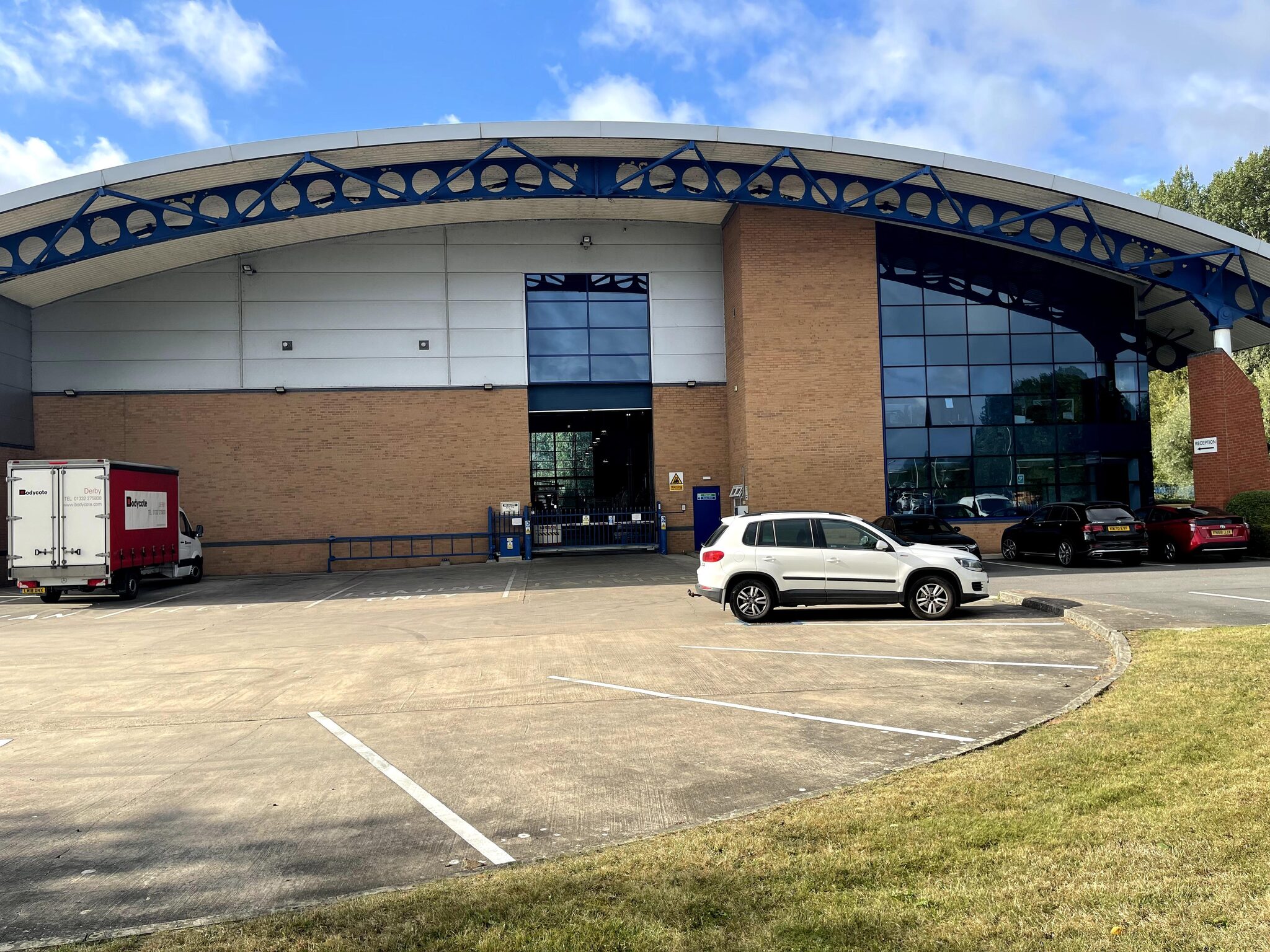

This facility, shown in one of the photos below is one of two Bodycote locations in the United Kingdom largely dedicated to Rolls Royce, the second is located in Rotherham. Incidentally, if you  look closely at the architecture of the building, you will see that it was designed to resemble an engine turbine blade. The Derby site has the largest installed  vacuum heat treat capacity  available  in the UK heat treatment market.

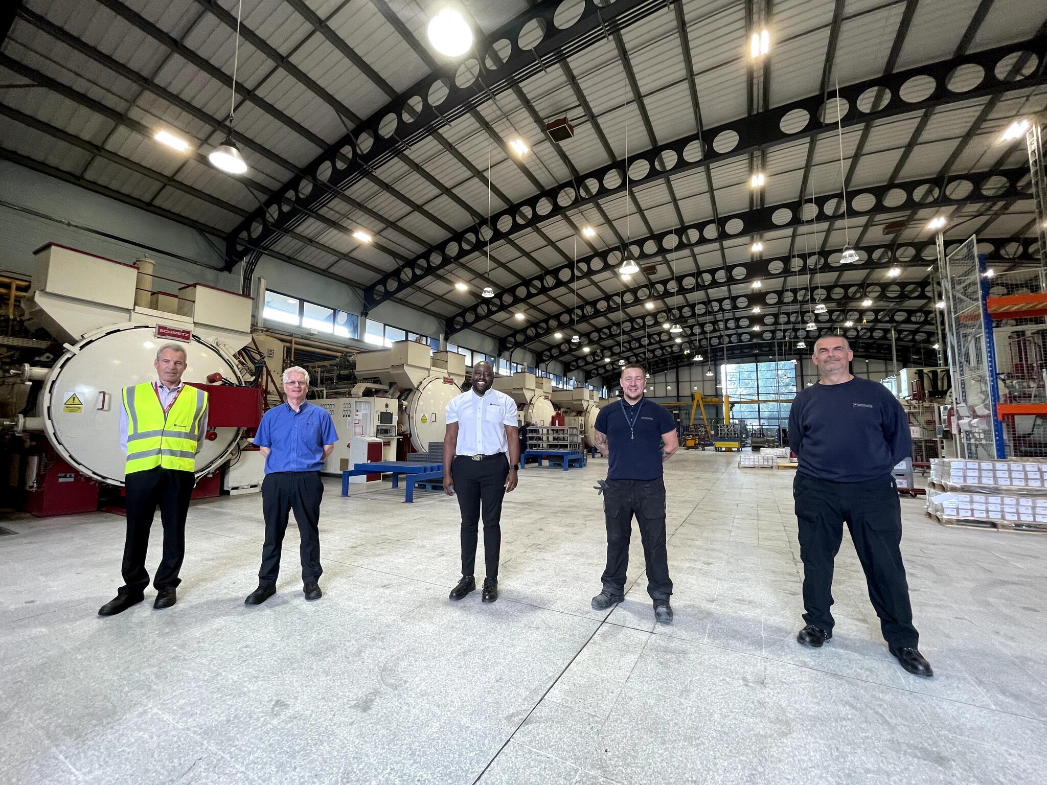

Derby contains two rows of horizontal vacuum furnaces opposite each other and a complementary  HIPPING Unit at the end of the building, 6 of the 10 furnaces  have   10 bar quenching capability in both Nitrogen and Argon .  While it is certainly true that this facility was set up for Rolls Royce; the facility also provides advanced solutions for customers in the medical and power generation industries.
