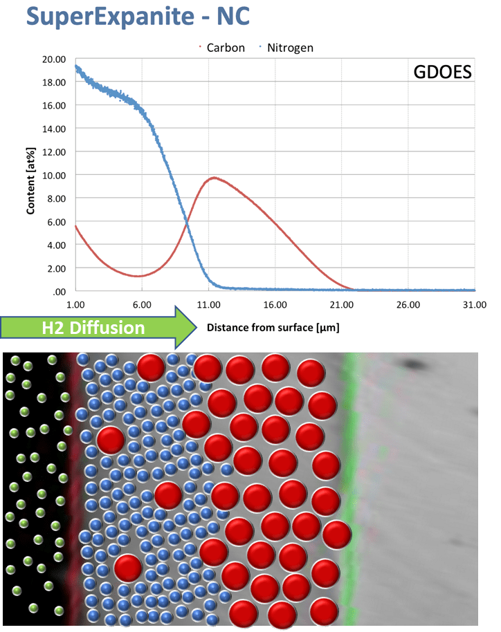

The solution to this dilemma – a surface hardening that protects against wear and galling while at the same time maintains or even improves the corrosion resistance of the materials – was developed by the founders of the Danish company Expanite and is increasingly being used in the hydrogen sector. For example, components of high pressure and control valves or clutch systems used in the hydrogen infrastructure up to components for fuel cells are hardened. Sustainably prevent hydrogen embrittlement
“Our customers often ask whether the Expanite technology increases the risk of hydrogen embrittlement, which is not the case,” explains Dr. Holger Selg, application expert and Expanite Sales Director DACH, who going further into detail: “The cause of the hydrogen embrittlement can be traced back to the diffusion of the hydrogen into the material, and in theory the Expanite layer acts as a diffusion brake to a certain extent. Charged with nitrogen and carbon, the Expanite surface is harder for the hydrogen to penetrate than an untreated surface.”
