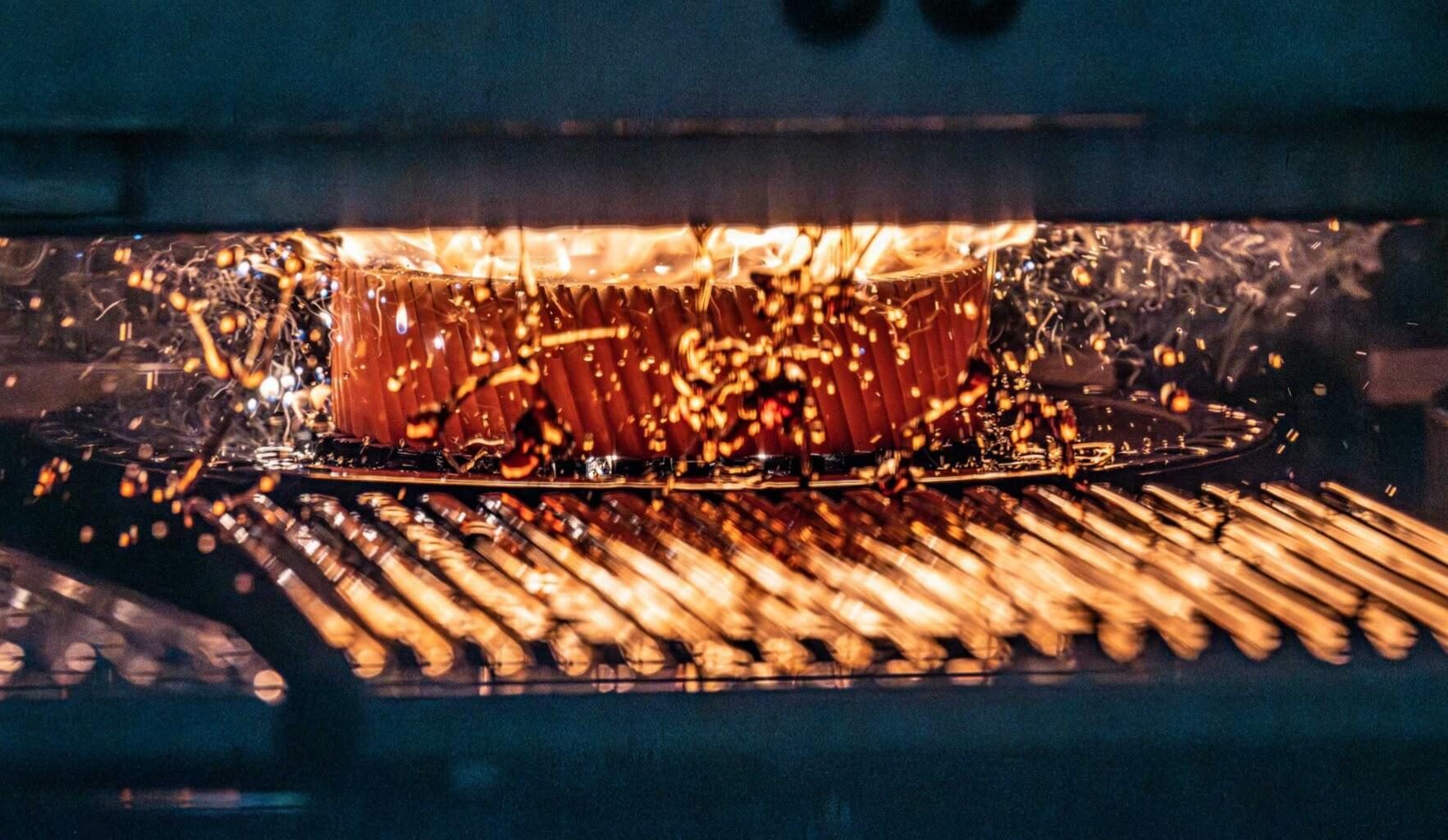

Plant 02.10 in Dingolfing produces chassis and drive components for BMW, MINI and Rolls-Royce vehicles. To make them more hard-wearing, the parts are hardened in special furnaces. As electric mobility ramps up, more and more components are being manufactured, including for electric drives. Existing systems are gradually reaching the limits of their capacity, so a new ring hearth furnace with a fixture hardening press was needed.
Used to harden gear wheels for electric transmissions, the innovative system has production capacity of approx. 960,000 spur gears a year. What’s special about it is that unlike the two existing furnaces, which are powered by gas, a fossil fuel, this new solution is for the first time powered by electricity. Rather than using 33 gas flames in ceramic-jacketed pipes, as the older model does, the new furnace uses the same number of electric heating elements to heat up to 900 degrees Celsius.
