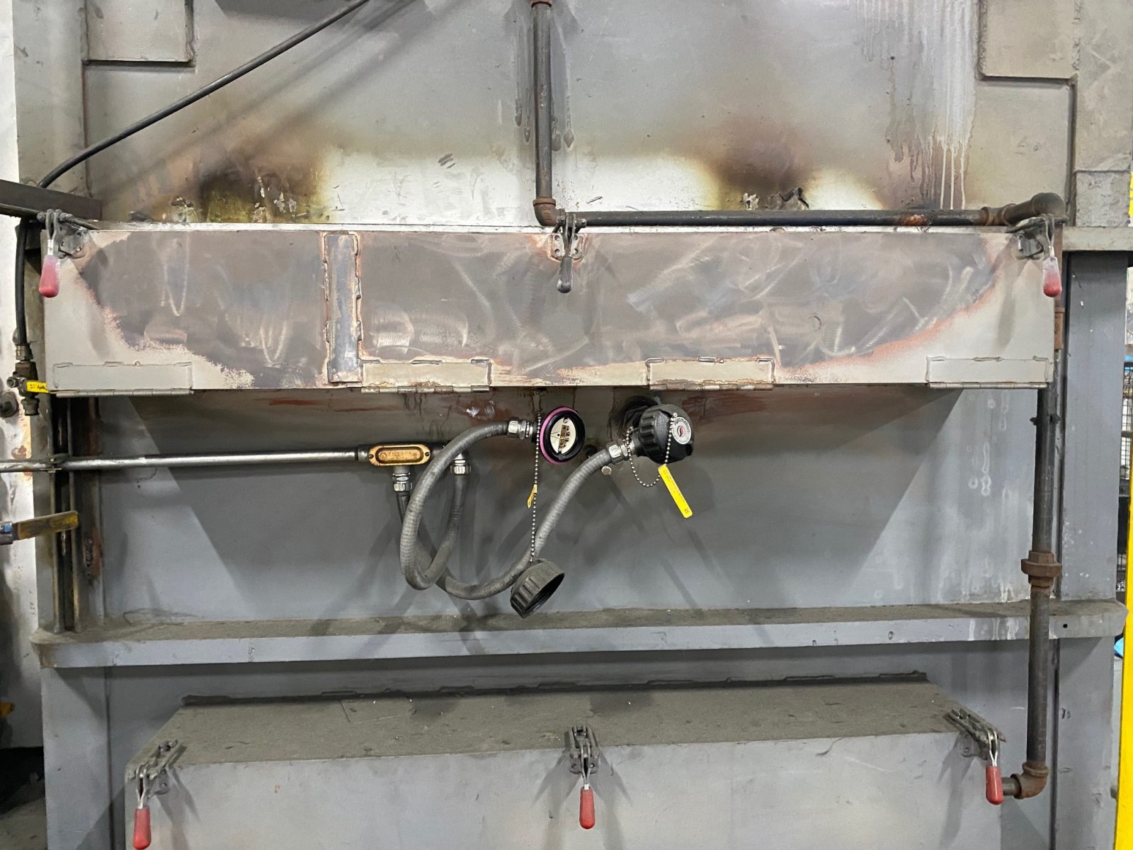

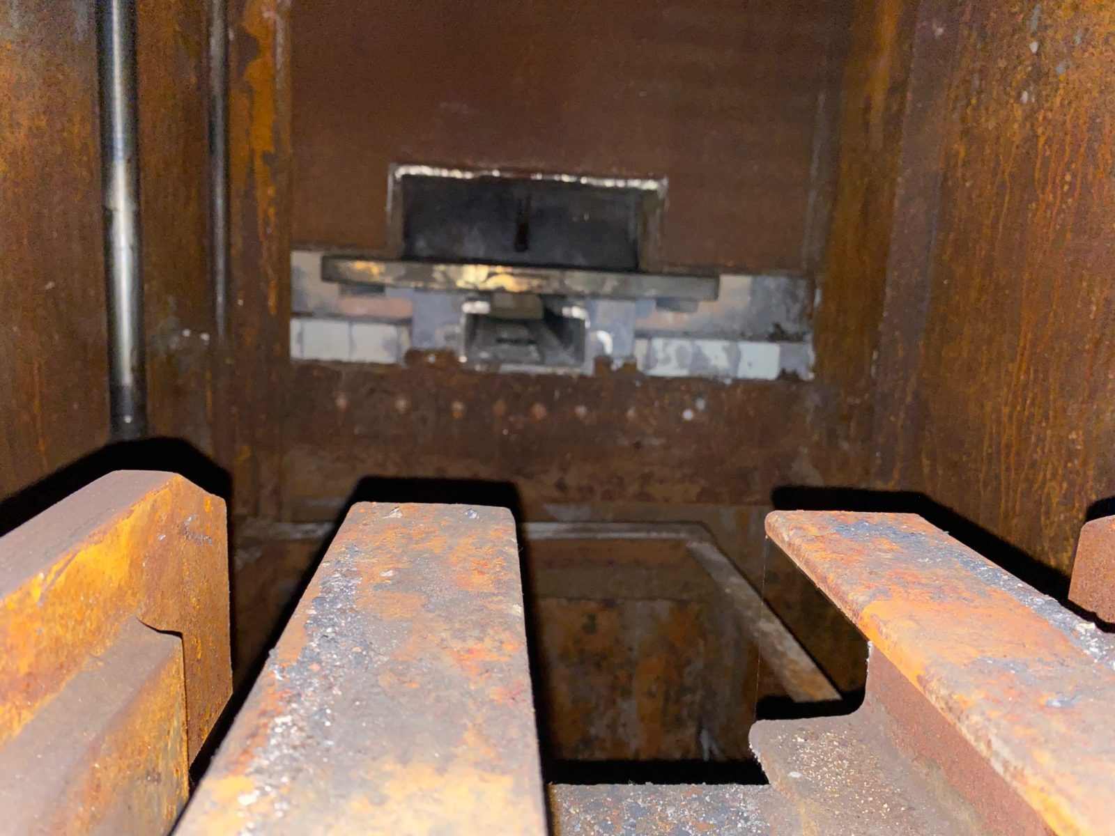

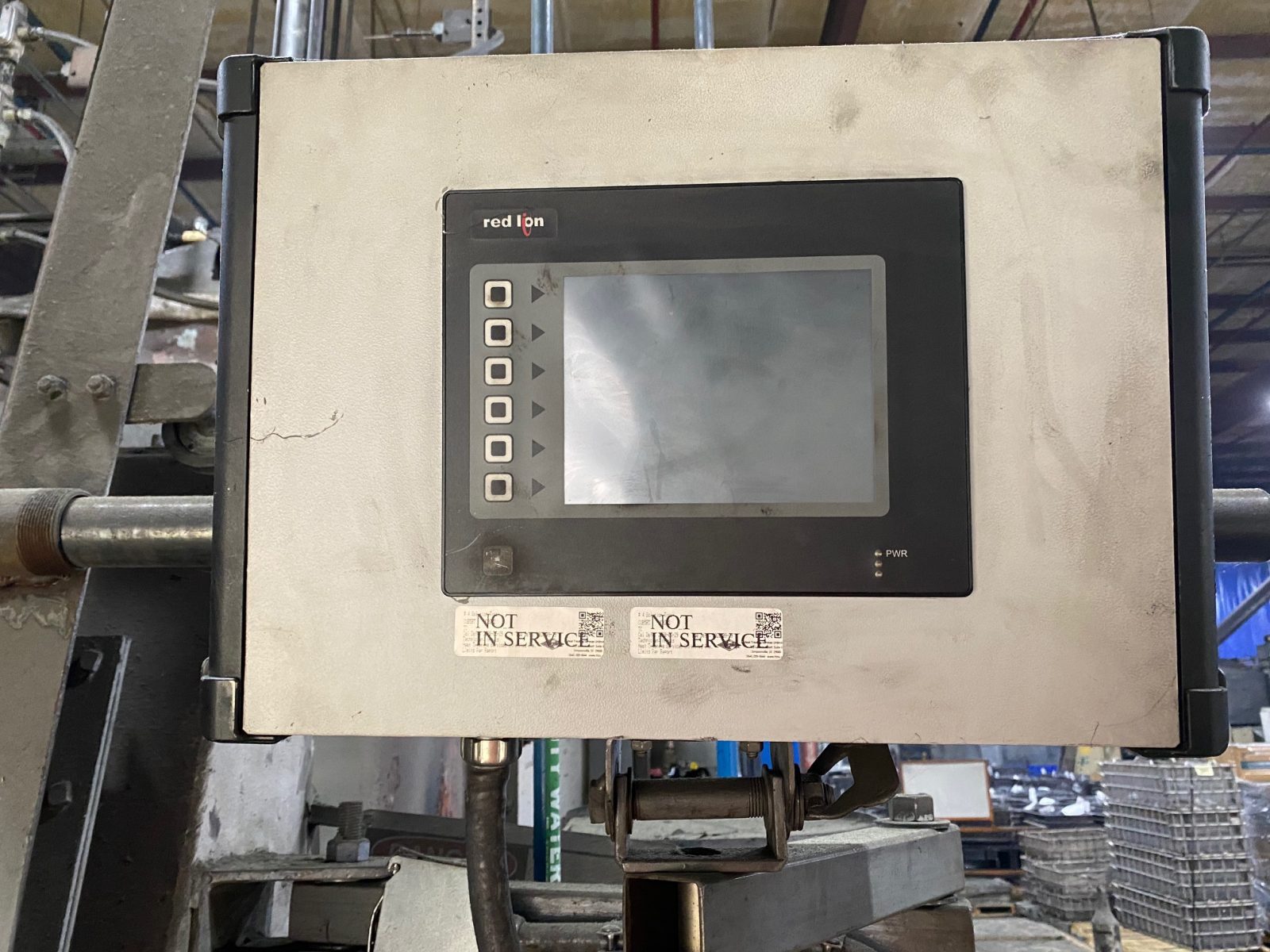

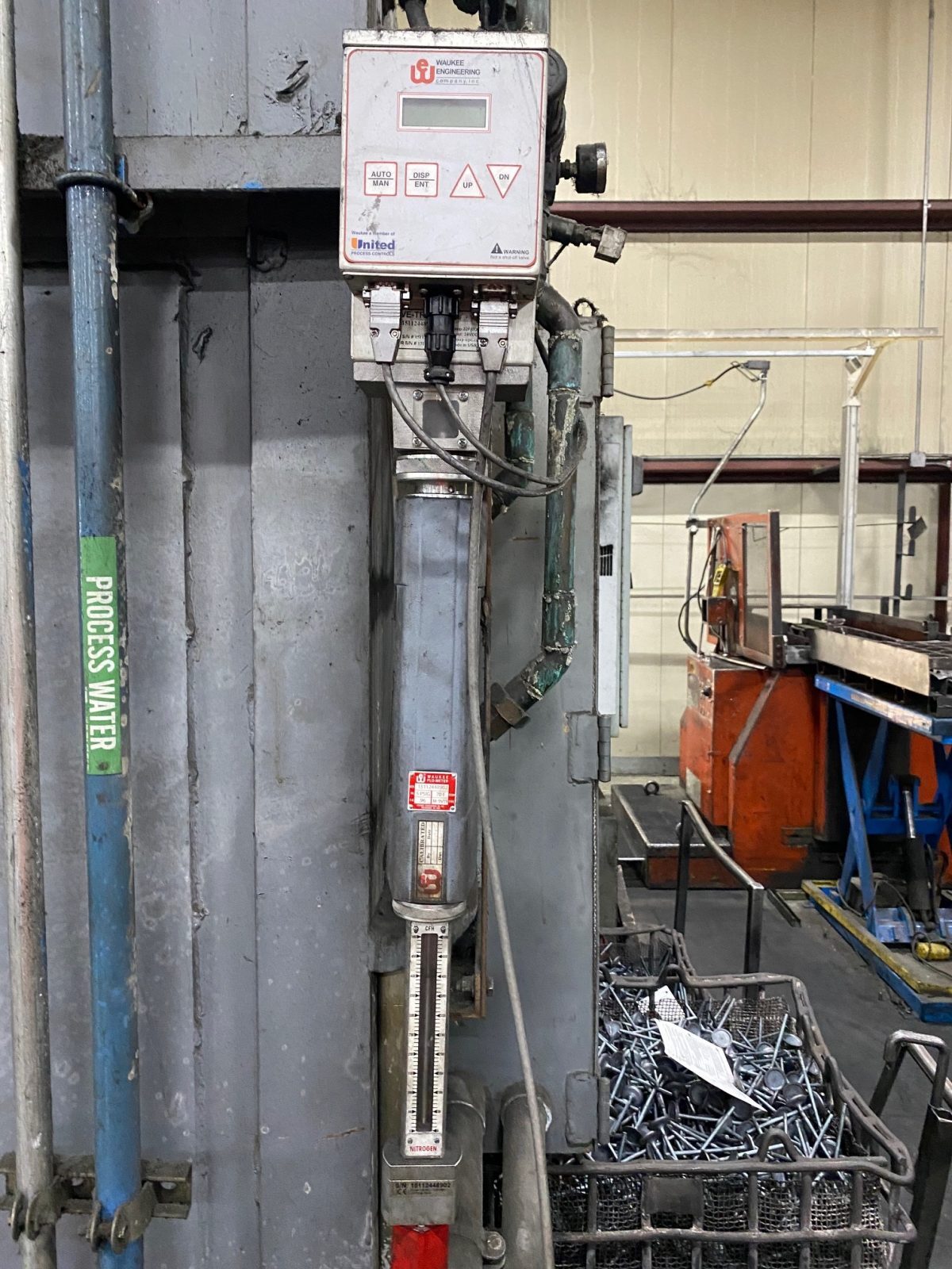

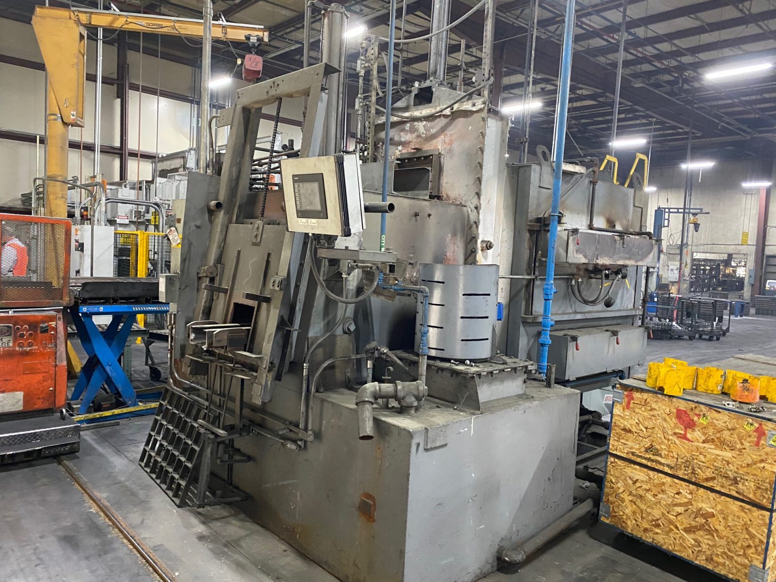

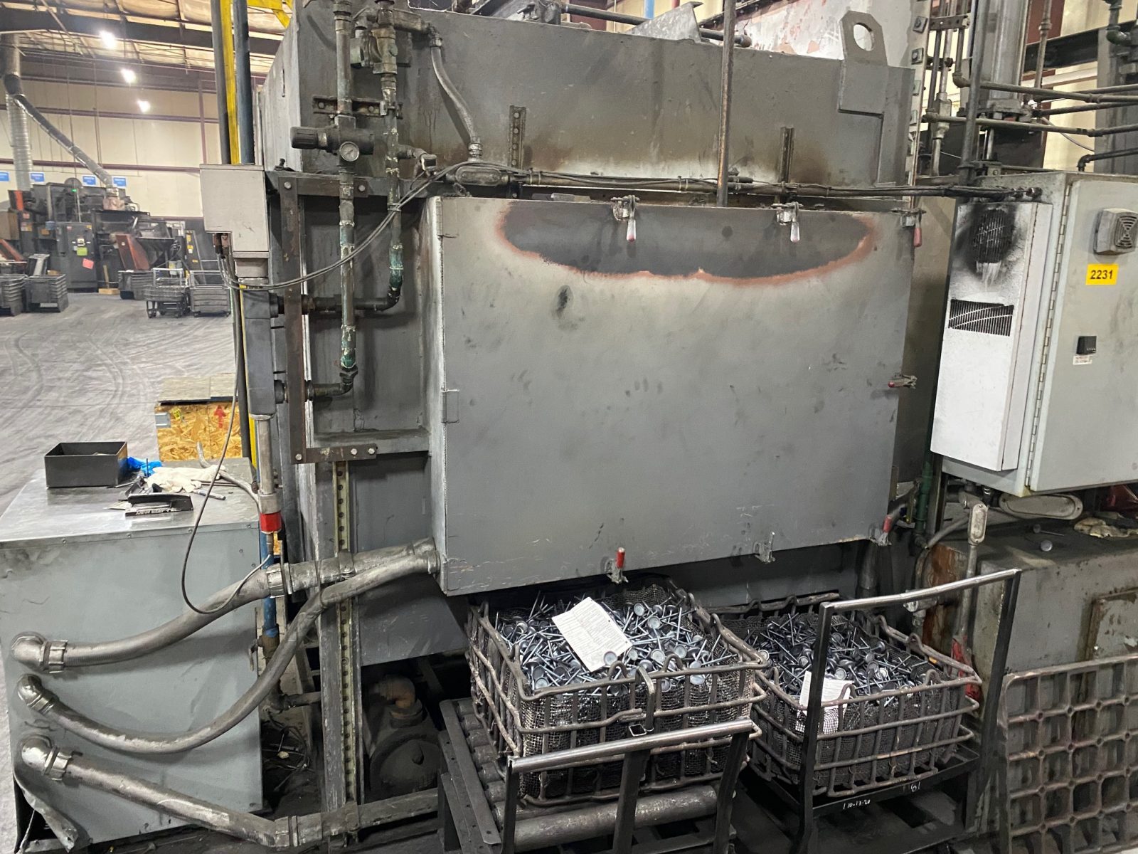

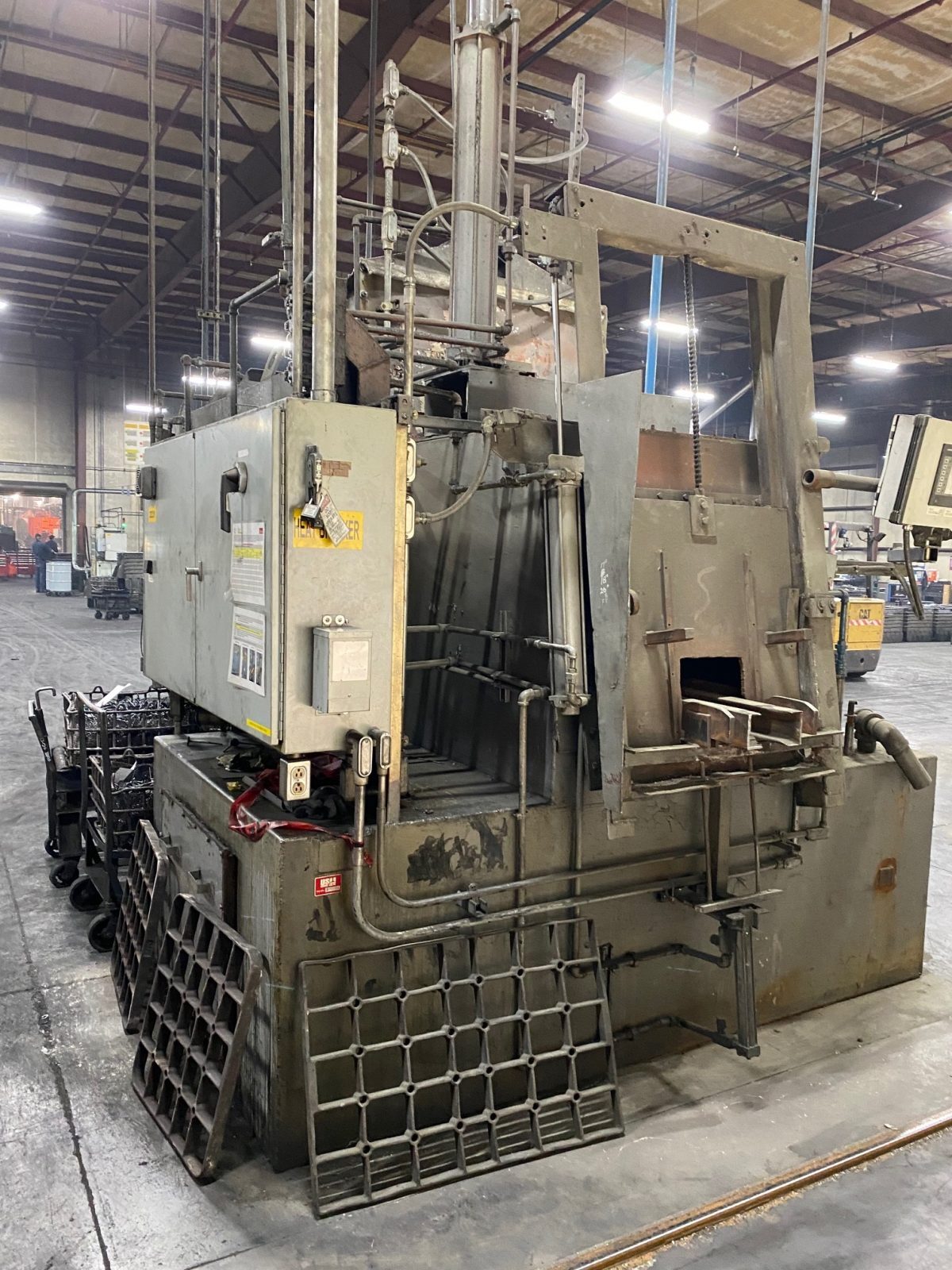

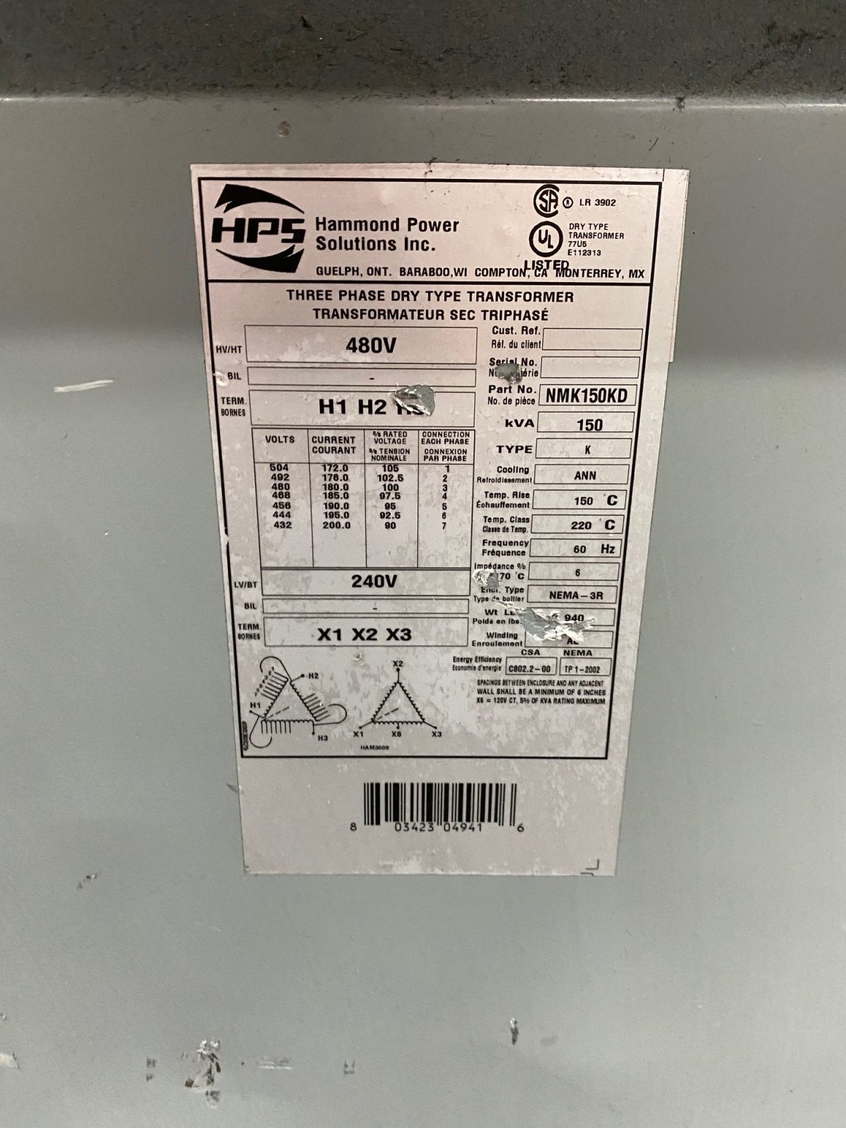

Electrically heated batch IQ furnace with working dimensions of 24” W X 36” deep X 24” high load size. Manufactured by Surface Combustion in the mid 1990’s. Currently used for solution heat treat, water and Polymer quench. Max temp. 2100F, very tight +-10F or better uniformity. Set up for Nitrogen atmosphere. Waukee meter for N2 with solenoids tied to recipes. Sand Lion PLC touch screen controls for recipes, charting, temp, agitator, atmosphere control etc. Horizontal SiCarbide glow bars for heating. Transformer included.  SiCarbide rails make up the hearth for tray support and transfer. Chain guide and roller rails over the quench vestibule. Air operated inner and outer doors. Transfer car not included. Brick and overall furnace is in good condition.
