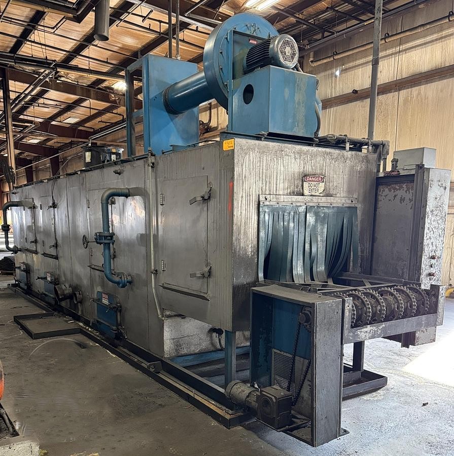

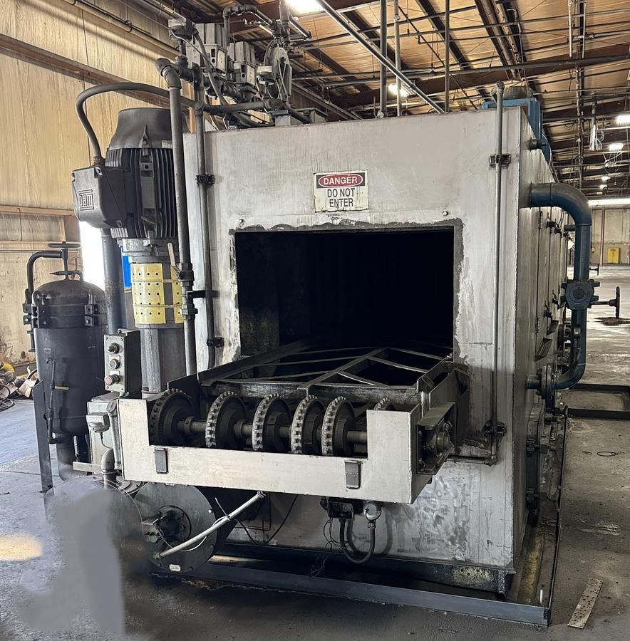

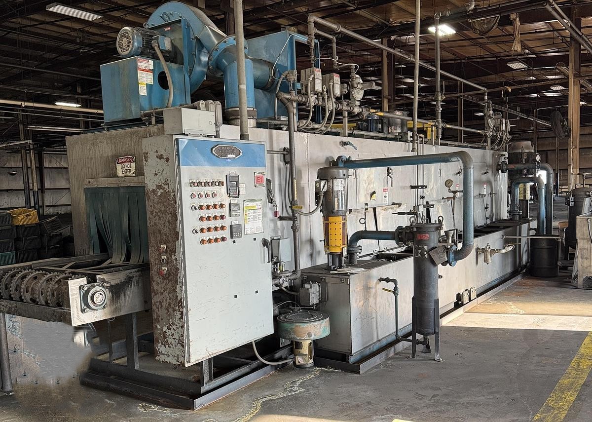

Built by Continental Equipment Company this is a 3 Stage Conveyor Washer built in 2002.
  • Serial #PWO2FB753
  • 36" X 24" high opening
  • Natural Gas Heated
  • Maximum temperature 170F wash, 160F Rinse
  • Voltage; 480/3/60/135 FLA

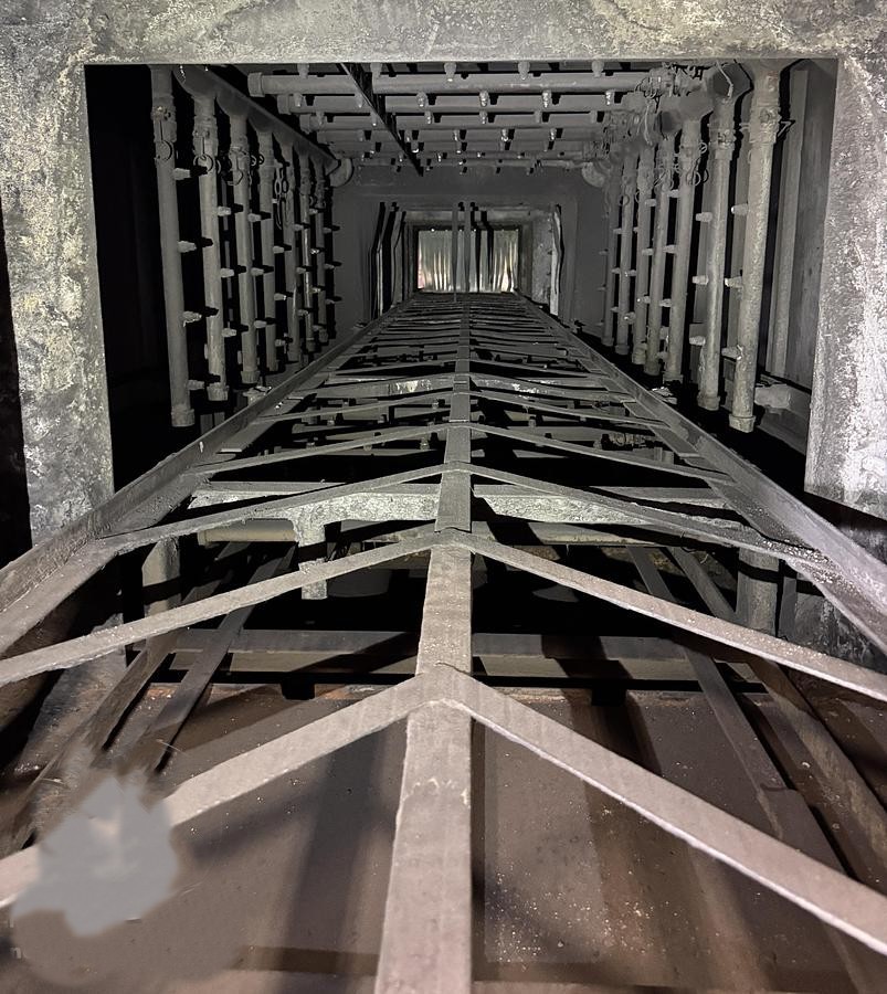

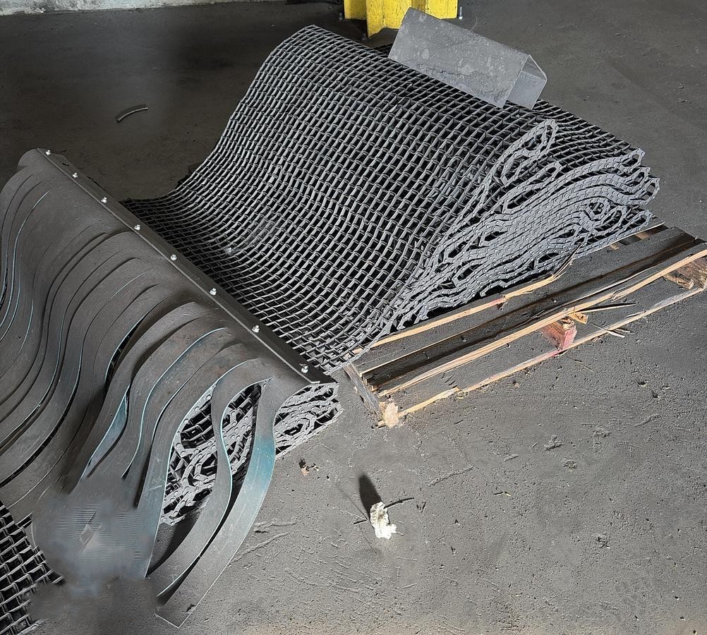

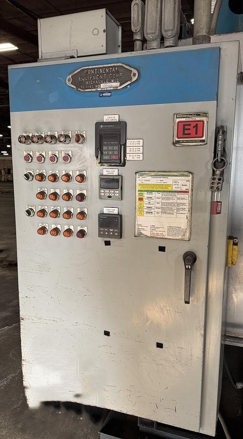

Heavy duty three (3) stage stainless steel conveyor belt washer (1" x 1" flat wire belt) with natural gas heated wash, natural gas heated rinse and ambient blow-off. Washer sequence consists of the following: 36" long load end x 48" long entrance vestibule x 96" long wash vestibule x 60" long drain x 36" rinse x 48" long drain x 48" long blow-off x 36" long unload end. This washer has a 60HP, 475 GPM wash pump and a 10 HP, 200 GPM rinse pump. Both stages have 400 micron filter systems. Heating system for the wash and rinse tanks consists of two (2) Eclipse 6" IMMERO-JET package burner systems with spark ignition, Honeywell Flame Safety w/UV scanners. Washer belt was removed for cleaning and will be shipped loosely on a skid for buyer installation. Also included is oil separator with skimmer. Controls: Mounted and wired in a NEMA style enclosure with fused disconnect includes two (2) Honeywell UDC digital temperature controllers for wash Excellent condition, Asking $99,500 USD. Available immediately.
