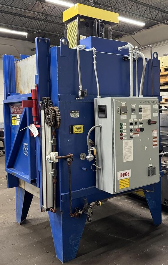

Built by Wisconsin Oven this is a model SDB-448-12E, Serial #09064A1601;
  • Working dimensions of 24" Wide X 24" High X 48" Deep
  • Electric, 36kW 480/3/60
Controls are mounted in a single door UL rated enclosure with fused disconnect attached to the right hand side of the furnace. There is a Nanodac digital temperature controller/recorder, a Honeywell UDC 120L digital process high limit controller and a Omron digital process timer which are all flush mounted to the door of the enclosure along with switches for the control power, circulating fan, heat and alarm silencer etc. Watlow EZ-Zone digital high limit mounted inside the control panel for heating element chamber. A Watlow Din-O-Mite controller for heating elements, high limit contactor, motor starter, fuses, relays etc. are mounted inside the enclosure.
Pneumatically operated vertical lift door with hand operator control valve. Stainless steel interior with punched louvered side wall and roof air duct walls. Tubular style heating elements are mounted through the top and are located behind each side wall air duct panels. Belt driven circulating fan (4600 CFM @ 7.5 HP) is mounted above the work area. Heated air is circulated across the heating elements out both side wall panels and returns through roof creating a combination horizontal / vertical air flow pattern for good uniform heating. This oven has a 9 point uniformity survey +/- 10-F @ 200-F, 650-F and 1250-F AMS 2750E, Class 2, Instrumentation Type D. Located on the rear outside wall is a 6” diameter manual fresh air and modulating fresh air/exhaust ports. Door limit switch cuts power to heating elements when the door is open. Door frame is removed for shipping. Manuals and Drawings are included with this furnace. Excellent condition. Please contact for pricing.
