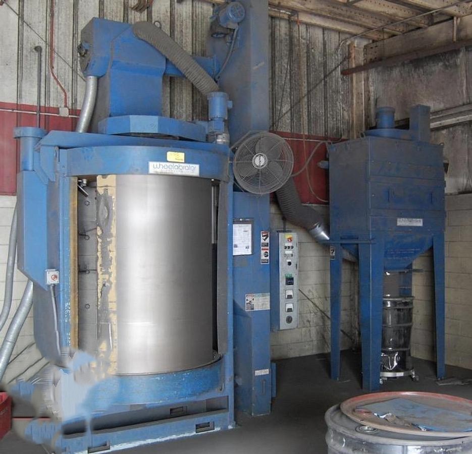

Item# SB 101 Wheelabrator SLH 2460 Spinner Hanger Shot Blast Machine
Built by "Wheelabrator" in 2010 this is a Model "Smartline SLH 2460" unit.
  • Serial Number 3555
  • Dual Voltage - Machine Currently Wired for 460V/3/60
  • External Dimensions Machine: 8' wide x 14' high x 7' long, Dust Collector: 5' wide x 11' high x 5' long
Description: Two (2) Variable Speed 7.5 H.P. Direct Drive Wheels, 24" Diameter x 48" High Chamber Capacity, 1500 pound spindle capacity (EACH), Rotary Screen Separator/Airwash. Includes Cartridge Style Dust Collector and Manual/Drawings. Controls: Mounted & Wired in an enclosure attached to the right-hand side of the machine includes all necessary pushbuttons, signal lights, fused disconnect, two (2) amp meters, blast timer, VFD's and PLC Process Description: The SmartLine 24x60 Spinner Hanger cabinet contains a structurally reinforced dual blast chamber fabricated from 1/4" steel plate. The chamber is revolved at a speed of 3rpm by an electric motor and gear reducer activating a low speed-high torque 'HTD" type drive assembly. Adjustable stops on chamber top working in conjunction with automatic electrical switching, provides variable indexing. The number of stops varies for customer application. One hook spindle is provided for each chamber. Each spindle is capable of supporting 1500 pounds and continually rotates. Excellent Condition Asking $35,000 USD.
