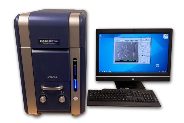

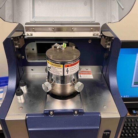

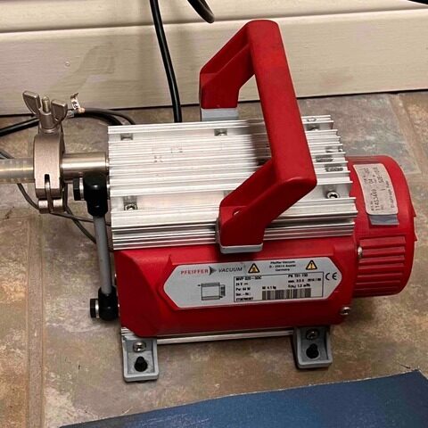

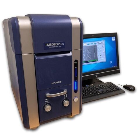

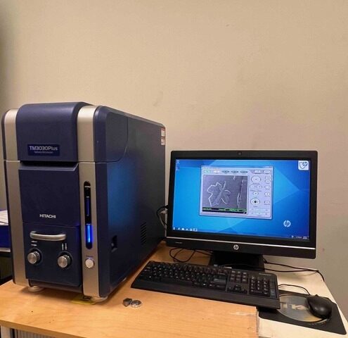

This 2014 Hitachi TM3030PLUS Tabletop SEM  is in superb condition, ready to plug-and-play in your lab with included PC and vacuum pump.  The Hitachi TM3030Plus is a compact, tabletop scanning electron microscope designed to make high-quality electron imaging accessible without the complexity of traditional floor-standing systems.

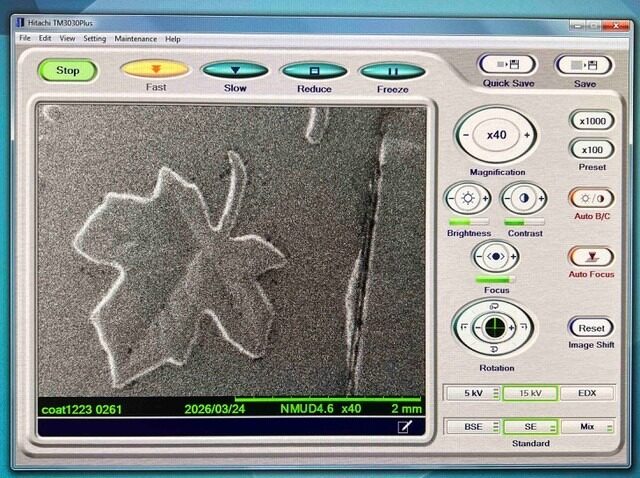

It allows easy observation and analysis — without specimen preparation — of samples including non-conductive materials and materials containing water or oil.  A key advancement over its predecessor is the incorporation of a low-vacuum secondary electron (SE) detector of the same type installed on higher-level SEM models, enabling secondary electron observations under low-vacuum conditions.
The instrument operates at acceleration voltages of 5 and 15 kV, with magnifications ranging from 15× to 60,000×. With digital zoom, this extends up to 240,000×. It supports BSE (backscattered electron), SE, and mixed imaging modes, including a charge-up reduction mode for challenging samples.
Maximum sample size is up to 70 mm in diameter and 50 mm in thickness.  Resolution reaches 25 nm, and the system saves images in JPEG, TIFF, and BMP formats.  1x100-240V/50-60Hz Universal Voltage. [INV316]
