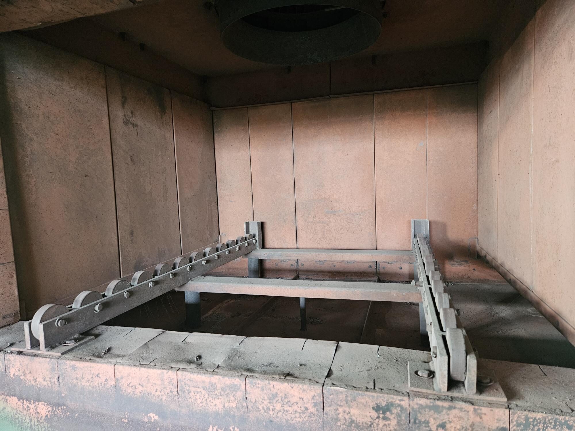

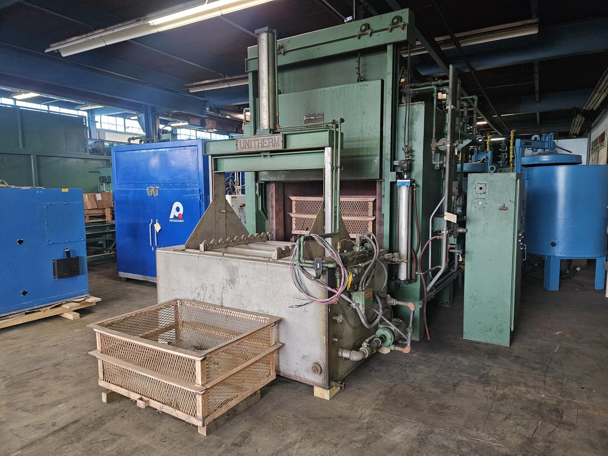

  • Built by "Unitherm" this is a Model# GRT-4, Serial# 1019-90;
  • Working Dimensions 48" Wide x 36" Deep x 24" High, 1500 Pound Load
  • Gas Fired (indirect fired), 1100F.

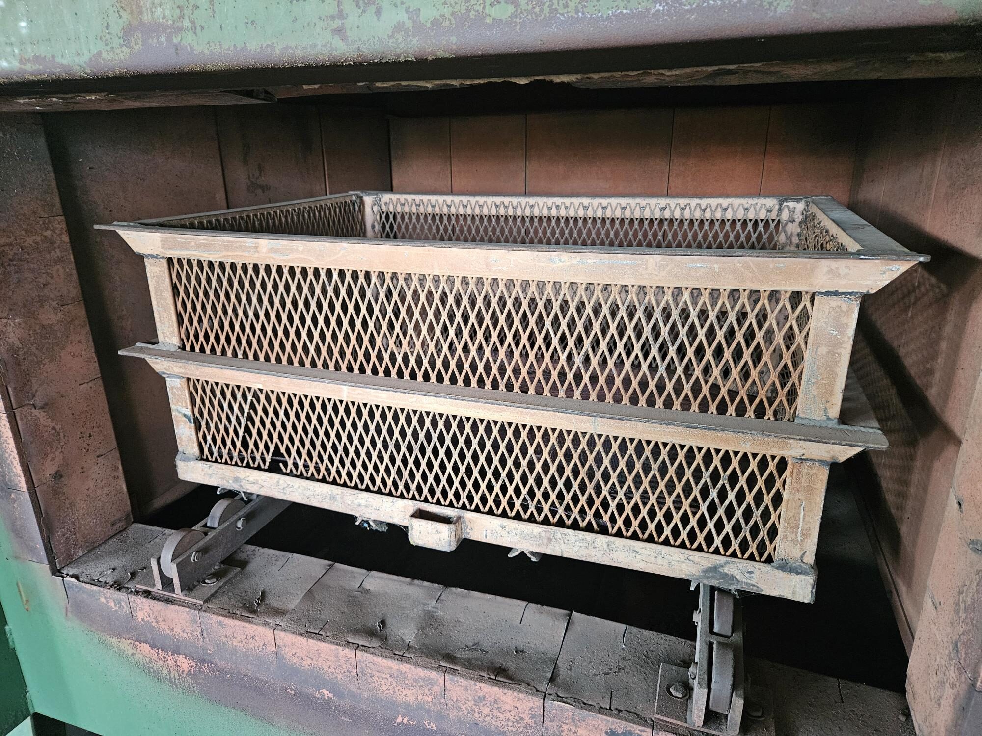

DESCRIPTION: Stainless Steel Lined Recirculating Horizontal Quench Furnace System complete with 15 H.P. Alloy Recirculating Fan, Alloy Roller Rail Hearth, (4) Eclipse Radiant Tube Firing Burners, Vertical Rising Pneumatic Front Door, (2) Alloy Work Baskets, Stationary Water Quench Tank – Heated with Pneumatic Quench Elevator, and 3 H.P. Water Pump. SS air shrouds. +-10F.
INSTRUMENTATION: Free-Standing Control Panel with Honeywell Digital Temperature Controller, Honeywell Digital High Limit, Honeywell Digital Quench Tank Controller, ATC Process Timer, and Honeywell Flame Safety System.
OVERALL DIMENSIONS: Furnace: 11' Wide x 9' Deep x 11'6" High. Quench Tank: 8' Wide x 5" Deep x 10'6" High
