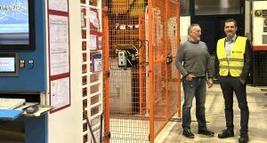

Next step? Two completely automated Ipsen “Atlas XL” sealed quench furnace lines with associated tempers, charge car and washer, with the most recent sealed quench being installed in 2024. Each of the new furnaces has working dimensions of 910mm X 1220mm X 910mm-it is worth mentioning that all of the pushers and sealed quench furnaces are serviced by 6 endothermic generators.

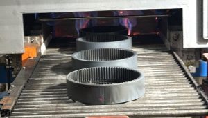

Typical Furnace Load
Control of each of the furnaces is via a probe plus “Siemens” IR system.

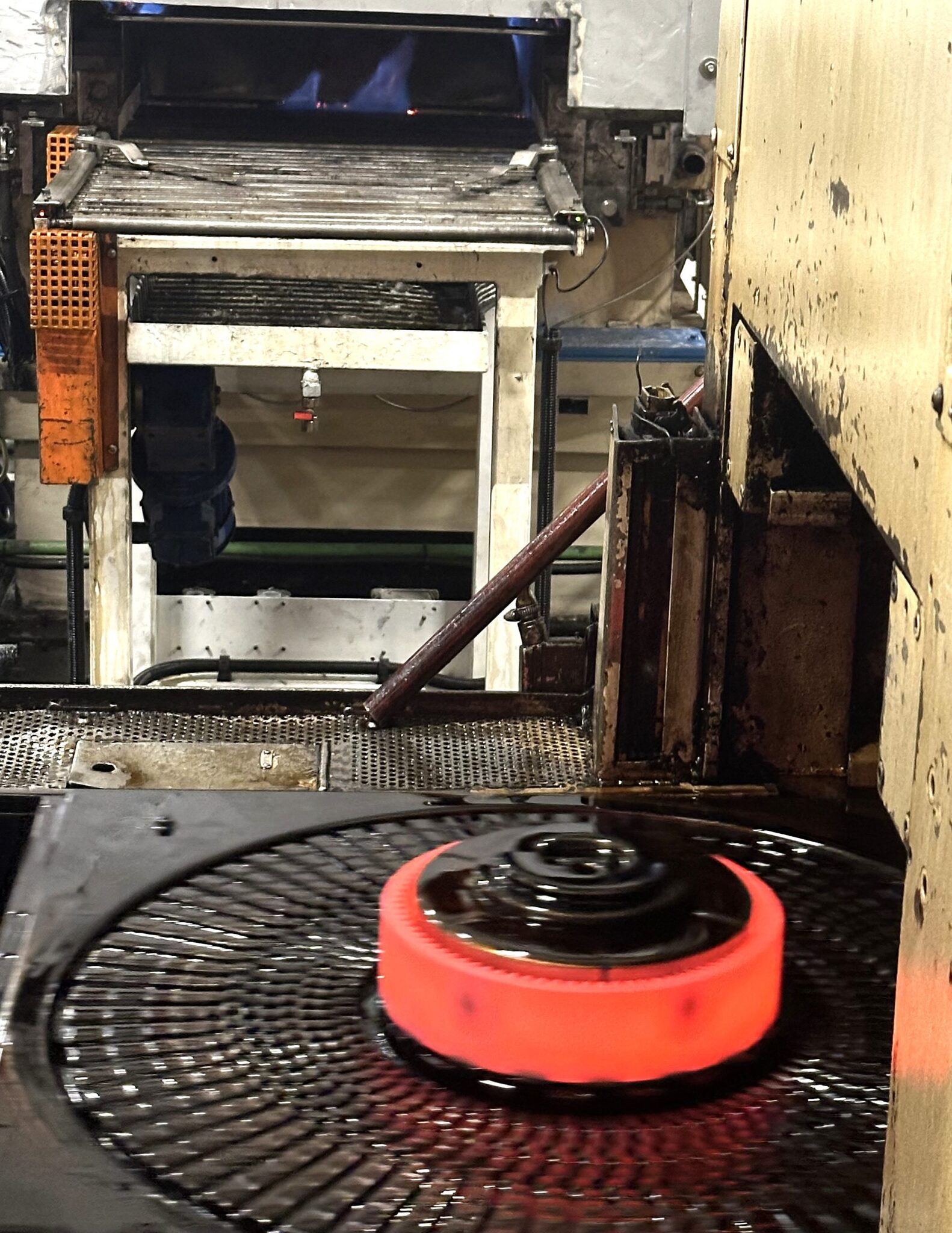

“Press Quenching”
In addition to these atmosphere furnaces the company also has a low pressure nitriding furnace and  “Gleason” press quenching lines.
