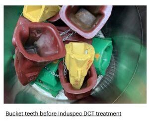

During the summer of 2021, Induspec performed deep cryogenic treatment (DCT) of several large bucket teeth. The work was performed in conjunction with a confidentialmining company and two different brands of bucket teeth were treated and ultimately tested in real mine operation. We think that real life testing is incredibly important. Thousands of academic articles are available showing the effectiveness of DCT in a lab. However, you don’t care about how things work in a lab, it needs to work on your site!
Our partner mine used the teeth on a bucket which uses five (5) bucket teeth and it is known that the off-cab side end tooth, in what we call “Position 5” is always the first to wear out. While the teeth start at a nominal length of 24”, they are changed when they have worn down to 13.5”.

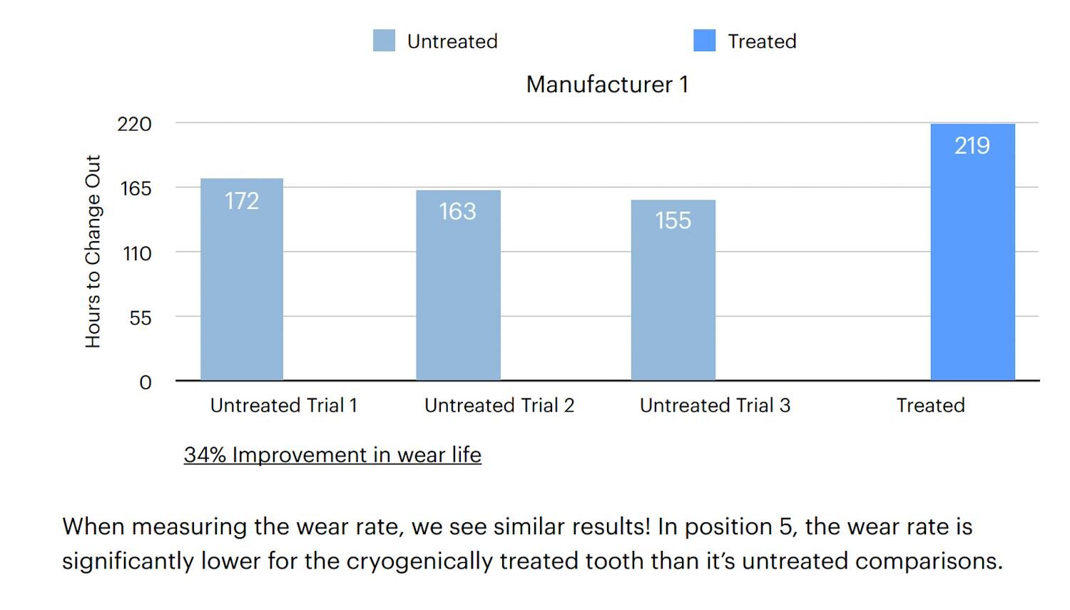

MANUFACTURER 1.  The un-treated teeth from Manufacturer 1, over the course of three tests, lasted for an average of 163 hours of operation before the tooth in position 5 was worn down to 13.5”. Of course, there was some variation due to ground conditions. In fact, there was a variability of about ± 5%. However, when a Deep Cryogenically Treated tooth was put into the #5 position, something remarkable happened. Instead of lasting for 163 hours, the tooth lasted for 219 hours. A 34% improvement!

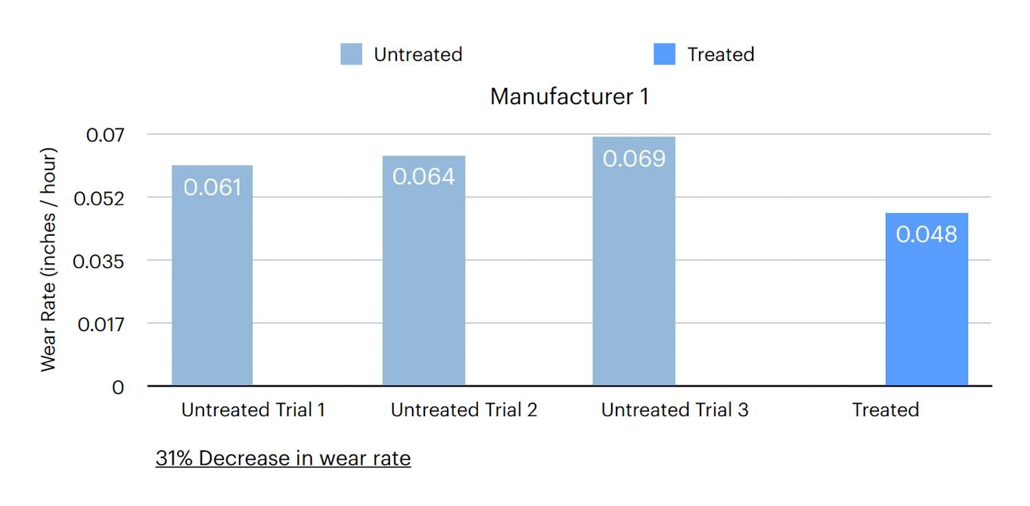

While the un-treated teeth wore at an average rate of 0.065 inches / hour, the cryogenically treated tooth wore at only 0.045 inches / hour; a 31% improvement! Similar improvements were observed in position 3 (32% improvement) and in position 4 (31% improvement).

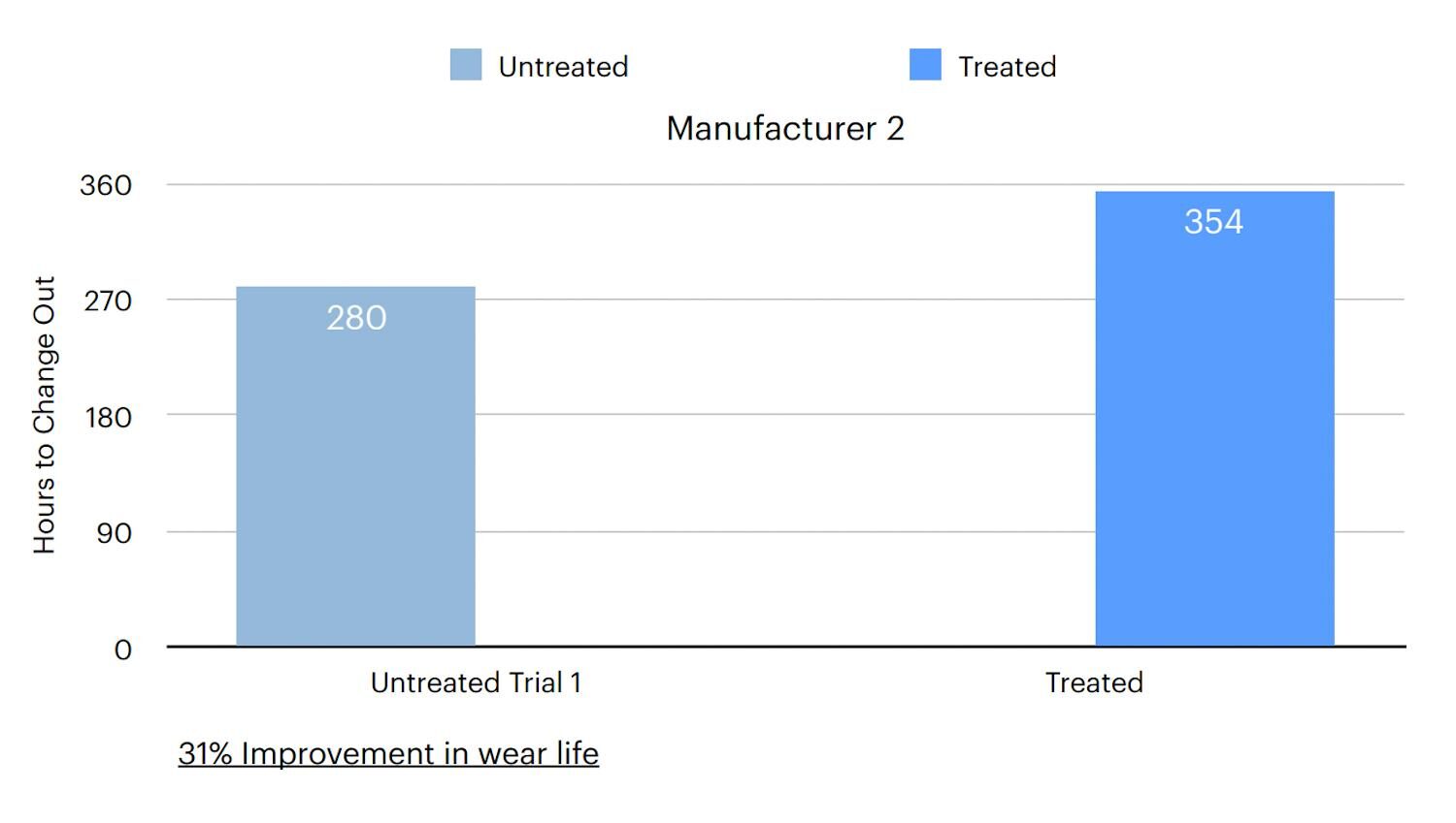

MANUFACTURER 2. For Manufacturer 2, a slightly less rigorous testing protocol was undertaken consisting of only two tests. In the first test, deep cryogenically treated teeth were set in positions 3, 4 & 5 whereas in test 2 only untreated teeth were used.
In test 1, the teeth wore down to 13.5” after 354 hours whereas the untreated teeth only lasted 280.5 hours. DCT provided a 26% improvement in the life of the teeth! Comparing wear rates, we see that the deep cryogenically treated #5 tooth wore at a rate of 0.028” / hour of operation while the untreated tooth wore at 0.036” / hour. DCT provided a 22% improvement in wear rate!
