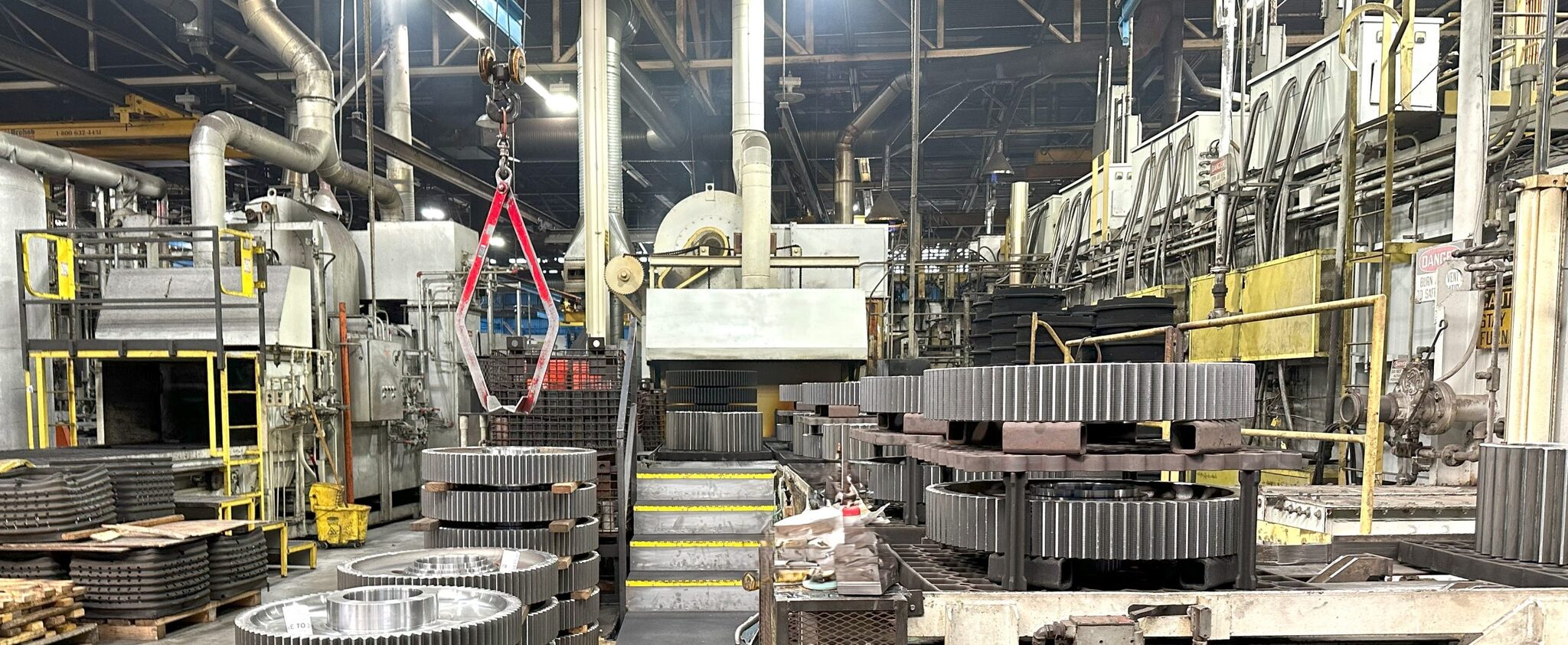

Gears Prior to Processing through a two row pusher furnace.

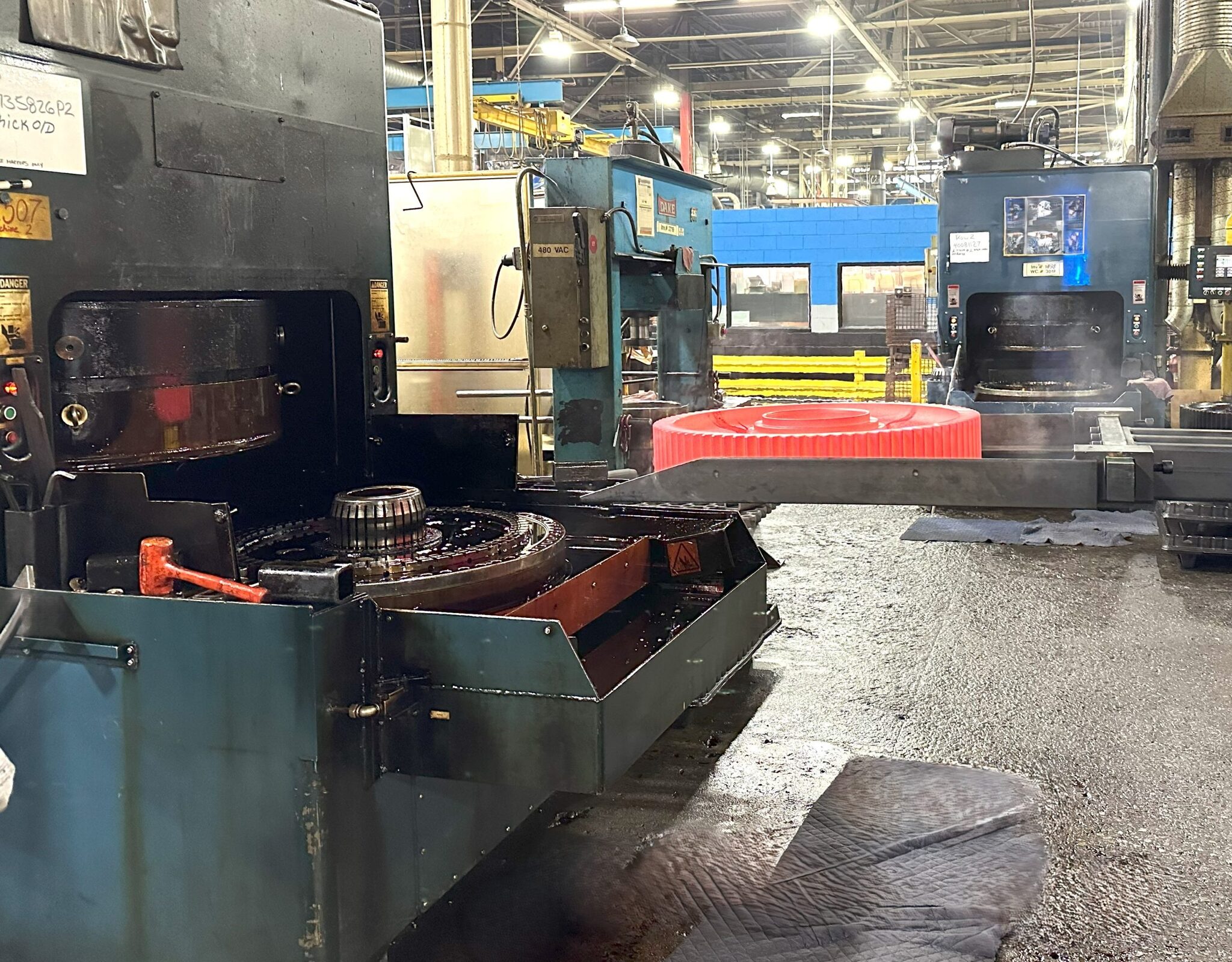

Press Quenching

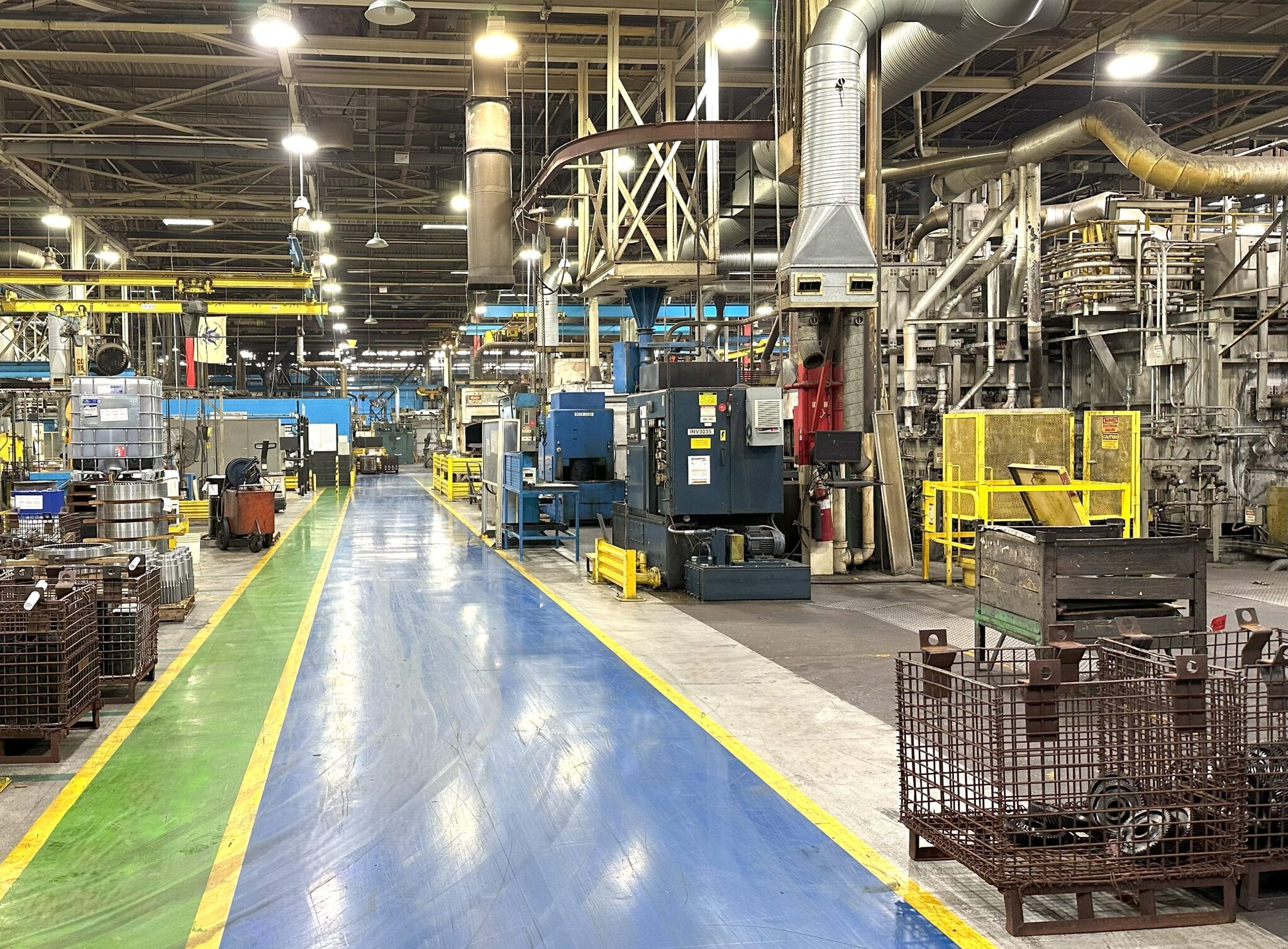

Heat Treat Department
