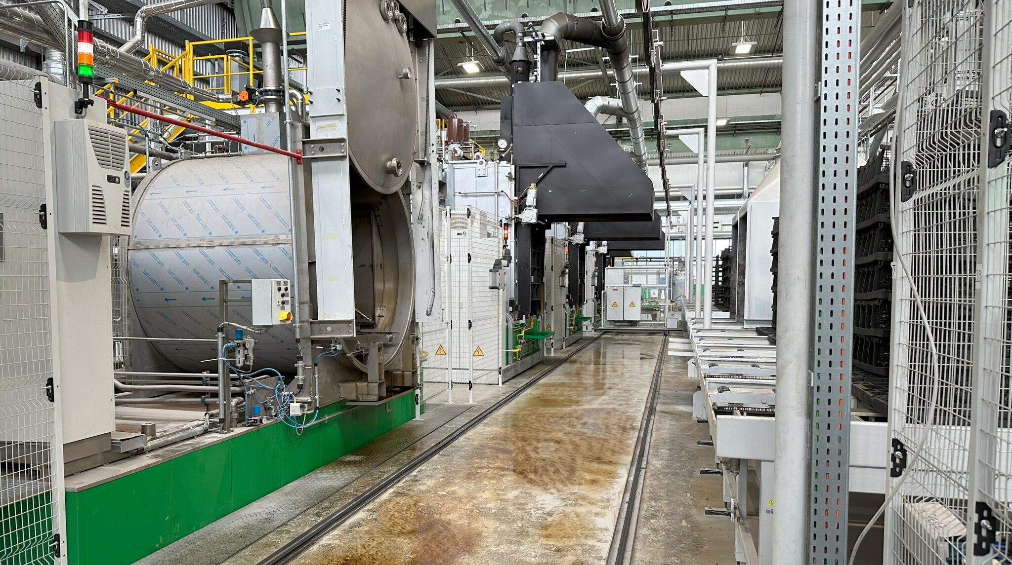

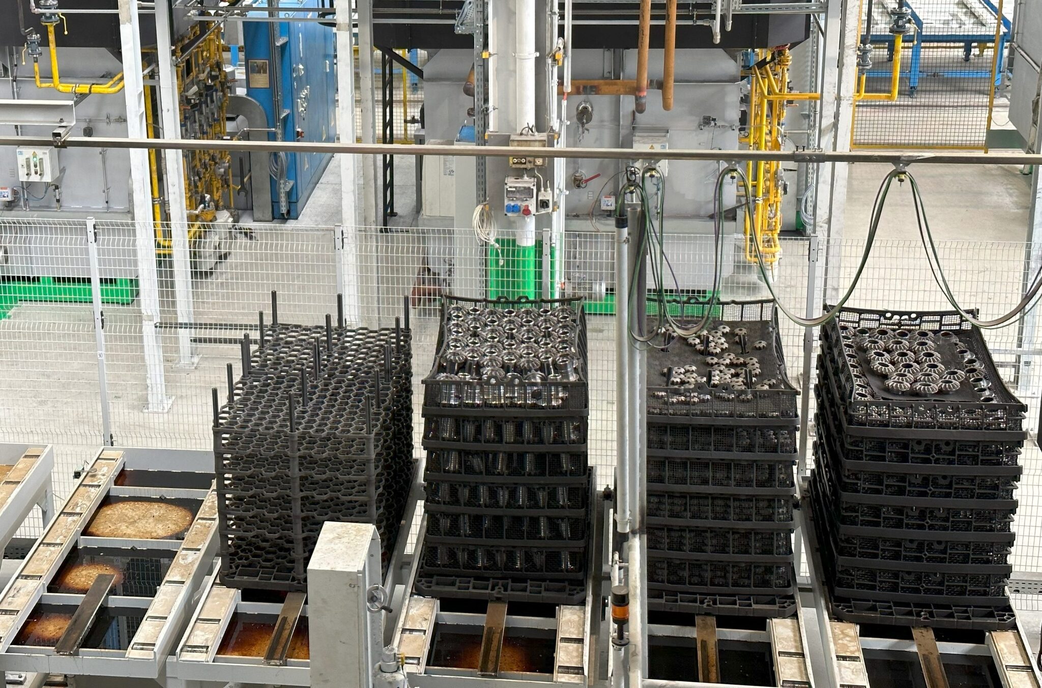

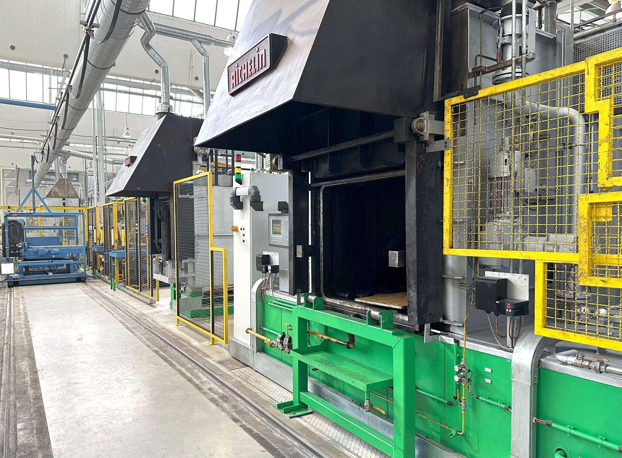

The end result is that “Hanomag” is in the final stages of setting up a “state of the art” heat treat facility in the new Winning BLW facility in Penzberg, Germany. When this location is in full production in 2024 it will have over 300 employees producing components for the heavy truck industry. Next year the company will require 6,600 tons of product per year to be heat treated and to do this Hanomag has set up a very impressive in house heat treat department which when completed will include 7 Aichelin Sealed Quench furnaces (batch IQ for our North American readers), each with a capacity of 2,000 kg, an Ipsen Sealed quench furnace with similar dimensions, an Ipsen rotary hearth furnace, ancillary equipment and annealing capacity which is yet to come.
The heat treat department will be staffed by roughly 25 individuals all of whom will be Hanomag employees. Currently the furnaces are just entering production with full production expected in 2024. The Aichelin sealed quench line is completely automated and can be considered a “lights out operation”. All furnaces are gas fired with atmosphere provided by 3 endothermic generators, atmosphere is controlled by oxygen probes with portable 3 gas analyzers and regular shim stock checks providing backup.
