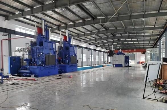

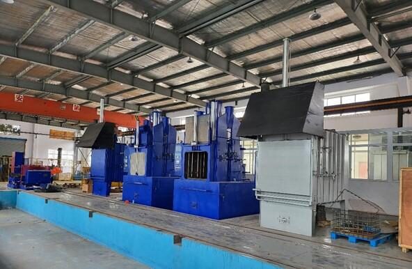

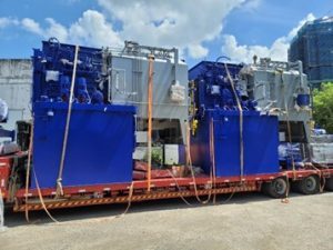

“Gord, for the past couple of years I have been working with Pingsheng Heat Treatment Co. Ltd., in Jiashan, China a growing commercial heat treater. Recently we installed a sealed quench (batch IQ) furnace line which includes 6 electrically heated hardening furnaces with oil quenching, nitrogen/methanol atmospheres, working dimensions of 910mm x 1220mm x 910mm (36″ x 48″ X 36″) and a weight capacity of 1500kg (3500 pounds), The furnaces are capable of a number of processed including carburizing and nitrocarburizing. A Siemens PLC controls the equipment which included tempers and washers. These photos show the installation prior to start up. We are very pleased with the way the installation was handled as it ended up being on time and on budget.”
