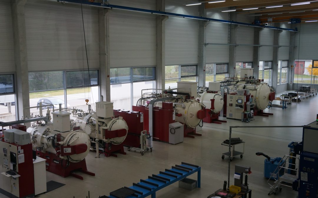

We ran across a rather interesting captive heat treat operation in the US Midwest last week which is worth mentioning. A manufacturer of a strip product for cutting applications required that the product be annealed in a vacuum furnace. Consequently the company invested in a total of 14 vacuum annealing furnaces, all of which were installed in the late 1990’s. Earlier this year the manufacturer went with a different type of raw material which does not require annealing with the end result that this company now has 14 top load vacuum furnaces installed, ready to run but completely surplus to their ongoing requirements. It makes for a rather interesting sight to see this number of vacuum furnaces sitting idle in a cold, dark, shuttered heat treat department. If you have a requirement for vacuum annealers let us know and we will put you in touch.

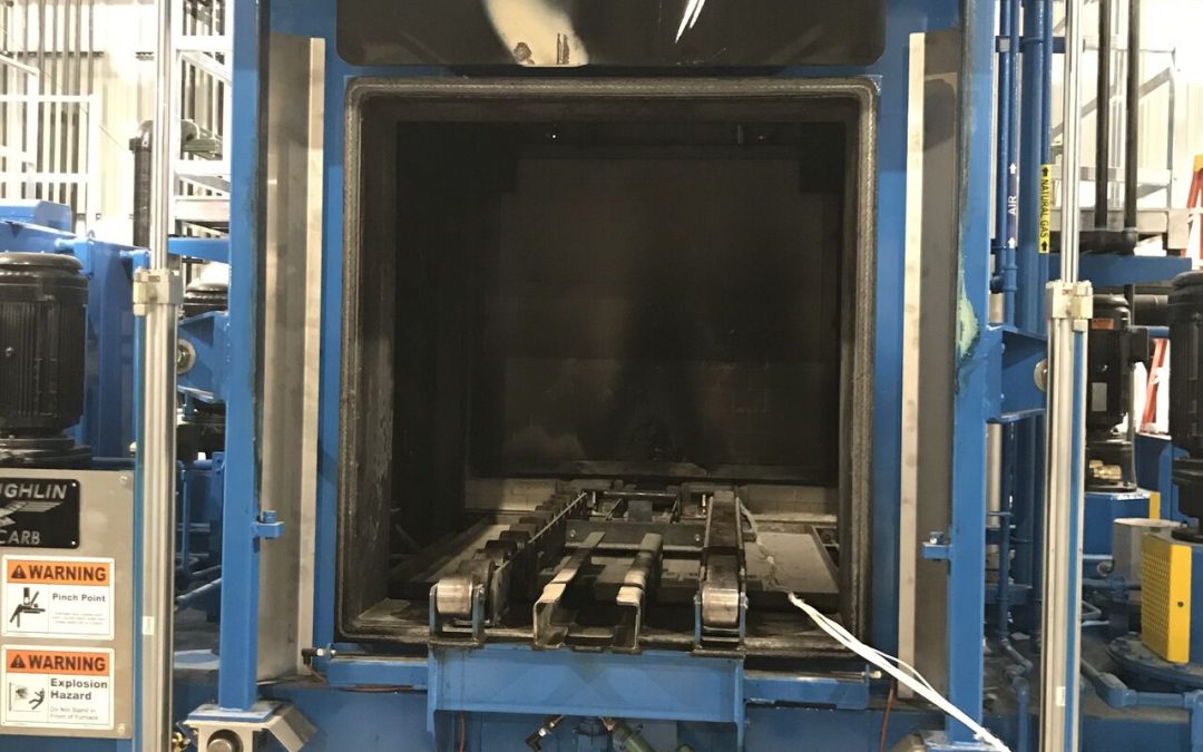

Wandering around Wisconsin last week we had to stop and visit the Bodycote (commercial heat treating) plant in New Berlin, Wisconsin which for a couple of reasons is a rather unusual Bodycote facility. Size wise it is fairly average but it offers two processes which are not a standard for Bodycote; press quenching and salt bath nitriding. Press quenching is never common in commercial shops mainly because it is such a specialized process involving a substantial investment in tooling which can generally only be used for one particular product. Having said that this location (which has all Gleason press quench units) actually has more Gleason units than Gleason has in their commercial/captive heat treating plant in Rochester, NY. The other process which this plant offers which is unique to Bodycote in North America is their salt bath nitriding department (FNC). This is a booming business for this plant helped by the fact that their only competitor in the area recently got out of the business and sold the equipment off. These photos give you a good idea about what you would see if you visit this location. And the people? Top notch fellows that we met.
