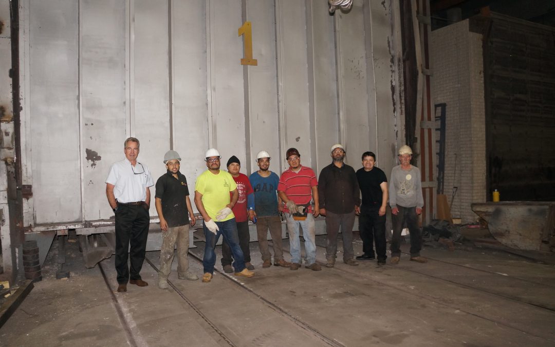

Back in February of this year we told you the story of auto parts supplier SISTEMAS AUTOMOTRICES DE Mexico installing a brand new pusher furnace line. Well the story is almost finished as the line is now ready for final acceptance and run off as you can see in the one photo below. To really complete the tale you can see the furnace arriving, being unloaded, installed and now pretty well complete.
SISTEMAS AUTOMOTRICES DE Mexico Installs Pusher Line ​ While pusher lines are not a popular as they once were they certainly still have their place as we can see here. Transmission components manufacturer SISTEMAS AUTOMOTRICES has just completed the installation of a brand new 3 row pusher at their facility in Northern Mexico. The line was provided by AFC-Holcroft and MATTSA (their licensee in Mexico) in record time which  emphasizes the great partnership of both companies in the furnace business in the USMCA region. The first photo from SISTEMA shows the holding chamber and quench tank arriving, and the other two photos show the furnace being unloaded and subsequently installed.

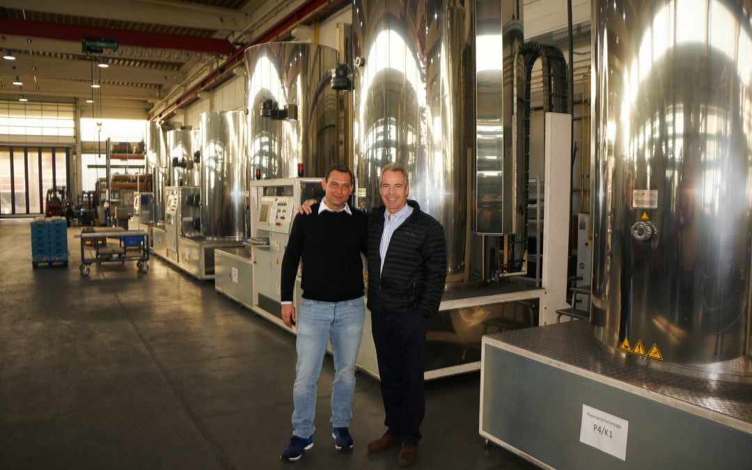

From Italy Nitrex has send us this press release about a new installation; “Family-owned heat treatment company GalvanoTechnik, situated in Lombardy, Italy, has expanded its surface treatment services portfolio to include NitregR controlled nitriding, NitregR-C nitrocarburizing as well as ONCR in-process oxidation treatments. Nitrex System Combines 3 Technologies into 1 Platform; The company invested in a compact Nitrex system, model NXK-609, configured to process 23.5″ diameter by 35.5″ high (600mm by 900mm) workloads that weigh up to 1300 lbs (600 kg). The system complies with the temperature uniformity requirements of AMS 2750E, in addition to meeting specifications ASM 2759/10, which make it possible to consistently achieve the required metallurgical and mechanical properties for controlled nitriding. Other advantages of the NXK series include a reduced footprint and a system configuration that combines three process technologies into one platform.”
