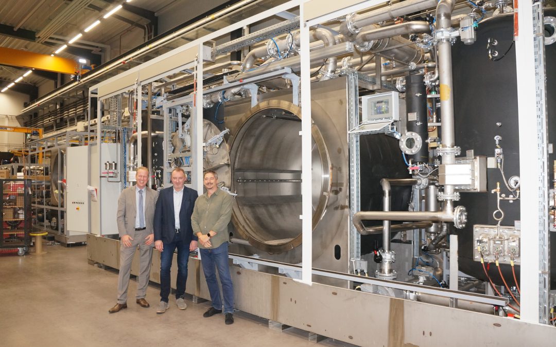

Another high vacuum furnace with stainless steel furnace housing for brazing. This furnace will be equipped with a molybdenum hot zone and turbo- molecular vacuum pumps. Installation will be in a clean room and the ultimate vacuum is in the range of 10-7 mbar/ torr. Left to right; Oliver Obladen, Michael Simon, Dr. Bora Özkan

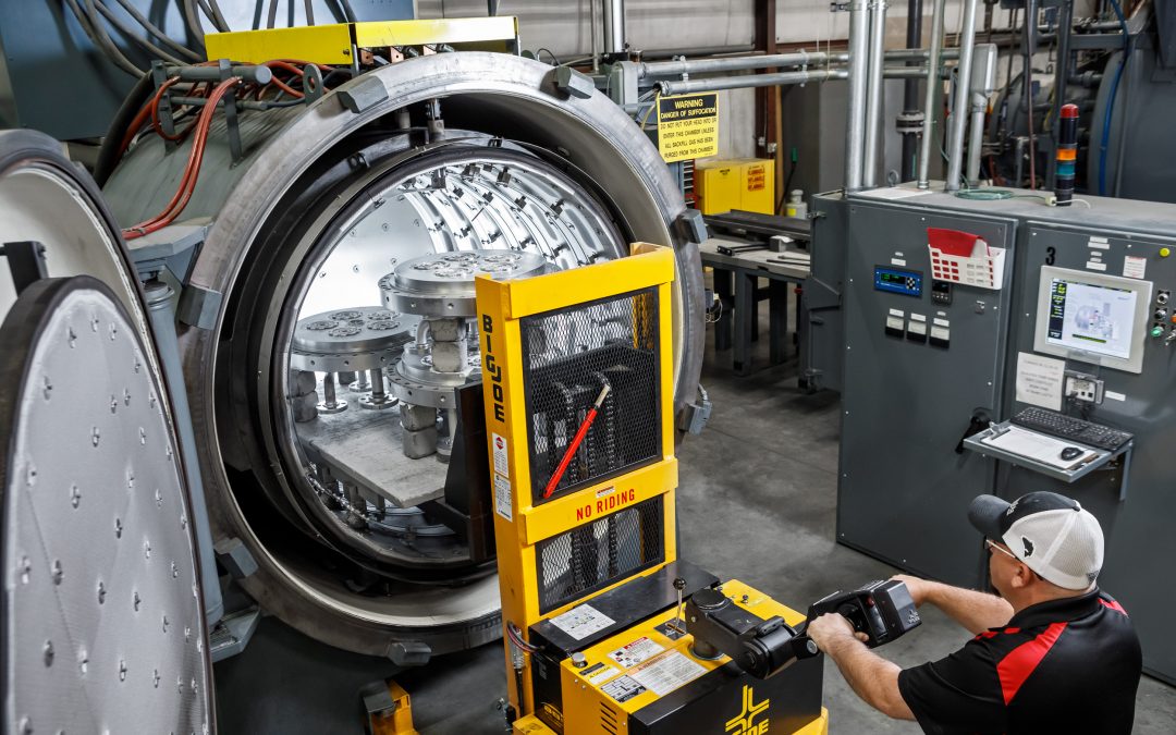

And to round things out commercial heat treater Hauck in Eindhoven, Netherlands recently expanded their facility by 1,000 square meters and added the vacuum furnace you see in the attached photo. We have rated Hauck as the second largest commercial heat treater in Europe as you can see here https://themonty.com/largest-

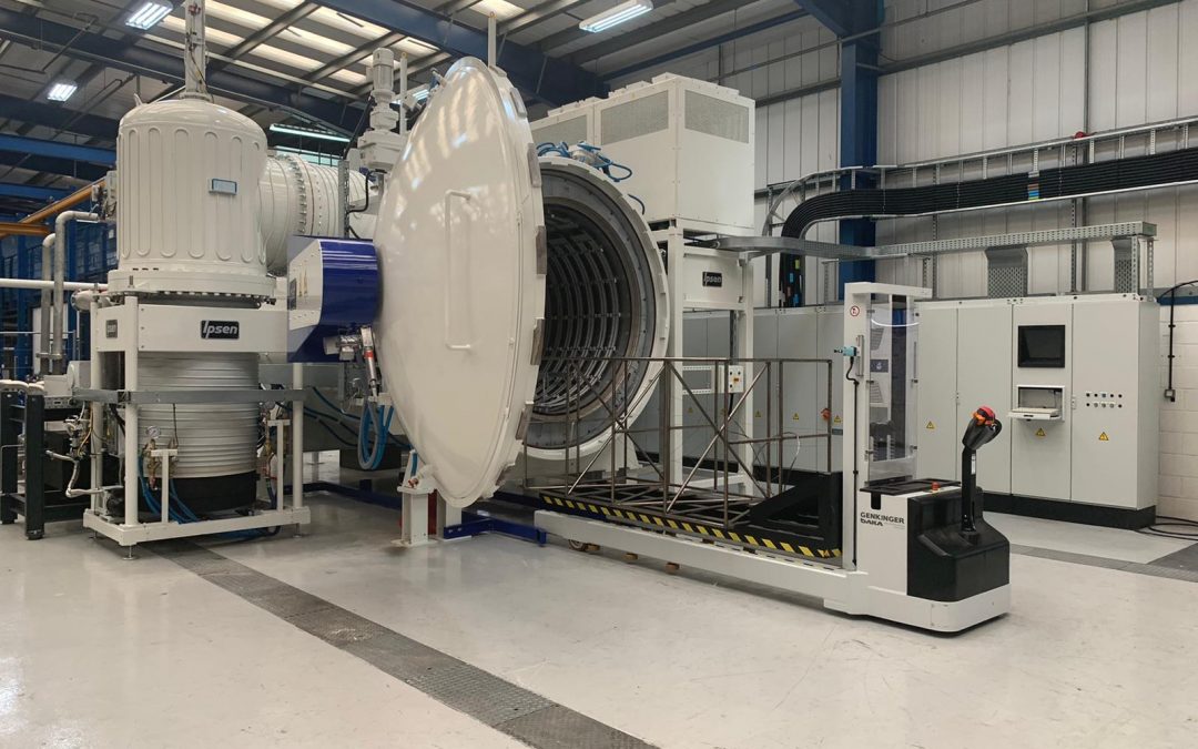

The “Titan” line of vacuum furnaces which were introduced by Ipsen a number of years back have proven to be quite a success story with well over 300 built and sold-this success translates into a high resale value. For instance this unit; Model 5100-TITAN, s/n 5100-B013-B3 4039, built in 2013 came on the market 2 weeks ago and was offered by a used equipment dealer in Iowa, USA. There was no asking price, rather this took the form of an auction and it took exactly 2 weeks to sell. While we don’t know the final sale price we do know that there were a number of offers made and our understanding was that the final sale price was quite respectable.
